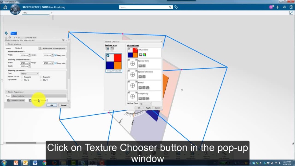

How to create a sticker
To create a sticker you need the Live Rendering application.
Click on "Create Sticker", then associate the sticker with the 3D part concerned, then place it as you want with the "3D Manipulator". Then click on "Texture Chooser" in the pop-up window.
You can now drag your image into the "texture" part. Then drag and drop your image from the "texture" space to the "Channel" space.
Now change the size of your image with the 3DManipulator, if you need, you can remove the option guard ratio.
