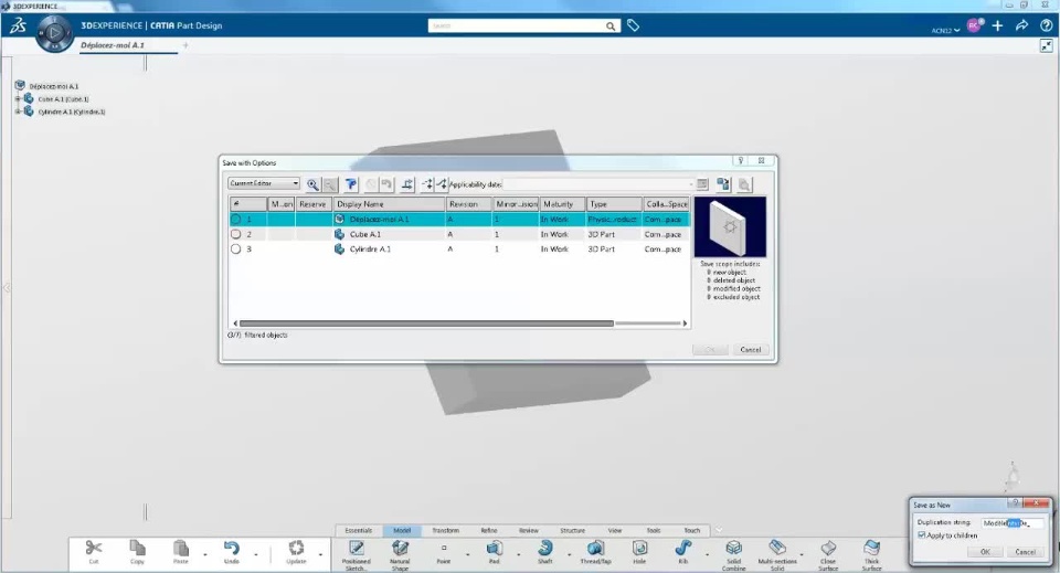

We can check the Collaborative Space of an element in its properties (right click on the element). In our case, our element is in the Collaborative Space called Common Space, we can see it in the top right corner. Go to the good Collaborative Space (here ACN12) as a Leader by clicking on the current Collaborative Space.
To save your element, go to "Save" then "save with options" Select the oldest parent and click on the icon at the top right of the window, a new window will appear. In this one, activate "Apply to children", you can also modify the chain of duplication, it will appear at the beginning of the name of your element in the good Collaborative Space. The 3DExperience will automatically open the copy in the good Collaborative Space.
