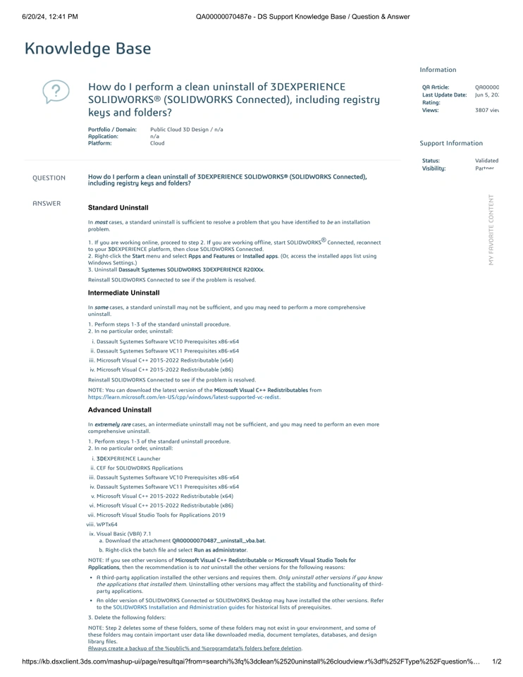

#5. "License not granted: XWB (License Error 20)" or "SOLIDWORKS Manager is not installed. Reinstall SOLIDWORKS or install SOLIDWORKS Login Manager".

🔴  #5. "License not granted: XWB (License Error 20)" or "SOLIDWORKS Manager is not installed. Reinstall SOLIDWORKS or install SOLIDWORKS Login Manager".
1. Close Solidworks and uninstall SOLIDWORKS Login Manager.
2. Restart windows to ensure a clean system state.
3. Reinstall SOLIDWORKS Login Manager. Navigate to "C:\\Program Files\\Dassault Systemes\\SOLIDWORKS 3DEXPERIENCE R2026x\\win_b64\\resources\\MSI\\SWLoginMgr"
4. Run 'setup.exe'.
5. Launch SOLIDWORKS Design (inspired by solution by Sohan Dhake).

🔴  #17. "An incomplete installation has been found in this directory..."
This error is typically caused by residual files from a previous failed installation or update. Delete the folder 'C:\\Program Files\\Dassault Systemes\\SOLIDWORKS 3DEXPERIENCE R2026x\\InstallData\\Incomplete' and retry the update? If the issue persists, please try below:
1. Right-click the Start menu and select Apps and Features or Installed apps.
2. Uninstall Dassault Systemes SOLIDWORKS 3DEXPERIENCE R2026x.
3. Restart your PC to ensure a clean system state.
4. Delete folder C:\\Program Files\\Dassault Systemes\\SOLIDWORKS 3DEXPERIENCE R2026x
5. Install from the welcome tab (https://solidworks.com/makers-cloud). (Solution by Kairan ZHANG)
