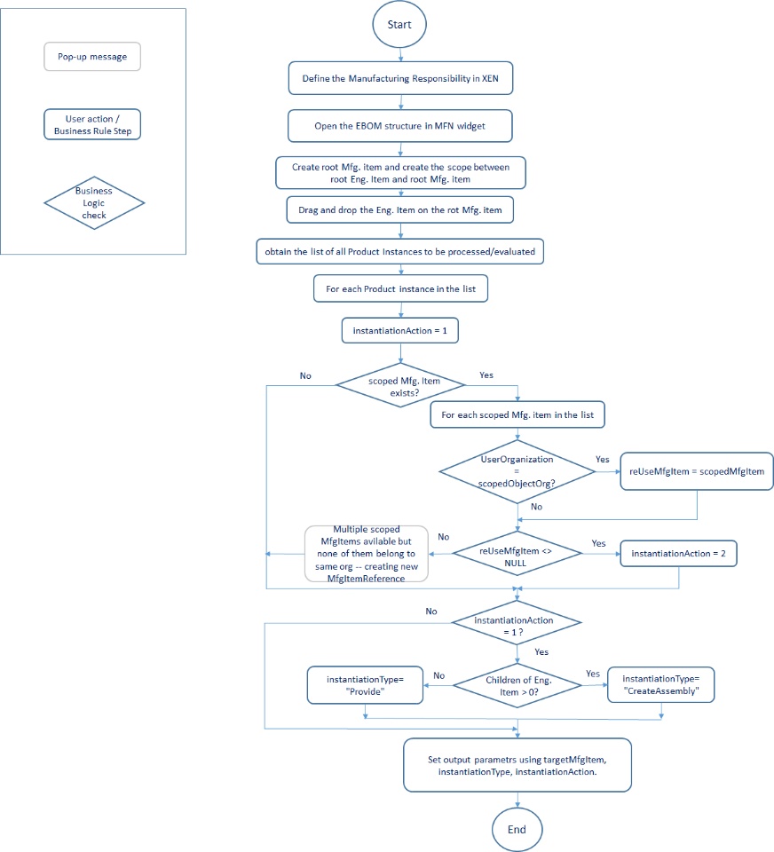

Logical Flow
Example Business Rule

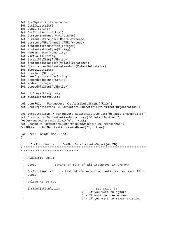

MfgItemInstantiationActionBL_PlantSpecificMBOM_PLMEntity.CATRule
Detail Description:
First of all we check if we have any existing scoped items for the Eng. Item.
If the scoped Mfg. item exists then we can check its organization. If the organization of scoped Mfg. item matches with the current organization then it is reused in the MBOM structure (instantiationAction =2).
If we have multiple scoped Mfg. items available in database but none of them matches the current organization then we create a new Mfg. item reference (instantiationAction = 1).
Logic to find the scoped Mfg. item matching the current organization
if(ScopeList.Size() <> 0)
      index = 1
      for index while index <= ScopeList.Size()
           set scopedMfgItem = ScopeList.GetItem(index)
           set scopedObjectOrg = scopedMfgItem->GetAttributeString("organization")
           if UserOrganization == scopedObjectOrg // Orgs match, so reuse the scoped item
                set reUseMfgItem = scopedMfgItem
           index = index + 1
      if(reUseMfgItem<> NULL)
            set instantiationAction = 2                    // We are in REUSE mode !
      else
            Trace (1, "Multiple scoped MfgItems avilable but none of them belong to same org --
            creating new MfgItemReference")
If no scope links exists, create a new Mfg. Assembly (if the current product has children) or Provided Part (if current product has no children).
Logic to create new Mfg. item
if( instantiationAction == 1 )  // Create new Mfg Item Reference
            if ( oFilteredList.Size() > 0 )
                    set instantiationType= "DELAsmAssemblyModelDisciplines/CreateAssembly"
                    set virtualID = "EKLVirtual" + currentReference.PLM_ExternalID
            else if ( oFilteredList.Size() == 0 )
                    set instantiationType= "DELAsmAssemblyModelDisciplines/Provide"
We can decide the type of Mfg. item to be created depending on the particular requirement.
InstantiationAction:
1 - Create new Mfg. item
2 - Reuse existing Mfg. item

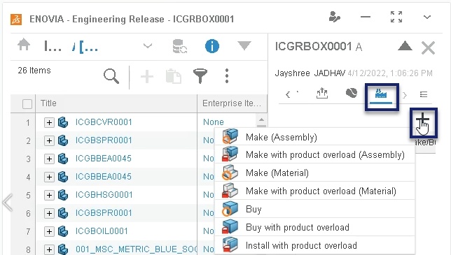

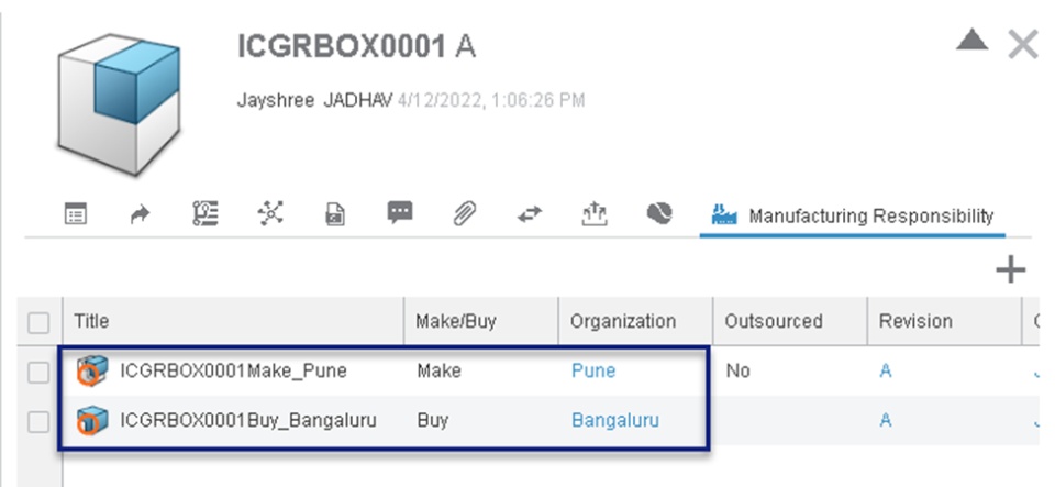

Setting Manufacturing Responsibility
Let’s define ‘Manufacturing Responsibility’ for Eng. Item ‘ICGRBOX0001’ using Engineering Release widget.
Select the information ​​​​​​​ icon from top right corner in Engineering Release widget.
Select  tab from properties of the Eng. Item and click on  icon to define manufacturing make or buy.​​​​​​​
Select the organization ‘Pune’ to define Make (Manufacturing Assembly) as shown in below image
Select the organization ‘Bengaluru’ to define Buy (Provided Part) as shown in below image.

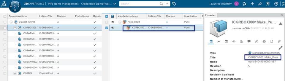

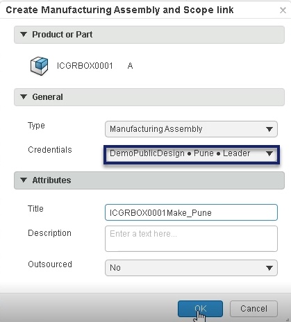

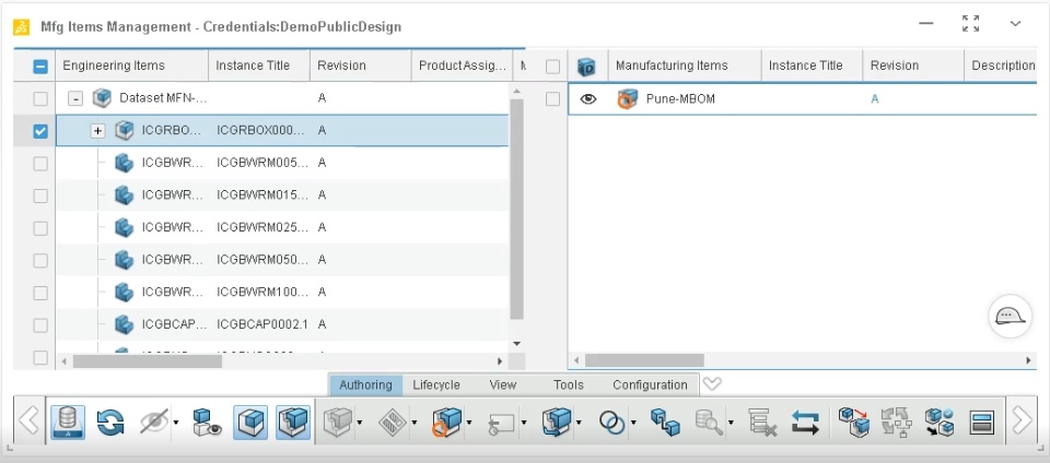

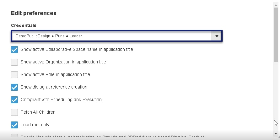

Working in ‘Pune’ organization
Now let’s edit the preferences for MFN app and select the organization as Pune.
Create a root Mfg. item in MFN and create a scope with the root Eng. Item
Dragging and dropping the Eng. Item ‘ICGRBOX0001’ will create a Mfg. item which will be a reuse of Mfg. Assembly created in XEN.

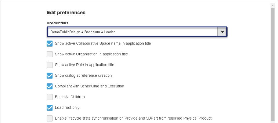

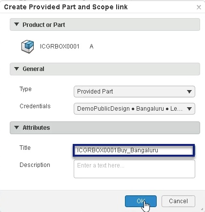

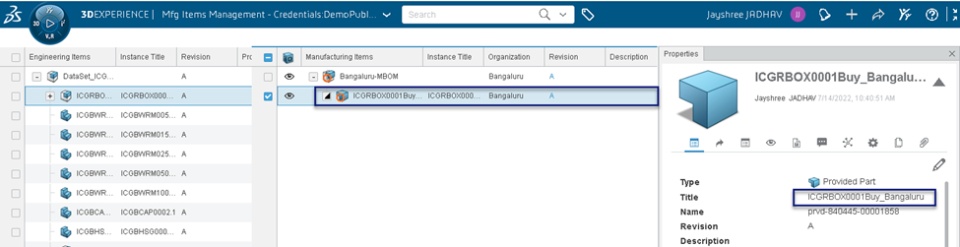

Working in ‘Bangaluru organization
Now let’s edit the preferences for MFN app to switch to ‘Bangaluru’ organization.
Let's create a root Mfg. assembly in Bangaluru organization (Bangaluru_MBOM) and scope it with root Eng. item.
Now if we try dragging and dropping the Eng. Item ‘ICGRBOX0001’ on root Mfg. item, it will create a Mfg. item which will be a reuse of Provided Part created in XEN.

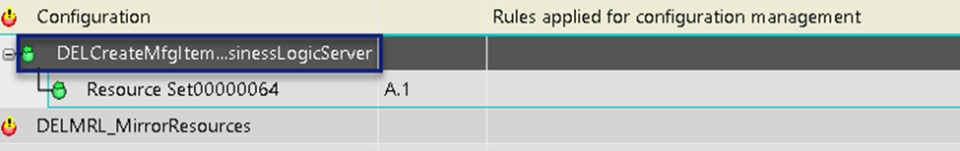

Business Rule Deployment

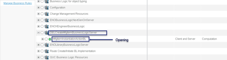

On Premise:
The below page can be referred for Business Rule deployment using Data Model Customization app (TXO).
Business Rule Deployment using Data Model Customization App

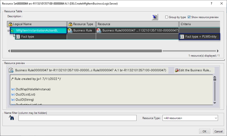

Resource Set and opening:
On Cloud:
The below page can be referred for Business Rule deployment using Data Setup app.
Business Rule Deployment using Data Setup App
Resource Set:
Opening:
