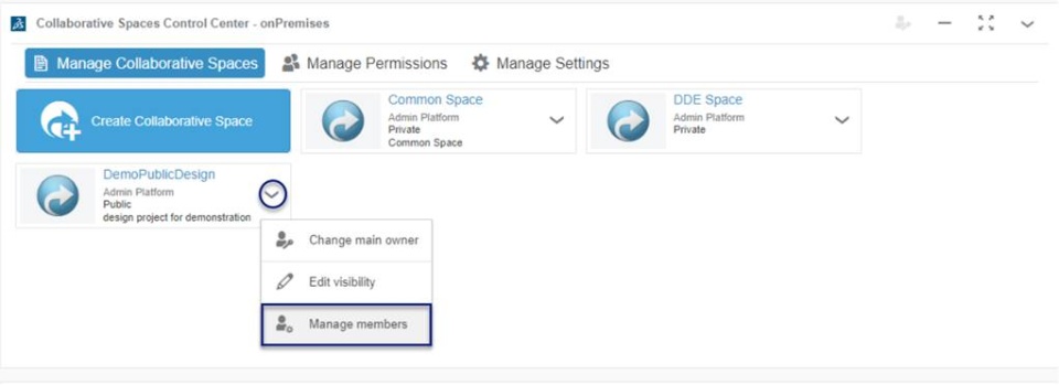

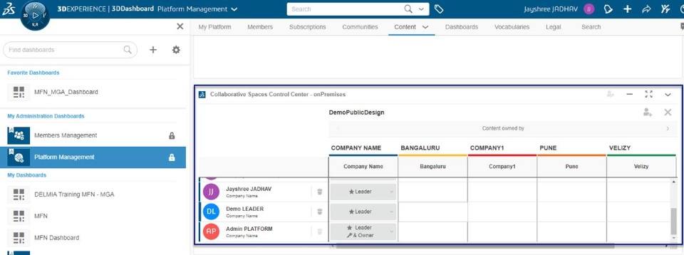

Using Content tab in Platform Management dashboard it is possible to assign or manage  a “Plant” as an Organization for a collaborative space and assigned user.
When an access of a particular organization and collaborative space is provided to a user, he/she can create a plant specific MBOM structure.
Please refer below screenshot for access management of organization.
