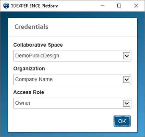

  1. Login to 3DExperience as Admin or other user with Owner role.

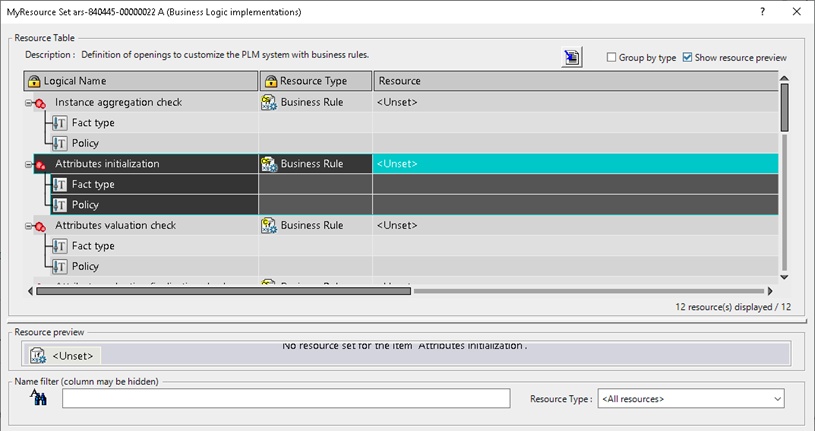

  4. Edit the created/ existing Resource Table.
  5. ​​​​​The Resource Table is created with a list of available Opening ID’s as shown in the following image.

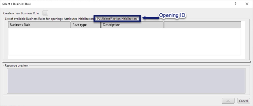

  1. After creating a Resource Set, the next step is to create the business rules. Double click on Resource column to select a Business Rule.  Before creating a new Business Rule it's important to check the 'Opening ID' as shown in below image.

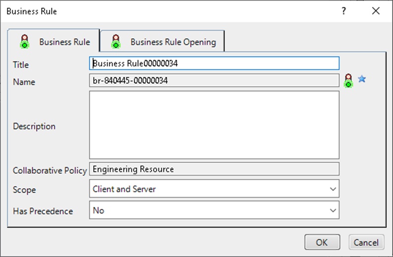

  2. To create a new Business Rule select the 'Create a new Business Rule' option
  3. User can set the Title, Description of the Business Rules, Scope of the Business Rules and the Precedence over other business rules. Click OK, the Business Rules Development Editor opens.

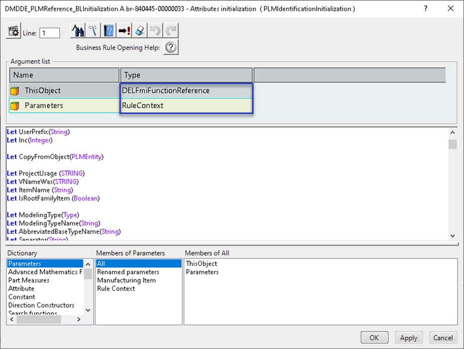

  4. Select appropriate ThisObject and Parameter values, write the Business Logic in the Editor and press OK button.
  • ThisObject: It is the input object type to which the rule is applied, also called the Fact type.
  • Parameters: Provides contextual information and contains information on the context in which the rule operates

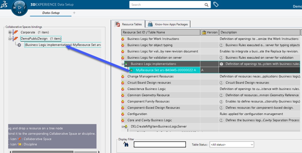

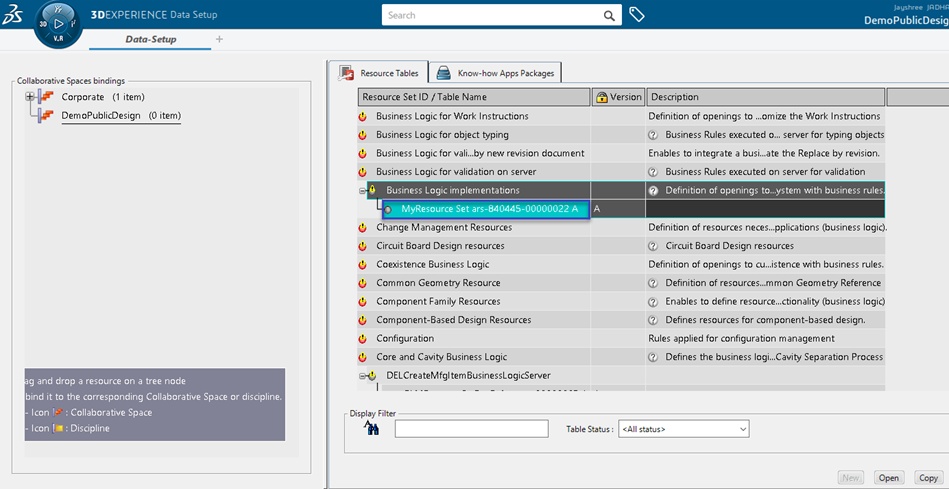

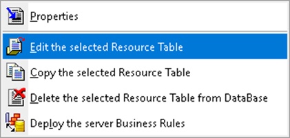

  1. Save the Resource Set.
  2. Drag and drop the Resource Table to the appropriate collaborative space.

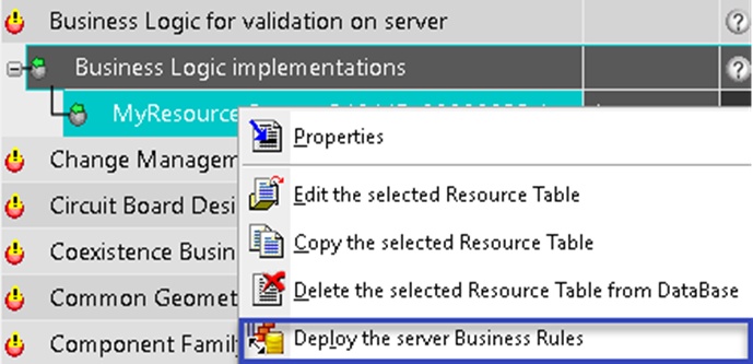

  3. For server side business rules, right-click on the Resource Table you have associated with the collaborative space and select Deploy the server Business Rules option, the business rules is deployed. This must be done after each business rules/resource set modification.​​​​​​​
