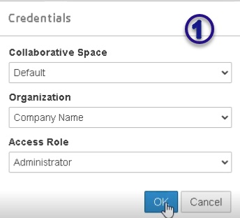

  1. Login to 3DSpace using ‘Default’ collaborative space and ‘Administrator’ role. Please use your own user with Administrator role.​​​​​​​

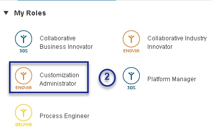

  2. Select ‘Customization Administrator’ role.​​​​​​​

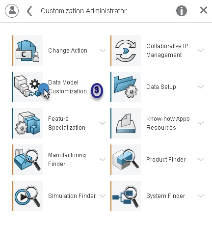

  3.  Launch ‘Data Model Customization’ app.​​​​​​​

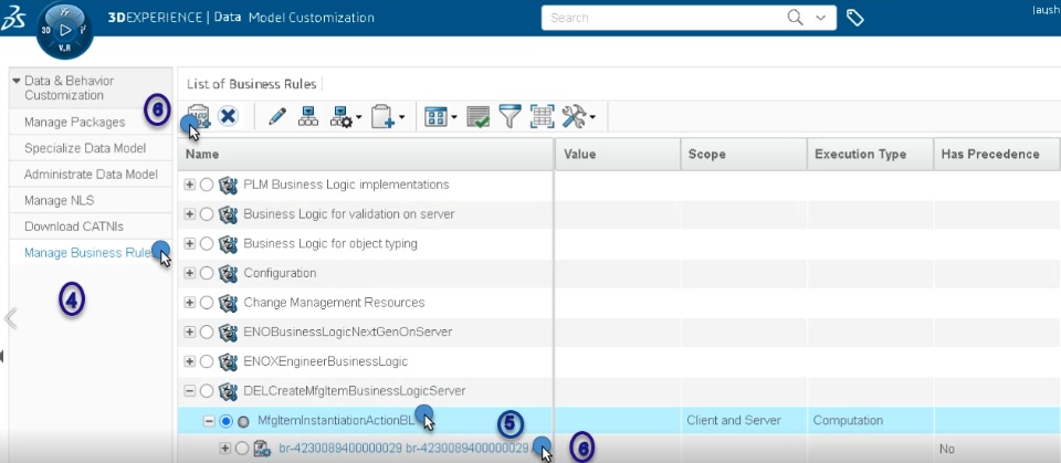

  4. Select Manage Business Rules option.
  5. Among list of business rules expand  ‘DELCreateMfgItemBusinessLogicServer’ and select    ‘MfgItemInstantiationActionBL’ opening id.
  6. Create a business rule inside it.​​​​​​​

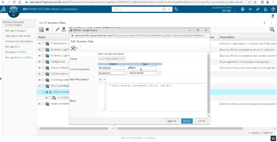

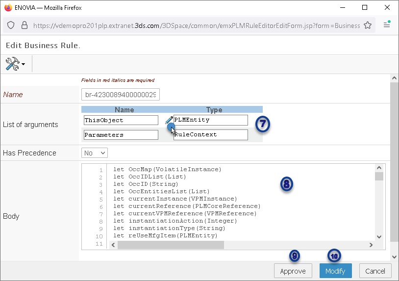

  7. Click on the business rule created to edit and copy-paste the business logic there.
  8. Please do not forget to select arguments.
  9. Click approve button to check for syntax errors.
  10. Click modify button to apply and save the business rule.
