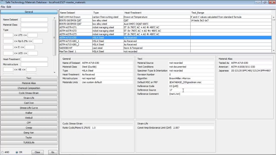

In fe-safe the ease of opening the external material database for fe-safe analyses was greatly improved. In addition to a link on the windows start menu under programs >> fe-safe.2016, you also have a button on the Material Databases window in the fe-safe GUI. See how to search the external database and export materials for use in fe-safe.
Narrated video
Below is a narrated video that explains how to access the external materials database, search for a material, and export them for opening in fe-safe:
