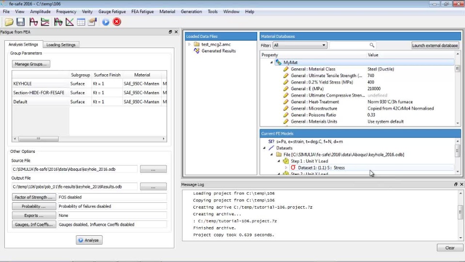

In fe-safe the ease of storing projects for archiving or later analysis has been improved. Now a project export function allows fe-safe to create an archive (*.project.7z) file containing all of the necessary files to repeat the analysis including if needed the results and the source file.
Narrated video
Below is a narrated video that explains how to export a project to an archive and then restore (Import) the project in a new directory:
