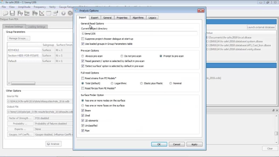

In fe-safe the method of selecting a project directory for fe-safe was changed, and the options to switch between projects during a GUI session. When starting fe-safe, the last 5 project directories are listed for easy selection and you can also select directories with the browse button or paste a path into the field shown. Once inside fe-safe, all settings that are generated are saved in a directory structure in the project directory, including the directory used last to open FEA models in fe-safe. The project directory includes FEA model data and the selected frames and variables from the FEA solutions, the loading definition for the fatigue cycle, the material assignments and algorithm selections among others.

Below is a narrated video that explains how to create a new project and switch projects in fe-safe:
