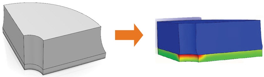

This series of tutorials will teach you how to set up a simulation in ExSight. We will be considering an example of a rubber mount to demonstrate the various features of ExSight and V6.
Problem statement
A rubber mount is bonded at both ends to steel plates. It will experience axial loads up to 5.5 kN distributed uniformly across the plates. Find the axial stiffness of the mount. We will be considering 1/8 of the original model for the tutorials.
