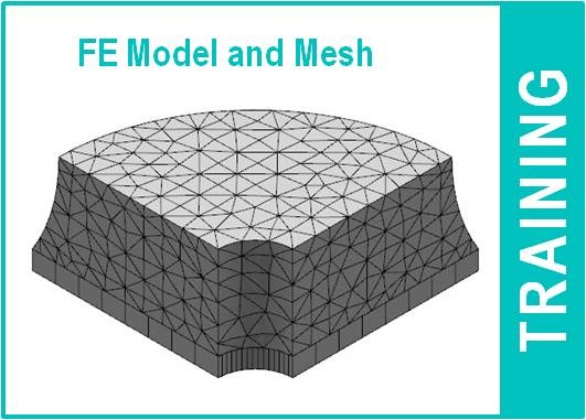

The rubber mount assembly has two components - a 1/8th model of the rubber mount and a 1/8th model of the steel plate. The rubber mount is meshed with tetrahedral elements and the steel plate is meshed with hexahedral elements.

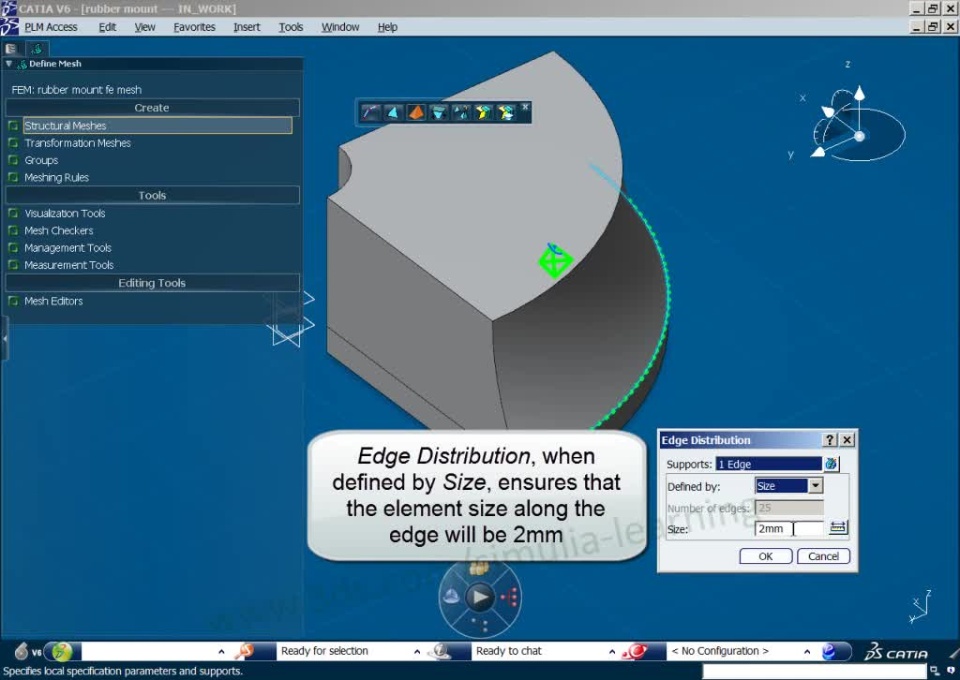

Below is an annotated video that shows how to create a FE Model in V6 and mesh the assembly using tools available in the Advanced Meshing workbench.
