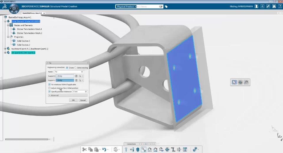

Scenario 1 Description
The assembly consists of two parts - a backboard and a hoop. The hoop and the backboard are tied together. A pressure load is applied to a small section of the ring which causes it to deflect.
At the end of this tutorial, you will be able to:
1. Create a FEM Representation and mesh the parts.
2. Create and assign materials.
3. Create Tie connections.
4. Define and execute a simple static scenario.
