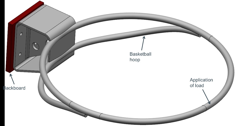

The problem is to simulate a scenario where a basketball player performs a dunk and then grabs and releases the hoop/ring on the way down.
The model consists of two parts - a backboard and a basketball rim. One end of the backboard is in contact with the rim and the other end is fixed. A pressure load is applied to a small section of the rim, thereby causing it to deflect.
Two workflows are discussed in this tutorial:
1. To tie the backboard and the hoop together and then apply a load to a small section of the ring thereby causing a deflection (Scenario 1).
2. To introduce virtual bolts to connect the backboard and the hoop together, define contact between the surfaces of the backboard and the hoop and then apply a load to a small section of the ring thereby causing a deflection (Scenario 2).
The two above scenarios will try to simulate a part of the actual problem statement - a scenario where the player hangs from the hoop after the dunk. Since both the above discussed scenarios are static events, they will be run as static analyses.
