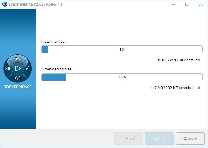

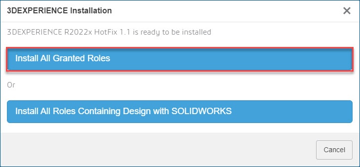

5. Click on Install All Granted Roles.
Design with SOLIDWORKS installation file set will be downloaded via the 3DEXPERIENCE Launcher, and the installation should proceed automatically.
Note : If you haven't installed Java Development kit 21 (JDK 21) previously you will be prompted to install them now
Click on the provided link and Install the JDK 21
6. Follow the setup instructions
7. Message: Installation Success
Note : Only the roles available to you will be downloaded and Installed.
