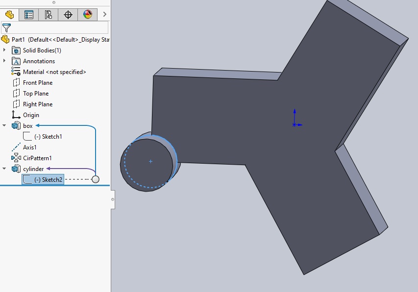

We draw box, than make circular pattern of it.
And then we draw a cylinder. We think that we reference original box, but we make a dependency on the circular pattern feature.
Now we want to add new cylinder to the pattern.
But we can't move it up.
How to see in which way a sketch depends on a feature?
And redraw cylinder while pattern is suppressed.
Thank you for any suggestions and links.
