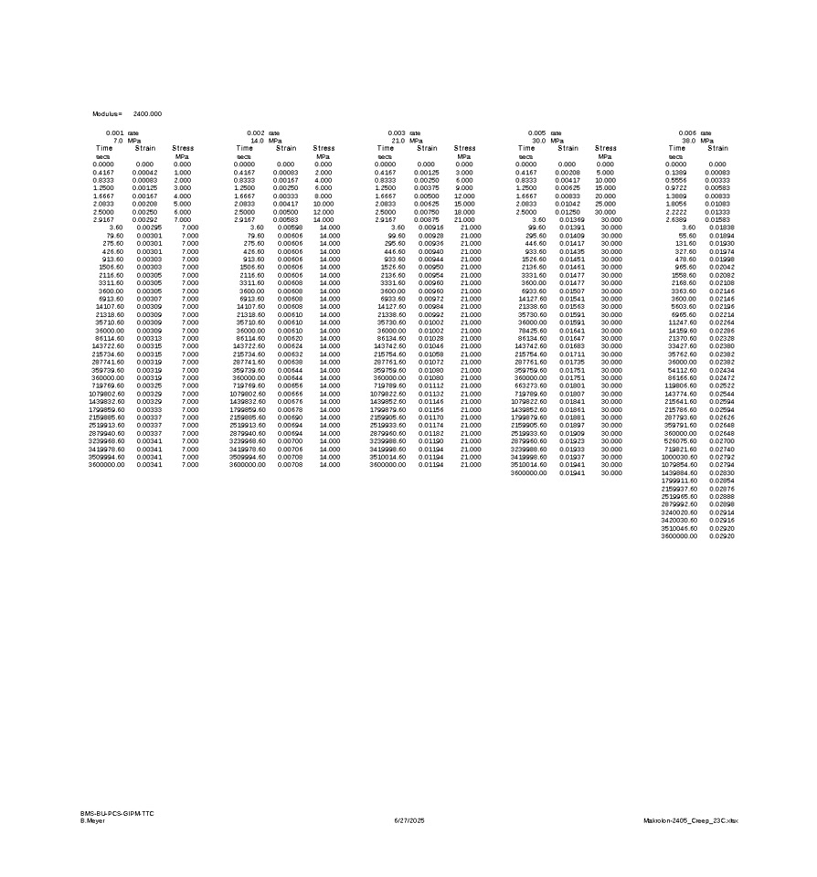

The test data is creep data at 5 different stress levels.

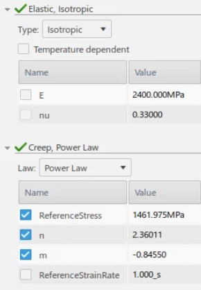

The target material model is "Elastic-Creep".

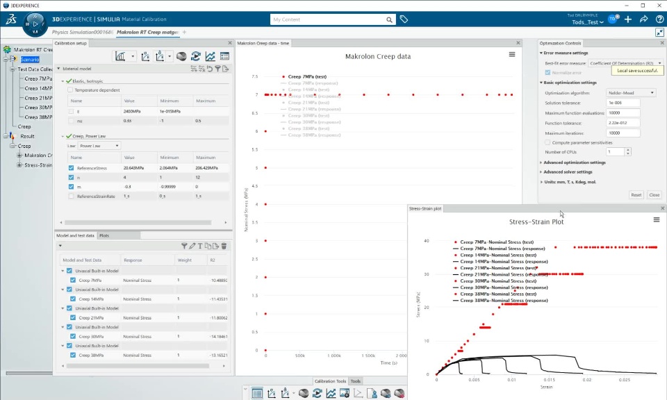

This calibration can be performed using the standard numerical mode (no FE model), but the app always assumes that is a known and the unknown is stress. In a creep test, the known is the history and strain is the unknown. The video below shows the use of the standard numerical mode.  This video was created in Dec, 2021 using the public cloud.
Result of the numerical mode calibration:

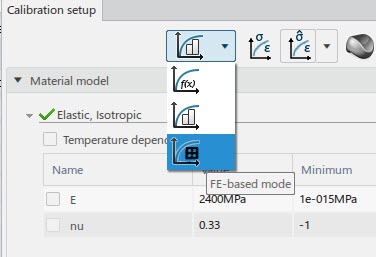

For the FE-based calibration, switch to FE-based mode before importing any test data.

1) Switch to FE-based mode of calibration.

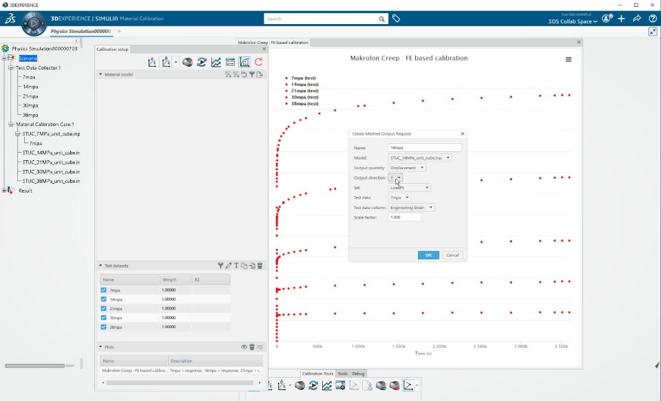

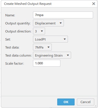

4) Map the particular FE output to be compared to a particular test data set.

In this example, the FE unit-cube models output U3 and TF3, but because of the unit-cube, these quantities are the same as nominal strain and nominal stress. All of the FE model output is for the single-node nset named "LoadPt".  We map like this:
Video of FE-based calibration.  This worked ok when I made the video below.  Later in time (R2022x) a bug crept into things.  IR-905364   "For a particular analysis using a *VISCO procedure, Abaqus/Standard omits to provide output at user specified time points".  This was fixed in a later release of R2022x and all versions going forward.

Test Data in Excel:
The 5 FE unit-cube input files in a singe zip file:
