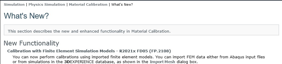

One of the major new features delivered with R2021x FD05 is the ability to calibrate a material model based on the response of a FE mesh/model. This is going to be needed for calibration of damage and failure models. Another example where this is needed is for any experiment in which the state of stress/strain is non-homogeneous, such as in indentation testing,
FE-based Material Model Calibration

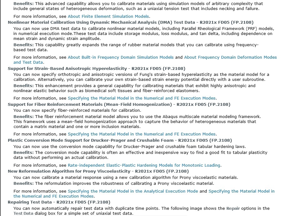

A full new features listing from the docs:
