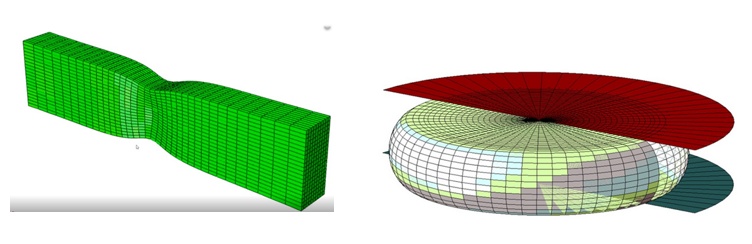

This post explains a bit about using the FE-based calibration and contains several examples. FE models are required for calibration of damage and failure models. Another example where they are required is for any experiment in which the state of stress/strain is non-homogeneous, such as in indentation testing,  There are also times where the FE-based calibration can be used with a simple unit-cube (1 element) mesh to overcome a limitation in the analytical or numerical modes.

3DX FE mesh/model calibration of the rubber puck   (uses 1 Abaqus model)
Video created using R2021x FD05.  This is a good example to try first, because the FE model is axisymetric and quite small, the FE model runs in just a few seconds, so it keeps the calibration time low.
Necking of a titanium dogbone specimen    (uses 1 Abaqus model)

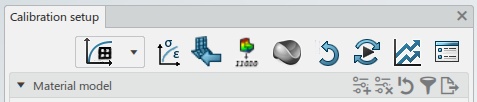

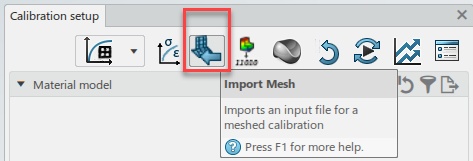

General Process:  The general idea is that the user supplies a 'run-ready' Abaqus model that replicates the test physics.  This model can be created in the 3DX platform, or imported as an Abaqus input file (.inp).
Working from left to right in the icons above:

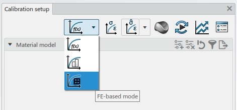

1) Switch to FE-based mode.  Once you do this you will notice that the icons change a bit.
2)  Import test data.  In this 1st release we have focused on importing test results like force/moment and displacement/rotation.  We do support importing stress and strain, but there are limitations on how you will match this against the FE results.
3) The icon for 'Range Response Data' (aka Response Only data) has been removed.
4)  Use the Import Mesh icon to import your run-ready Abaqus model. The app supports the use of multiple FE models.

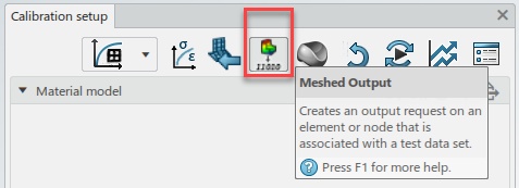

5)  Use the Meshed Output icon to map, or match, the various pieces of test data to the corresponding FE model output.

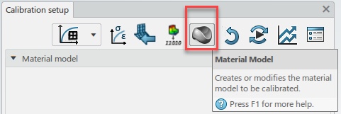

6) Select your material model.  Only one material model may be calibrated.

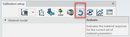

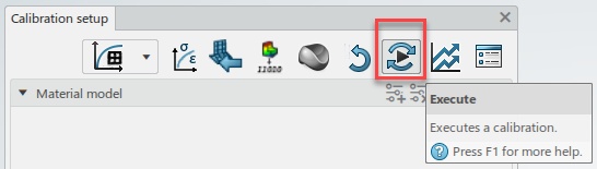

7)  Run a one-time Evaluate of the model using the current material parameters.  This step is to check that everything is working and that the current material parameters give a response that is at least in the right ballpark.
8) Execute a calibration
