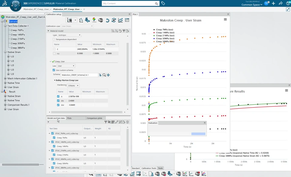

In this post, we want to:
  1. Show the use of a Custom Schema xml file to enhance the Calibration App's UI for user input of creep parameters.
  2. Show the use of a Creep user-subroutine.

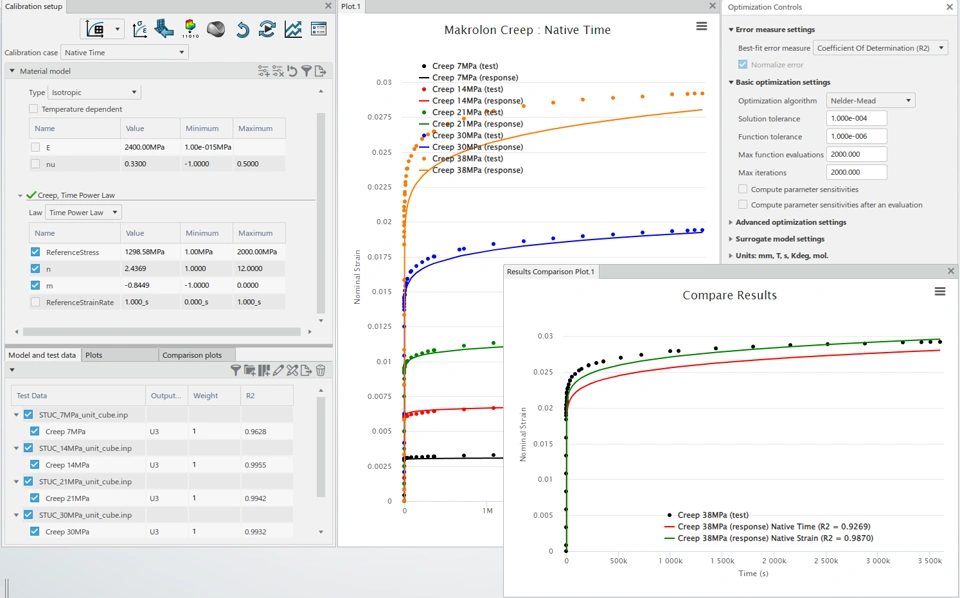

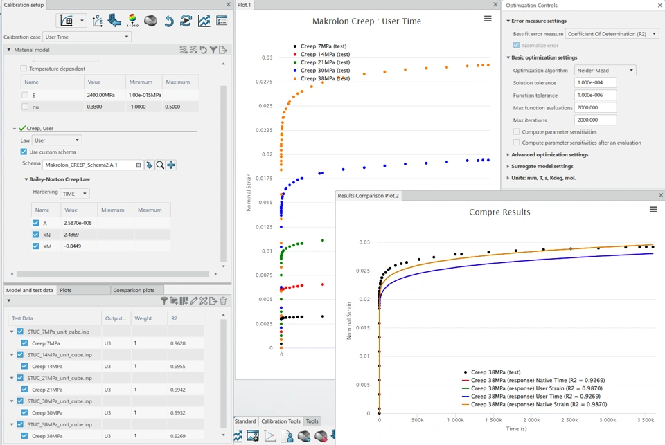

  3. Show the use of four calibration cases to compare native vs user-sub creep and to compare time vs strain hardening.

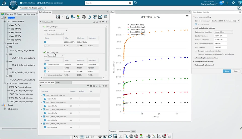

1) set units to N, mm, MPa

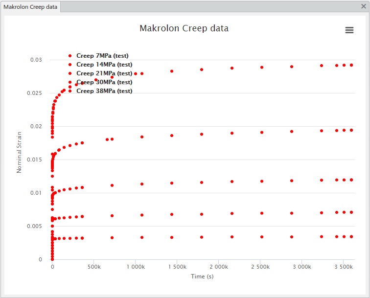

2) import all the Makrolon creep data    (import & open the file Makrolon_RT_Creep_User_just_data_FE.3dxml to start here).
3) import the FE models
4) map all FE outputs -> test data. Use U3 FE output to map to strain test data.
5) define the two native cases, for Strain hardening and Time hardening.
6) define the two user-sub cases
7) for CREEP User cases, import standardU.dll
8) for CREEP User cases, import custom schema
In this first video, we walk through the steps 3 - 5
Here is what things look like at the end of the first video..
The second video performs steps 6, 7, 8, creating the two calibration cases using the creep user-subroutine
Here is what things look like at the end of the second video..
