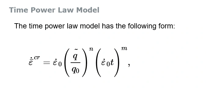

Creep User Subroutine Calibration
The creep law shown above is sometimes called the "Bailey-Norton" power law. It has been available in Abaqus for decades, but it has some serious drawbacks.  The parameter "A" has odd units that depend upon the value of the other parameters. Because the 3DExperience platform is a 'units aware' software, the Bailey-Norton creep law is not supported there.
The creep law shown below is more modern, available in Abaqus since 2019.

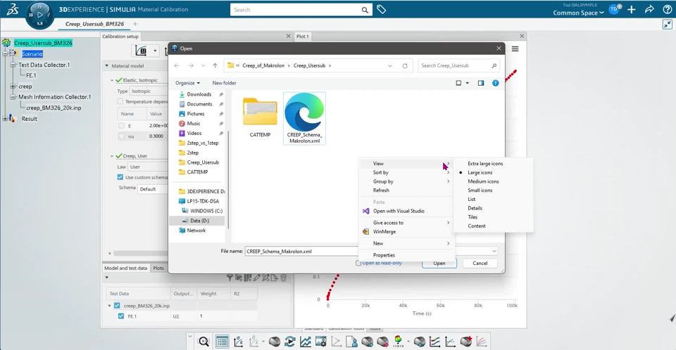

Notes on Custom Schema (Nov, 2025) :
Relative to the Material Calibration App in 3DX, when I say I am going to use a Custom Schema, I am doing this to enhance the App's UI.  The Custom Schema .xml file for this example looks like this:
When you import this .xml file, the UI is enhanced like this:
Using a Custom Schema has several advantages:
  1.  Allows you to name the parameters
  2.  Allows you to assign units to the parameters.
  3.  Allows you to assign default values for the parameters (default values must be in MKS in the Schema file).
When you use this Custom Schema in the Material Calibration App, the App will write out an Abaqus .inp file that has this sort of material definition:
This in turn means that the user subroutine you wrote must have been coded to access parameters from a *PARAMETER TABLE
