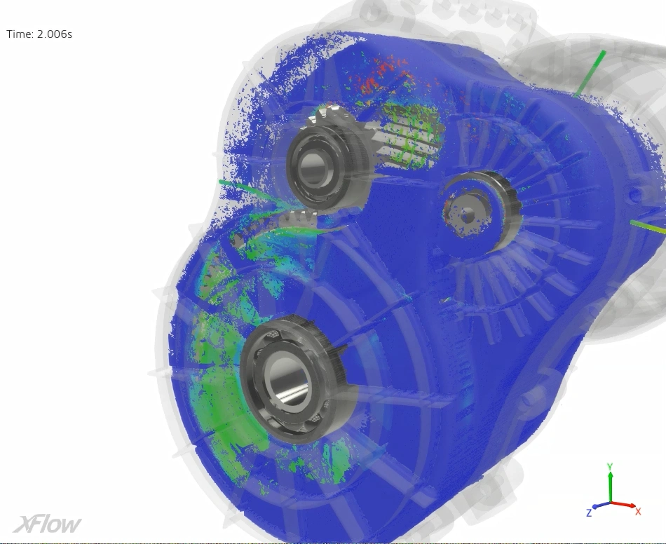

Simulation of oil within a gearbox in motion, showing the spray and churning.

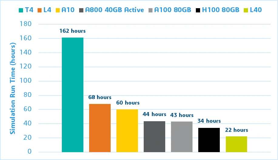

In order to accurately simulate lubrication performance, a high-accuracy solver is needed, operating on a high-fidelity model of the system. This means that lubrication simulation has significant computational requirements. GPU computing allows complex gearbox lubrication simulations to be run quickly and efficiently, even on relatively modest hardware.
SIMULIA XFlow supports GPU acceleration using CUDA technology from NVIDIA. GPU-accelerated simulation speeds the performance of high-fidelity and intricate CFD simulations, and make them accessible to a wide audience, thereby democratizing access to advanced simulation capabilities.  For example, an NVIDIA L40 GPU can run a large complex gearbox simulation within one day.
Simulation times on NVIDIA GPUs for a full detailed gearbox simulation. 15,247,298 million cells, time step: 4.26e-6 sec, simulation time: 5 sec. Test run with XFlow 2023 Golden (Build 120.01), NVIDIA Driver: 535.54.03, OS: Ubuntu 20.04.

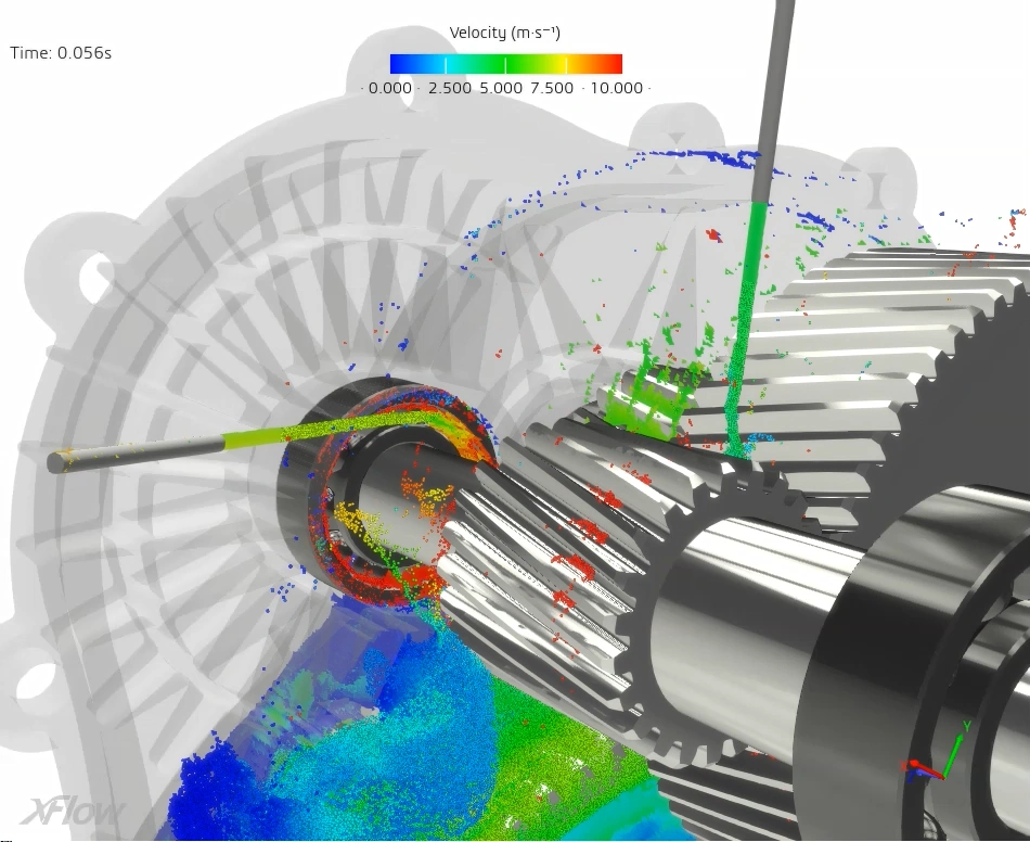

In this case study, the XFlow GPU solver was used to assess the reliability of an automotive Electric Drive Unit (EDU) gearbox. This gearbox has been identified a susceptible to reliability issues, primarily stemming from the thermal failure of a key bearing connected to the input shaft from the motor. An OJLS has been engineered to tackle the root cause by ensuring precise lubrication and subsequent cooling of all bearings and gears.
3D image of the inside of a gearbox. One oil jet lubricates a bearing while another lubricates surfaces between gears. The oil particles are colored according to velocity.

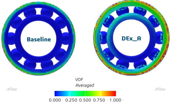

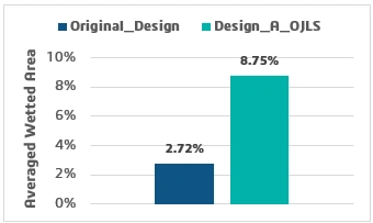

From the simulation, we were able to extract Key Performance Indexes such as torque drag and individual component wetted area quickly. The simulation showed that the OJLS increased the oil coverage of the failure-prone bearing by over 3 times. In doing so, the OJLS mitigates the risk of thermal failure resulting from inadequate lubrication.
Bar chart showing improvement in average wetted area in the bearing.
Simulation results for the volume of fluid (VOF) within the bearing
Although the OJLS introduced more oil into the system, carefully targeted oil jets meant there was only a 20% increase in torque drag associated with churning losses. This outcome proves that a well-designed OJLS far outperforms a mere augmentation of the initial oil volume within the system. Optimizing the OJLS without simulation would have been a much more challenging process, with considerable time spent building and testing prototypes – as well as the difficulty of extracting accurate KPIs from measurement data without considerable uncertainty. By running the simulations on GPUs, these results could be obtained much faster than a physical prototype would have provided.
