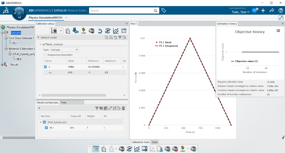

FE-mode simple elastic calibration w/ unit cube
This is a very simple FE-mode calibration, just to be able to go through the steps quickly.  The zip file attached to this post contains the test data (.txt file), the FE model (.inp file) and the resulting 3dxml file.  The FE model is a one element model, and of course, runs very quickly.  The target material model is linear elastic.
Here is a narrated video showing how to set up the calibration and perform the calibration.  This video was created using the 3DX public cloud, R2022x FD02, HotFix 2.6  on April 26, 2022.
The attached zip file contains the test data, the FE "run-ready" model and the resulting 3dxml file.
