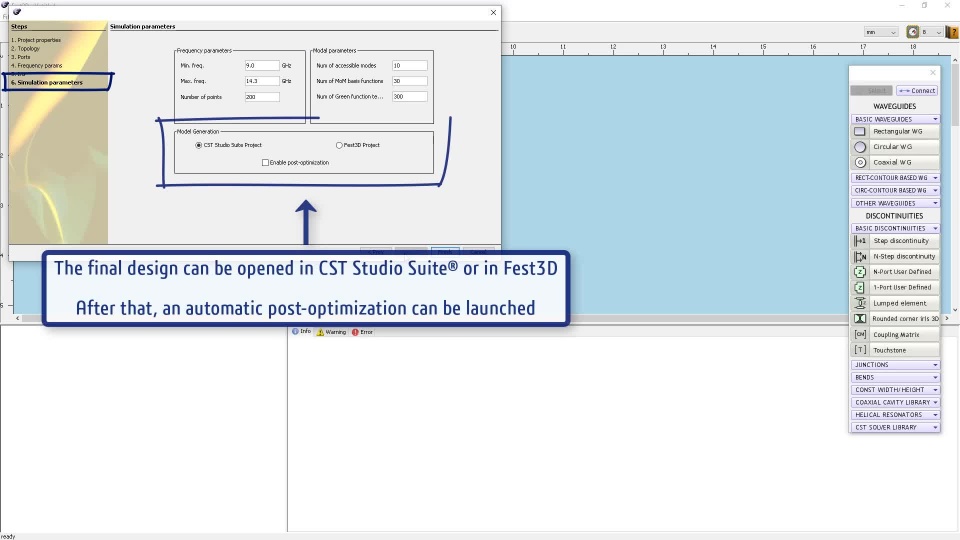

The synthesized filter model is automatically opened in CST Studio Suite for analysis and/or post-optimization, which is typically not required.
