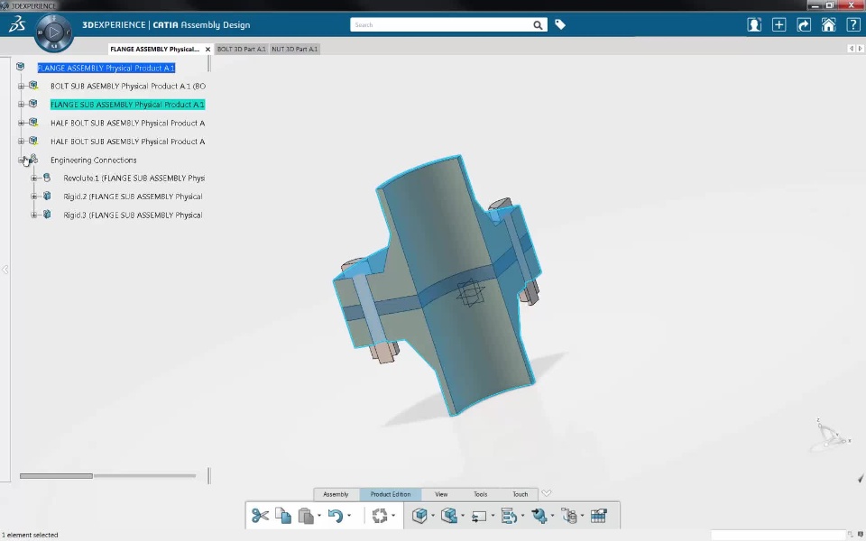

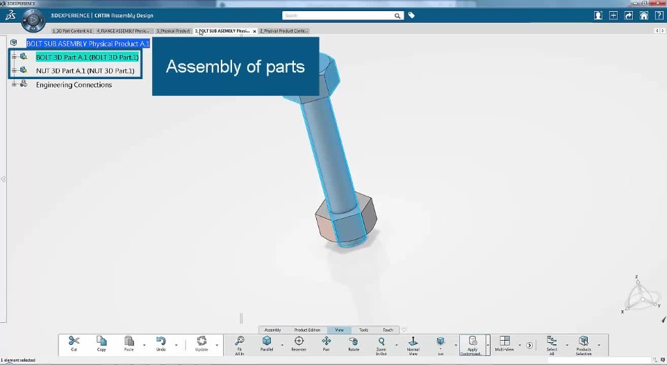

What is a Physical Product and how to create assemblies?
You can build complex assemblies consisting of many components, which can be parts or other assemblies. The Physical Product is the database object that represents such an assembly and thus enhances the concept of 3D Parts.
Can we use Physical Products instead of 3D Parts?
This video illustrates the differences between Physical Products and 3D Parts.

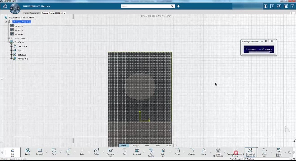

Ordering & Absorption of features in hybrid PartBody design
The choice of hybrid part bodies affects how surface and wire frame features are added to the specification tree structure. Ordering of features mirrors the process of creating a design.
