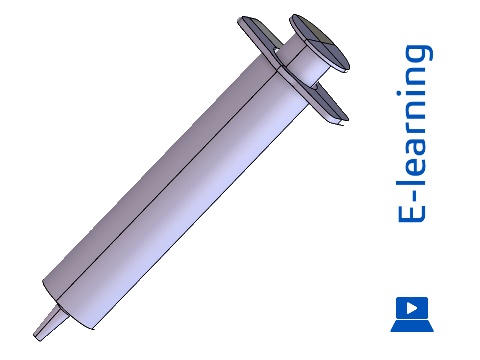

3DEXPERIENCE: Syringe Analysis Example

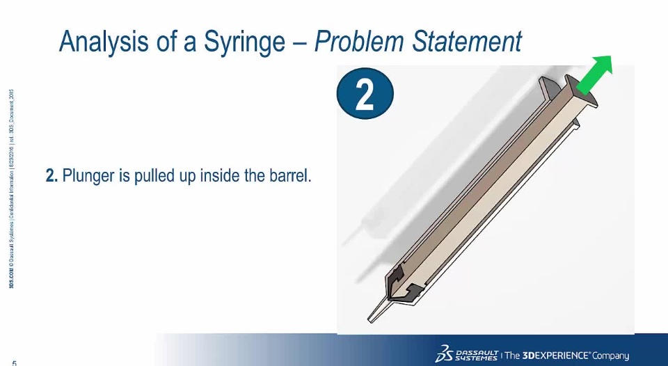

This example demonstrates the analysis of the interference fit of a syringe assembly using the scenario app.
The material was created using 3DEXPERIENCE R2016x but is still valid for newer versions.   This example will be helpful for Expert roles such as: Structural Analysis Engineer, Structural Professional Engineer, Mechanical Analyst, and/or Structural Mechanics Engineer.

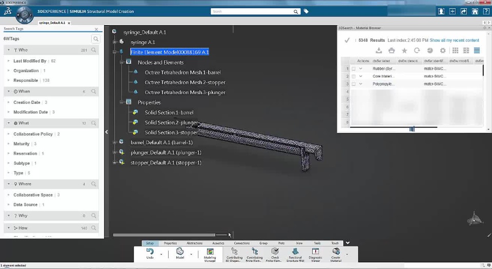

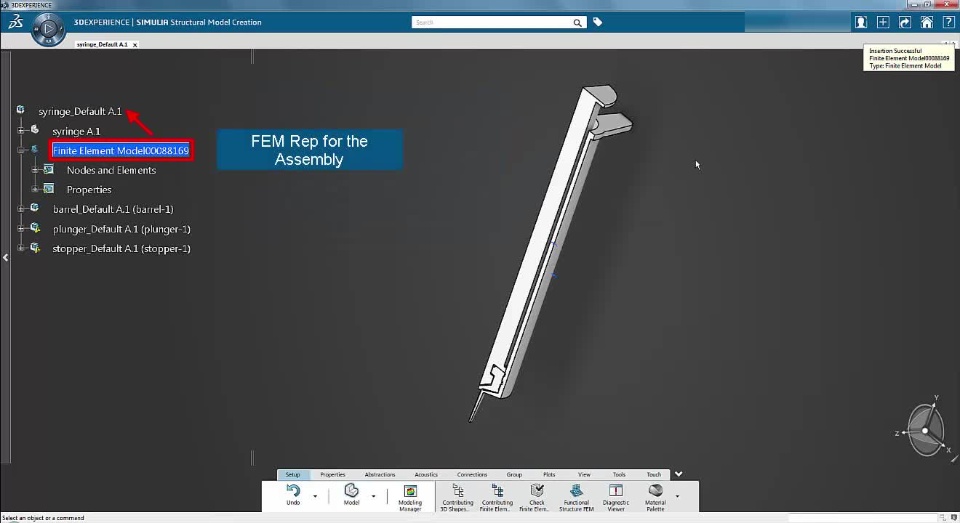

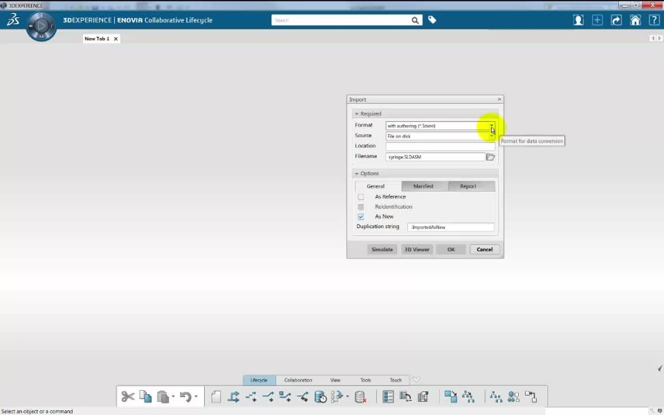

2. Import SolidWorks files in to the Platform

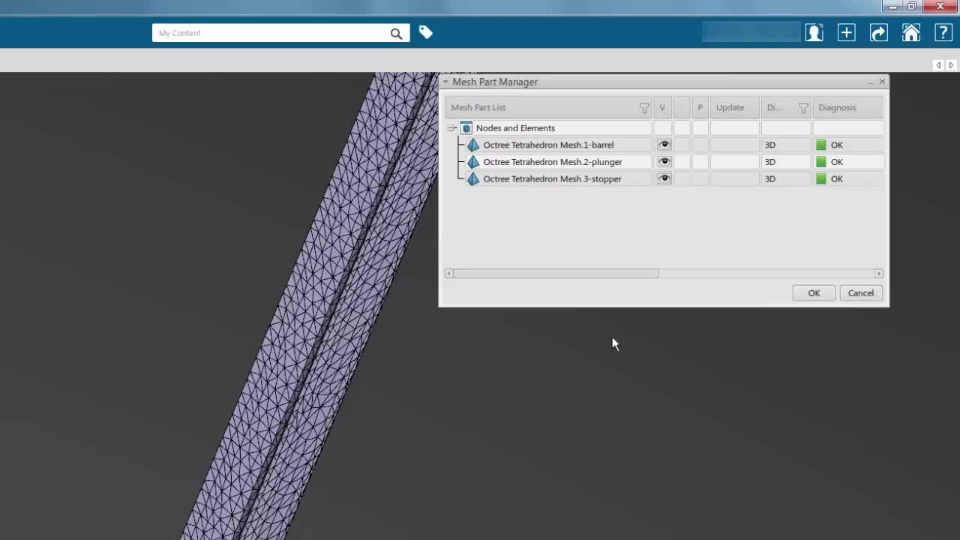

3. Create the mesh for the syringe assembly
4. Refine the stopper mesh
5. Update the section definitions with material properties

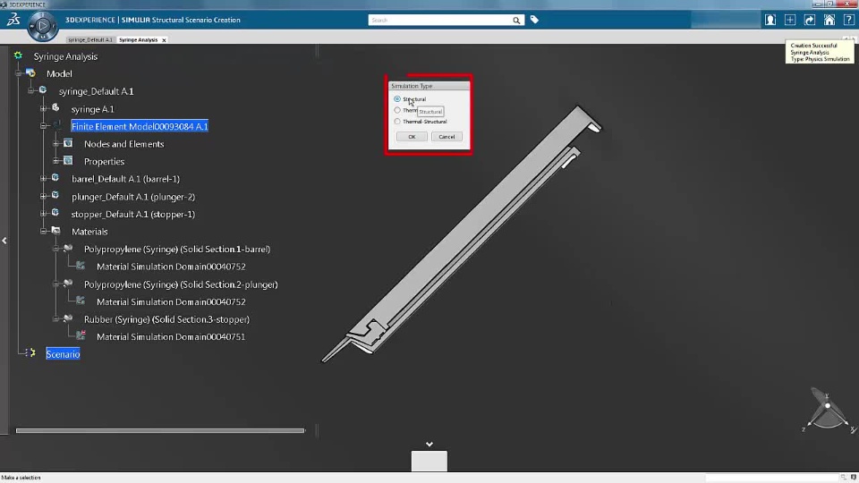

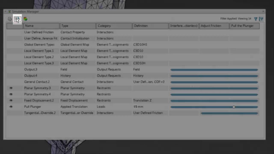

6. Introduce the simulation workflow
7. Create the simulation object

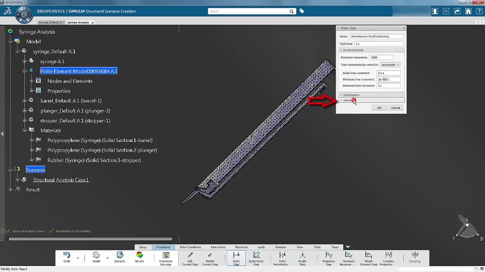

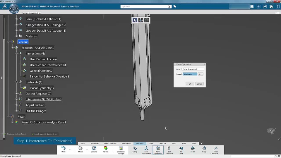

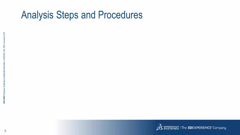

8. Create analysis steps

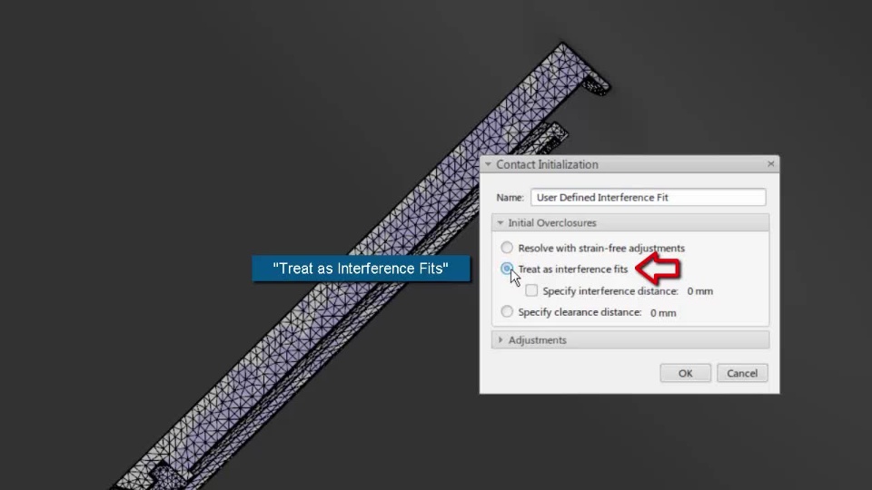

9. Define contact
10. Define restraints

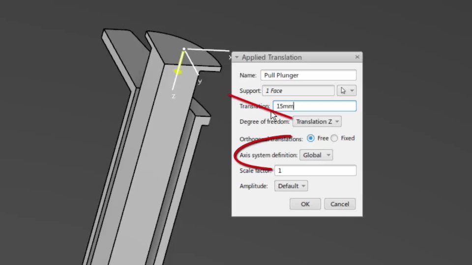

11. Define loads

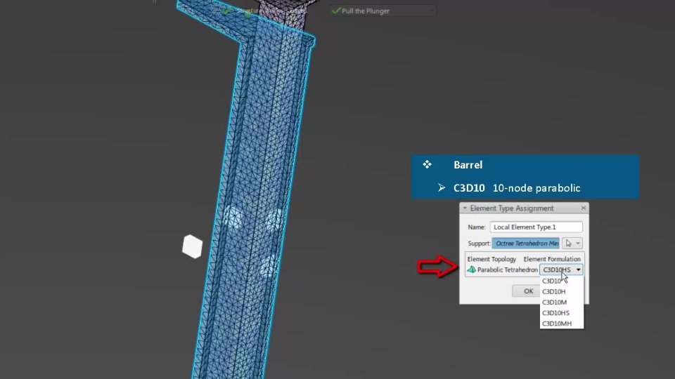

12. Assign element types
13. Modify field output request

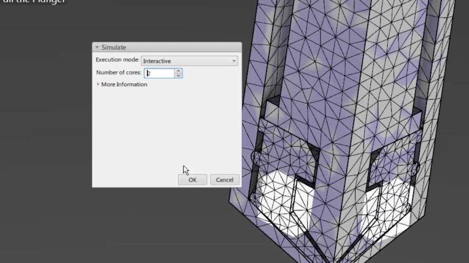

14. Execute the simulation

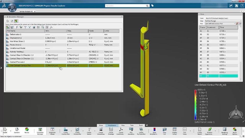

15. Explore results
