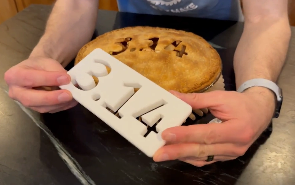

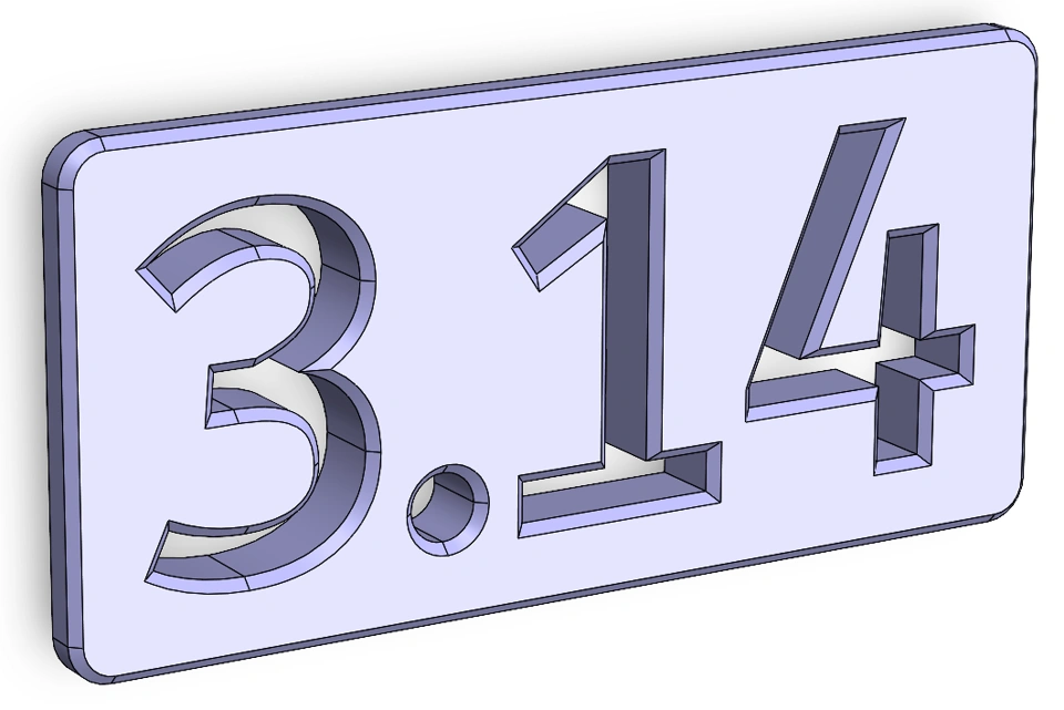

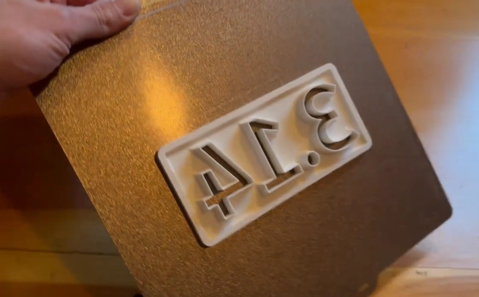

It was a lot of fun to make, so this year, I designed a few more tools to help me bake the perfect pie! I started by making a cookie cutter to cut the first few digits of PI out of the top crust.
I used SOLIDWORKS for Makers to model the cookie cutter and a Bambu P1S to print it out.

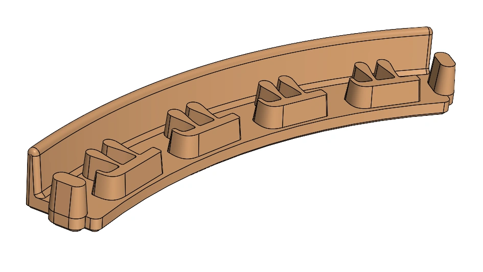

Then I modeled an edge crimper to seal the top and bottom crusts.

Once everything was printed, I put the tools to the test making my favorite apple pie recipe (complete with a bit of home made caramel!).
