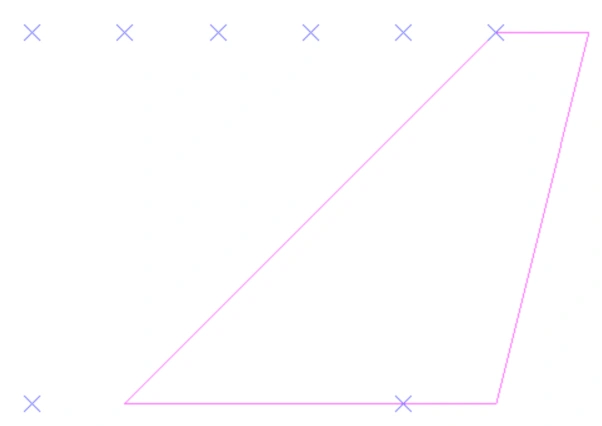

Using the SclSelectPoint command (inside a TCL while loop) to manipulate data.  This is one of my favourite SCL commands in Surpac and is useful in so many situations.
<i><strong># Now, lets say we wanted to edit a point in the layer to a known coordinate. We first need to get a "handle" to the point.</strong></i>
<i><strong># We will use "SclSelectPoint" to achieve this.  This is a very versatile function that I'll cover in a later QA doco.</strong></i>
<i><strong># There are many options for editing this point however for this QA I will just move the point 1m East for every click on the point.</strong></i>
<i><strong># To do this we need to put the command in a while loop.</strong></i>
while {1} {
  <i><strong># Note pointMod below.  This is the reference variable that gives me complete access to this point and all data attached to it.  </strong></i>
<i><strong>  # Note also that the coordinates of the point are stored in the x, y and z variables below as well.</strong></i>
  set status [SclSelectPoint pointMod "Click a point to move by 1m East. Press Esc to continue." layerName strNum segNum pntNum x y z desc]
Using the \\\$pointMod handle we can use the SclGetParent command to gain access to the segment it belongs to.  The handle to the segment is stored in the reference variable called "segMod"
  <i><strong># Using the handle we have to the point in reference variable "pointMod" get a handle to the segment it resides in.</strong></i>
  \\\$pointMod SclGetParent segMod
We use a TCL if command to check that the user is still selecting points.  As soon as they press "escape" the while loop is broken with the TCL "break" command.
  if {\\\$status != "\\\$SCL_OK"} {
     puts "Finished moving points"
     break
We use the SclSetValueByName command to modify the x coordinate of the selected point.  In our case we are just coding it so that 1m is added to the x value of any point we select.
  <i><strong># Add 1m to the current x value</strong></i>
  \\\$pointMod SclSetValueByName x [expr \\\$x+1]
Using the handle to the segment (\\\$segMod) we erase the segment before redrawing it with the updated changes.  The bracket just closes the while loop.
  \\\$segMod SclErase
  <i><strong># Using the handle to the segment, draw the updated coords on the screen.</strong></i>
  \\\$segMod SclDraw

\\\$newDesignStrs SclDraw
# Whenever you bring data into a layer, you'll generally need to zoom all to see it.
SclFunction "ZOOM ALL" {}
while {1} {
     break
  \\\$segMod SclErase
  \\\$segMod SclDraw
puts "End of part 4"
