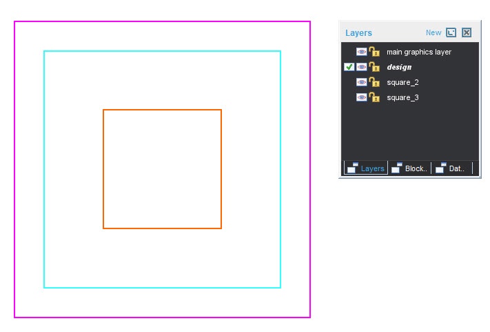

puts "Part 3 - layer iteration and finding the layer you want. Plus, creating a small GUIDO form."
Get a handle to the current active viewport.
<i><strong># Get a handle to the active viewport and store it in reference variable "vh"</strong></i>
SclGetActiveViewport vh
Now iterate over all the layers that are in the current viewport.  We do this by using the "sclGraphicsLayers" command in conjunction with the SclIterateFirst subcommand and a variable called "Iterator" (The variable "Iterator" can be called anything though)
<i><strong># Use sclGraphicsLayers command with SclIterateFirst command to setup a layer iterator</strong></i>
sclGraphicsLayers SclIterateFirst Iterator
The while loop below reads in English as -> While there is another layer to iterate over, keep iterating. Each new layer name is stored in a reference variable called "SwaHandle" (Again, SwaHandle can be called anything.)
<i><strong># Using a TCL while loop, keep iterating over the layers until there are no more to iterate over.</strong></i>
while {[\\\$Iterator SclIterateNext SwaHandle] == \\\$SCL_TRUE} {<!-- -->
Using the reference variable "SwaHandle" use the SCL command SclGetId to find out the name of the layer.  Use the TCL command "puts" to print the name of the layer to the message window.
<i><strong>  # Write the layer name to the message window by inquiring the SwaHandle reference variable using the SclGetId command.</strong></i>
  puts "Layer name is [\\\$SwaHandle SclGetId]"

To display the form we must use two more Scl Commands. 1. SclCreateGuidoForm and 2. SclRun
The SclCreateGuidoForm command essentially compiles the form in the background with default values and objects ready for display. This is also where we set the "layer" variable to hold all our layer names contained in the "layerList" variable.
Note that the form (\\\$layerSelection) is now compiled and stored in the "formH" variable.
<i><strong># Use the SclCreateGuidoForm command to compile the form into a variable called "formH"</strong></i>
SclCreateGuidoForm formH \\\$layerSelection {
  <i><strong># This populates the combobox with all the layers in the layerList variable</strong></i>
  set layer.setValues \\\$layerList
 The SclRun command will then display the form.  It is running the \\\$formH variable which is storing our compiled form.
\\\$formH SclRun {}

The code below will set the active layer to the one that was chosen in the form by the user.  It is essentially the same piece of code used in the layer iterator above with some small changes.
We are iterating over all layers one by one.  Each time we iterate, the reference variable called "ourSwa" stores the handle to the layer.
We then use the SclGetId to check what the layer name of \\\$ourSwa is.  If the name matches the one chosen in the GUIDO form, we use SclSetActiveLayer to make it the active layer.
The TCL "break" command exits the while loop once the user selected layer has been found.
<i><strong># ourSwa is the reference variable that we can use when setting the active layer</strong></i>
while {[\\\$Iterator SclIterateNext ourSwa] == \\\$SCL_TRUE} {
  <i><strong># store the layername into a variable called "layerName"</strong></i>
  set layerName [\\\$ourSwa SclGetId]
  <i><strong># Check to see if the current layer stored in \\\$layerName is the one selected which is stored in \\\$layer variable.</strong></i>
  if {\\\$layerName == \\\$layer} {
    puts "Active layer is now \\\$layer.  Check the \\"layers\\" pane to see if this is true."
    <i><strong># If we find the required layer, use the SclSetActiveLayer command to change the active layer referenced by \\\$SwaHandle</strong></i>
    \\\$vh SclSetActiveLayer \\\$ourSwa
    puts "Click in graphics once layer is confirmed."
    SclPause
    <i><strong># no need to search once we have found the layer we are after.  Break will exit the while loop.</strong></i>
    break

####### PART 3 #######
puts ""
  set layerName [\\\$SwaHandle SclGetId]
  # Don't store the main graphics layer into the list of selectable layers as it may be empty.
  if {\\\$layerName != "main graphics layer"} {
    # Append the layerName into a list called layerList.  TCL lists are simple.  Just imagine a shopping list.
    lappend layerList \\\$layerName
puts "Layers added to a list... Click in Graphics to continue"
SclPause
# Form definition start here.  Details of the form are stored in the "layerSelection" variable.
set layerSelection {
#GuidoForm container has two switches, the label and default_buttons switch.
  GuidoForm form {
    -label "Select Layer"
    -default_buttons
    GuidoComboBox layer {
      -label "Layer"
      -width 15
      -exclusive true
      -default "design"
};# Form definition ends here.
\\\$formH SclRun {}
if {"\\\$_status" != "apply"} {
  puts "Macro cancelled"
  # Normally you would stop the macro if someone pressed cancel but in our example we press on.  Just unhash return for normal function.  "return" is another TCL command that in this instance will stop the macro.
  #return
puts "You have selected the \\"\\\$layer\\" layer"
    SclPause
    break
puts "End of part 3"
