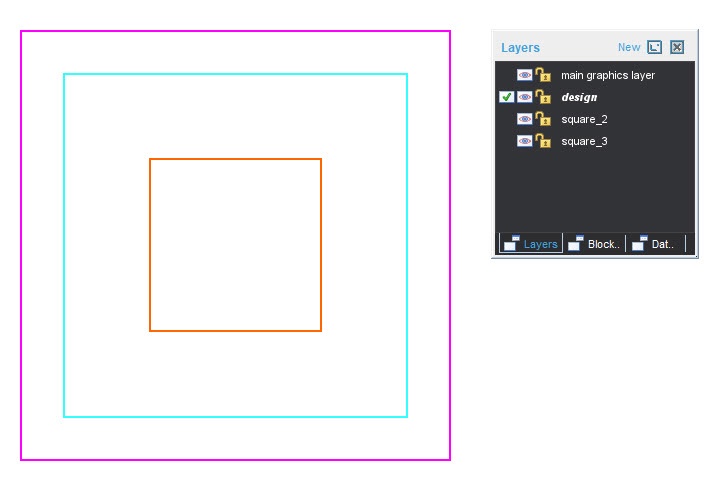

Following on from part 1, lets create some more layers to accept new data.
<i><strong>#Create a layer called square_2 that can be manipulated/inquired with the "square2Swa" reference variable</strong></i>
SclCreateSwa square2Swa "square_2"
sclGraphicsLayers SclAdd \\\$square2Swa \\\$vh
<i><strong># Using the reference to "square2Swa", create a reference variable "square2Str" and make the string number 6</strong></i>
\\\$square2Swa SclCreateString square2Str 6
<i><strong># Create a new segment.  See details from part 1 about how this works.</strong></i>
\\\$square2Str SclCreateSegment square2Seg [\\\$square2Str SclCountItems]
Now each point we want to create takes 4 lines of code. (See part 1 of this macro series)  These four lines are almost identical except for the reference to the segment plus the coordinates.  We can create something called a procedure to eliminate the repetition of code.  TCL procedures are like new commands and are defined once.  The command/procedure is given a name and some parameters that you want to pass to it.  The procedure executes using your parameters and in some cases will return a value back to you for use later on.
<i><strong># Procedure is called "newPoint" and takes 4 parameters.</strong></i>
<i><strong># 1. The segment reference 2. The X coord, 3. The Y coord and 4. the Z coord</strong></i>
proc newPoint {segHandle x y z} {
<i><strong>  # The rest of the code is exactly the same as what we did in part one when creating a new point</strong></i>
<i><strong>  # The only difference being that we are using variables i.e. \\\$x that are input when the procedure is called.</strong></i>
  \\\$segHandle SclCreatePoint pntHandle [\\\$segHandle SclCountItems]
  \\\$pntHandle SclSetValueByName X \\\$x
  \\\$pntHandle SclSetValueByName Y \\\$y
  \\\$pntHandle SclSetValueByName Z \\\$z
  return \\\$pntHandle
Now that the procedure is created, we can create new points with one line of code instead of four.  Just call the procedure and list the parameters separated by white space.  Remember, procedure name is "newPoint" and the parameters are segment handle, x, y and z.
newPoint \\\$square2Seg 11 11 10<i><strong>;# First point, note that we are using square2seg as the segment reference</strong></i>
newPoint \\\$square2Seg 11 19 10
newPoint \\\$square2Seg 19 19 10
newPoint \\\$square2Seg 19 11 10
newPoint \\\$square2Seg 11 11 10<i><strong>;# Closing point is same as first point</strong></i>
We'll save drawing the data on the screen until the end of the macro so for now lets create another layer with a smaller square.
<i><strong># Create a layer called square_3 that can be manipulated/inquired with the "square3Swa" reference variable</strong></i>
SclCreateSwa square3Swa "square_3"
sclGraphicsLayers SclAdd \\\$square3Swa \\\$vh
<i><strong># Using the reference to "square3Swa", create a reference variable "square3Str" and make the string number 9</strong></i>
\\\$square3Swa SclCreateString square3Str 9
<i><strong># See details from part 1 about how SclCreateSegment works.</strong></i>
\\\$square3Str SclCreateSegment square3Seg [\\\$square3Str SclCountItems]
Use our procedure to create the square.
newPoint \\\$square3Seg 13 13 10<i><strong>;# First point, note that we are using square3seg as the segment reference</strong></i>
newPoint \\\$square3Seg 13 17 10
newPoint \\\$square3Seg 17 17 10
newPoint \\\$square3Seg 17 13 10
newPoint \\\$square3Seg 13 13 10<i><strong>;# Closing point is same as first point</strong></i>
Now draw the squares.  Note that they don't have to be the active layer as I'm using the reference variable to the string.  Note also that I can override the styles file and draw these shapes how I want using the SclDraw options as below.
\\\$square2Str SclDraw
\\\$square3Str SclDraw "style=ssi_method=line,HGS_color=line=red,HGS_line_weight=2"
