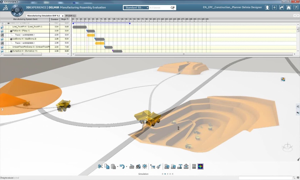

Relying on Dassault Systèmes’ Delmia production simulation tool, which can create 3D models of specific, discrete events, the company developed thousands of scenarios to visualise how equipment would move and interact under various mine designs.
This video,  for example, illustrates how a loader might move to a draw point, gather the material, and dump it into the ore pass.
This video of an open pit operation shows another type of equipment simulation (the basics are the same for block caving) available through DELMIA.
Simulations like these enable mine designers to evaluate a range of production-related issues, including equipment movement, and, in the case of the copper miner we have been focussing on through this series of articles, the effect of bigger or smaller equipment:
