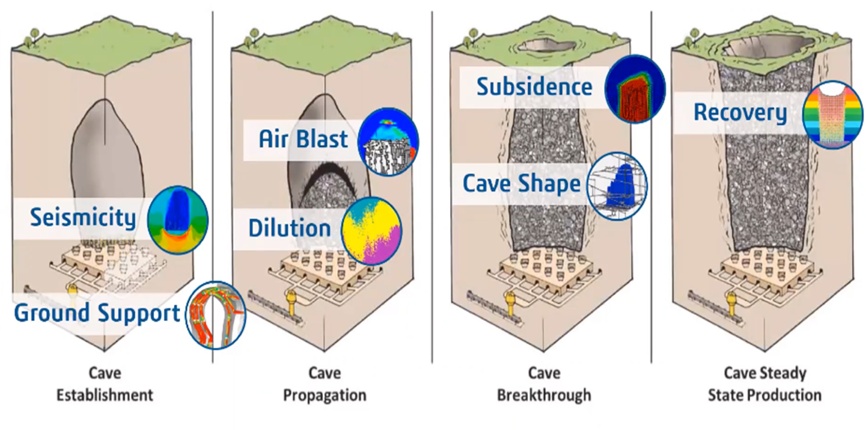

But those characteristics can be hard to assess, and there is always the risk that the deposit will simply be too solid to cave or that it will collapse unpredictably, making it difficult to extract the ore efficiently and also potentially hazardous for workers and equipment. In addition, mines do not want to design a block caving project that will lead to air gaps during cave propagation, which can cause dangerous air blasts.
Geomechanical simulation
Geomechanical simulation can help mines understand factors such as:
  • whether there is enough ground support for a block caving project
  • if a particular design will result in subsidence and a large crater on the surface, and
  • how large the economic recovery might be.

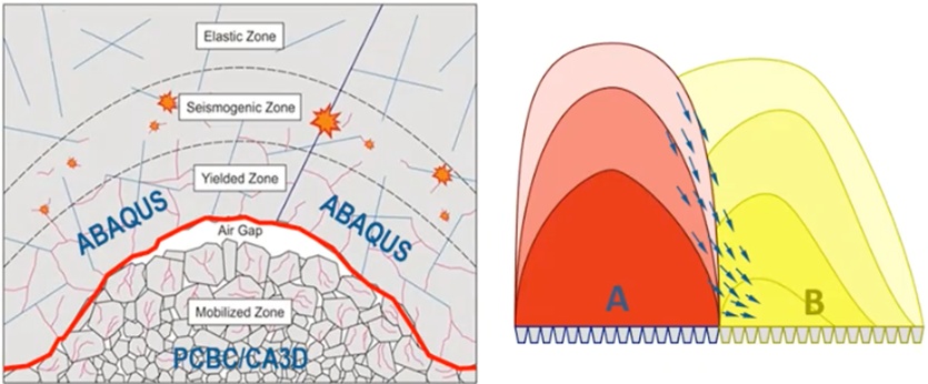

The copper company was particularly concerned that, while it looked like they had a good formation of high-grade material within their proposed mine design, there may be problems with vertical cave propagation. Specifically, they feared that the formation may not be able propagate fast enough to avoid air gaps, which would have a major effect on extraction level location and extraction strategy.

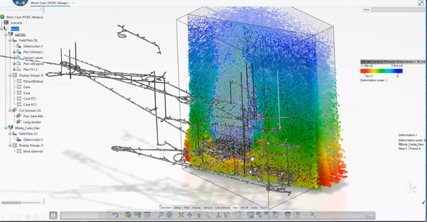

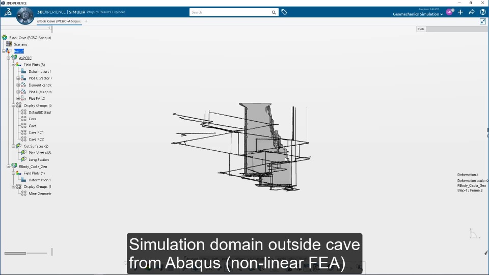

In order to better understand and calibrate cave-back stress and the potential for breakthrough, the company’s mine designer took the draw points identified in Dassault Systèmes’ PCBC mine planning software and sent them to our geotechnical simulation software, Abaqus.
From there, Abaqus ran a series of scenario simulations using a variety of inputs — including swell factor, friction angle, cohesion, strain value, and principal stresses — to reveal the answer to what could be a billion-dollar question: where the limit between broken and solid material should be located.
Results
For the copper company, the geotechnical simulations revealed that the extraction strategy they had been pursuing was wrong. It was too aggressive and would generate a large air gap very quickly.
As a result, the designer changed the strategy to pull material more slowly and allow enough time for the cave to mature and propagate — a change that would have a major impact on NPV.
