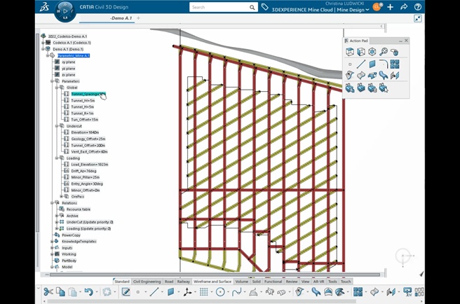

Using Dassault Systèmes’ parametric design tool, which enables mines to virtually create, update, and analyse a design within their own operating environment, the copper company’s designer used a number of different inputs to accommodate larger LHDs.
For example, the designer started by spacing the extraction level tunnels at 30m. The parametric design tool then automatically updated the undercut level to meet that criteria:
The red lines are the tunnels at the undercut level; the yellow lines are the tunnels at the extraction level, where the loaders must run to.

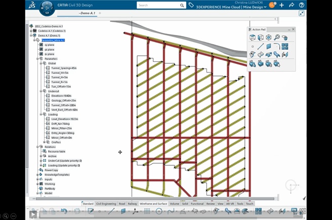

For comparison, the designer then widened the extraction level tunnels to 36m, and the tool  immediately updated both the extraction and undercut level tunnels, while maintaining the same distribution of tunnels — in a matter of seconds:

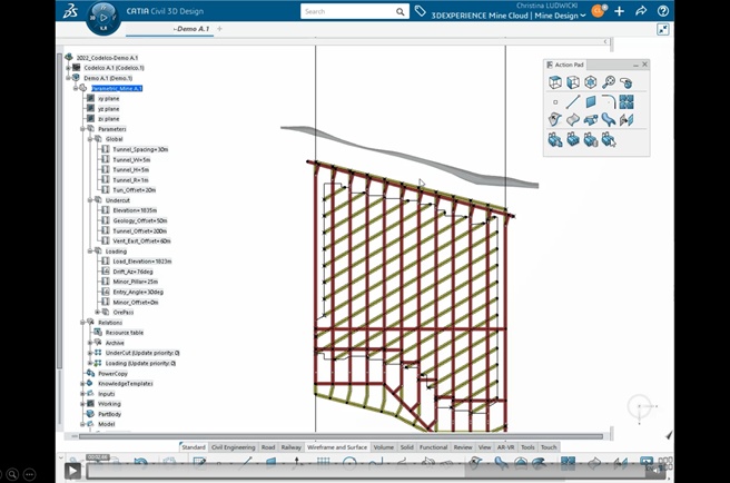

After altering the tunnel spacing a few more times, the designer determined the 30m tunnel spacing was optimal and moved on to experimenting with tunnel heights and other parameters, including the offset between the tunnels and a geological structure at one end of the mine site.
The image below shows the tunnels positioned at 25m from the geological structure, shown in gray at the top:

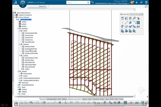

After taking into account the most current geotechnical data, however, which indicated that this offset might not be enough for safety, the designer doubled the distance to 50m, and Parametric design again updated the whole design automatically to this:
