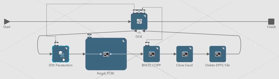

To make integration simple, Process Composer eliminates the need for a designer to manually transfer the parameters and results from the parametric design into a mine planning package. Instead, it works with PCBC to handle the output variables of the design as input variables for the mine plan, allowing for an automated workflow throughout the entire mine planning process and between multiple applications/software.
In the copper company’s case, PCBC automatically analysed the various parametric designs (signified by the 3DX Parameters box above) and then handed off to other tools to:
  • generate new draw point distribution for each design
  • create draw columns, based on block model and grade distribution data, to suit each tunnel spacing
  • run best of height draw (BHOD) simulations to estimate economic mineable reserve, and
  • calculate the tonnage, dilution, and grade of copper that could be extracted with the tunnels spaced at different intervals.

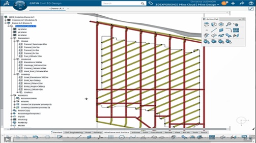

In this image, the draw columns generated by PCBC match extraction level tunnels set at 30m:

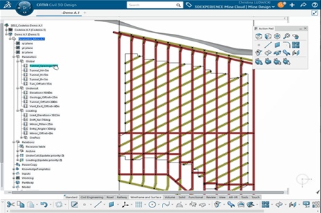

Here, the draw columns generated by PCBC match extraction level tunnels set at 36m:
As you can see, however, the draw columns for tunnels set at 36m created much higher pillars between each draw point than tunnels set at 30m, which will affect the tonnes and grades the company will be able to extract.

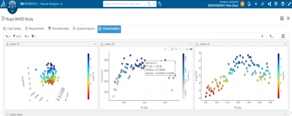

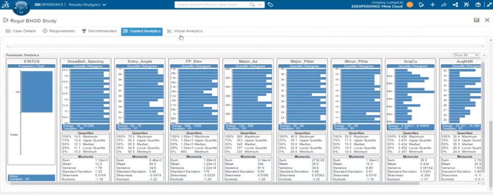

From there, the designer employed the Process Composer results analytics program to first review all the scenarios:
And then provide 2D or 3D visualisations of each design, where each dot represents one run of the simulation, making the results very simple to analyse and compare:
After that, the designer added the favourites, based on average NSR, to a basket for more in-depth review.
