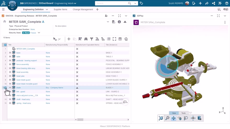

DataGrid -  Global qualification status of all MEIs of a specific Engineering Item
The global qualification status of the MEI(s) related to the Engineering item, is visible in the DataGrid view:

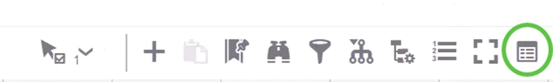

To enable this, you need to add a new column titled “Manufacturer Equivalent Items (MEI)” to the DataGrid view. This column will indicate the global qualification status of the Manufacturer Equivalent Items linked to the respective Engineering Item.
This column is not available by default in this view. You can add it using the command “Attribute Management”:

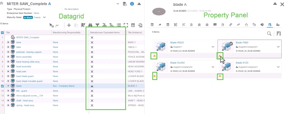

Property panel: Qualification status of the MEI itself
Once the attribute is added to the widget, the MEI’s and their qualification status, will be available in the property panel, upon selection of the Engineering Item:
The table below provides an explanation of each symbol near the MEI:
SymbolMeaning
OK: MEI should be Released, Both Qualifications (Engineering/General) should be Released, with approval = YES and Last time Buy, not set. And validity dates are OK
Pending Obsolete: MEI should be Released, Both Qualification should be Released, with approval = YES and Last time Buy, SET. And validity dates are OK.
In Progress: Any Qualification In Work or Review.
KO:   Any Qualification (Engineering Qualification or General Qualification with “approval = NO” - and all Qualifications and MEI are Released
