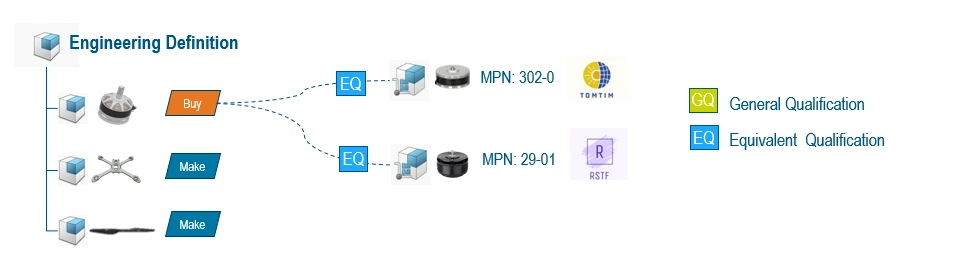

ENOVIA manages the engineering definition through Engineering Items (EI), which represent the engineering specification for the OEM’s internal components. Each Engineering Item is defined as either a "Buy" or "Make" item to optimize production planning and decision-making.
This definition indicates whether a component should be sourced from external suppliers ("Buy") or manufactured in-house ("Make").
Manufacturer Equivalent Item (MEI) is a product that serves as a compatible replacement for an Engineering Item (EI) and represents the engineering specification of the manufacturer component.
Each MEI has an MPN, which is the Manufacturer Part Number as provided by the manufacturer.
For Engineering Items designated as "Buy" items, it is often beneficial to associate multiple Manufacturer Equivalent Items (MEIs) with each Engineering Item (EI). This approach minimizes reliance on a single manufacturer, enhances supply chain resilience, and helps ensure consistent availability. Different MEIs may represent manufacturers from various regions, allowing for localized sourcing to save on logistics and customs fees. By having multiple MEIs available, companies can reduce risks associated with supplier delays, price fluctuations, potential shortages or discontinuation, while maintaining quality and meeting production timelines.

MEI Qualification:
MEI Qualification is the process of evaluating and verifying a Manufacturer Equivalent Item (MEI) to ensure it meets the required specifications, quality standards, and performance criteria of an original equipment manufacturer (OEM) part. The qualification process aims to confirm that the MEI can function as an acceptable substitute for the OEM item, without compromising on quality, compatibility, or reliability.
In ENOVIA, we support two types of MEI qualifications:
  • General Qualification
    • This is a process used to evaluate an MEI independently of where it is used. It focuses on assessing compliance, performance, quality, and sourcing standards to ensure the MEI meets general requirements.
      This type of Qualification is connected to the MEI and is automatically created once the MEI is created.
  • Equivalent Qualification
    • This is a process used to qualify two independent objects as equivalent to each other.
      This type of Qualification is done on the association between the two equivalent objects.
      For example, Equivalent Engineering Qualification is a rigorous evaluation process used to verify that an MEI precisely matches the engineering specifications of a designated Engineering Item. This qualification ensures the MEI can function as an exact substitute for the specific OEM component, meeting all critical technical criteria, including specifications, tolerances, materials, and performance standards.
      The engineering equivalent qualification is done on the relation between the Engineering Item and the MEI.
