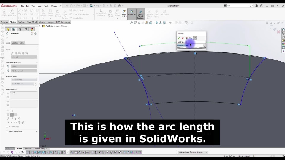

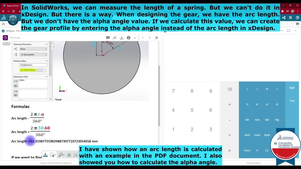

I needed to design a gear for this design. However, xDesign does not yet have a measure tool with which I can determine the arc length. While I was thinking about how to do it, an idea came to my mind. I tried and it worked.
In the first video I show you how to give the arc length in SolidWorks. This is an excerpt from an earlier video​​​​​​​.
In the second video I show you how to create a gear profile in xDesign. In the video, I only showed how to create a gear profile. For a detailed video, I recommend waiting for the 7th post.
