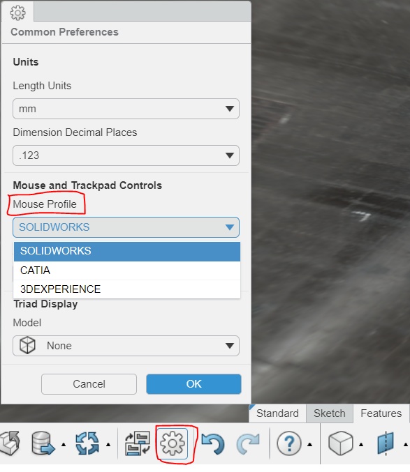

1. I can say that someone who has used SolidWorks program can easily use xDesign. There's even a mouse profile setting in xDesign software for this. Thanks to this setting, you can choose one of the 3DEXPERIENCE, SOLIDWORKS and CATIA options and use it with the mouse settings of the CAD programs you are used to before.

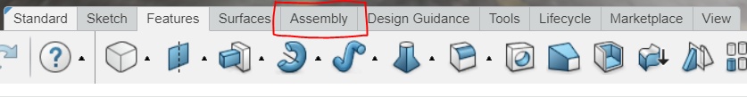

3. xDesign gives you the ability to design and assemble in the same environment. In this way, you do not need to switch to an assembly environment after making your design. You can continue with the assembly step from the same environment and call the parts you have designed for assembly from the same screen.

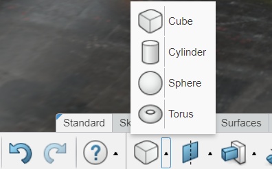

5. xDesign lets you create ready-made solid shapes. When we are going to create a solid object, we can create cubes, cylinders, spheres and toruses without any drawing with this feature. For example, we decided to create a cube. We can determine the height, width and length of the cube. This feature provides great convenience, especially when used on a tablet.

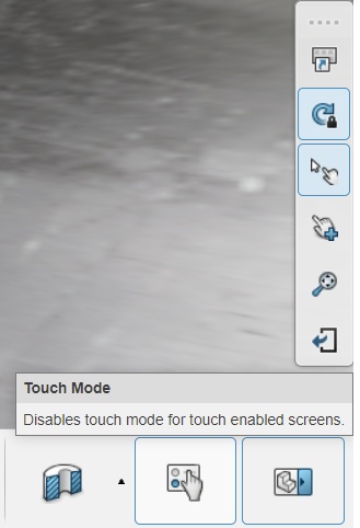

7. I said xDesign can be used on phones and tablets. But it also has a nice feature for touch screen devices. When you switch to touch mode, a new tool appears on the screen and you can perform various operations with this tool as easily as you do on your computer. For example, we hold down the Ctrl key while making multiple selections on the computer. In touch mode we can do this with Multi Select. Or we can lock the rotation so that the view does not move in the drawing environment. In touch mode, commands increase in size and provide ease of use.

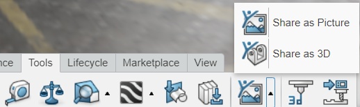

8. When you make a design in xDesign, we can share it directly with the community, both as a painting and as a 3D model. If you have a team and have a private community, you can share your design in your community and get ideas from your teammates.
