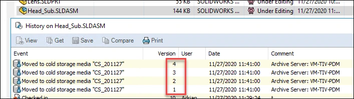

Cold storage in the SOLIDWORKS PDM software allows you to set up a scheduled operation that deletes or moves older versions of files from the file vault archives to free up disk space in the archive storage location.

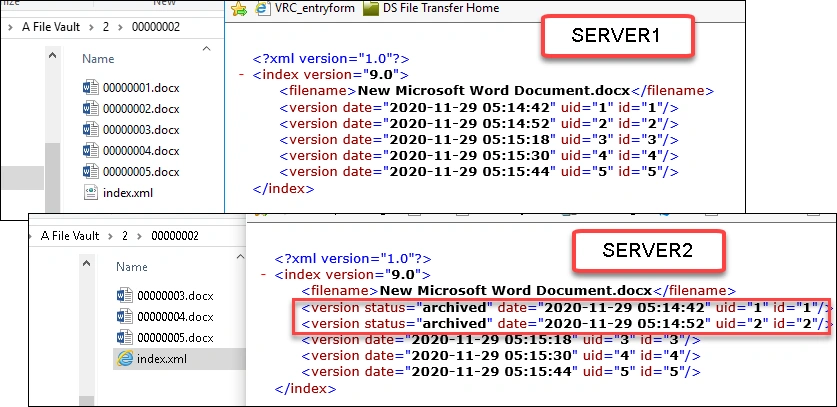

  • In a replicated environment, cold storage operations are set up per individual archive server. This makes it possible to implement cold storage only on one out of multiple servers. However, versions that are cold stored would not be accessible from client computers attached to that server.

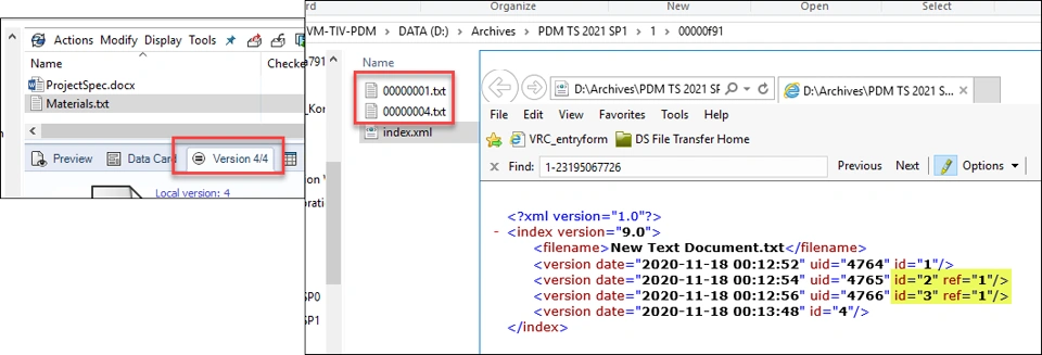

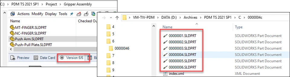

When you check out, modify, and check in a file, SOLIDWORKS PDM creates a new version of that file. All file versions that have changes to physical content are stored in the file vault archives. Each physical file in the file vault has a unique file archive folder ID where the individual versions are stored. Within the file archive folder, one or more physical files are stored with the version number as the file name. For example, version 1 is stored as 00000001.ext, version 5 as 00000005.ext, and so on.
The following image shows a file that has six versions and the vault view will have a file archive that contains one or more of the six versions.
that have the same physical content as the previous version, the file archive index.xml file instead stores a reference pointer to the previous version, saving disk space. This means that while a file may have 10 versions, the archive might only contain five physical version copies instead of all ten.
The next image shows a file that has four versions. The file archive contains the physical versions 1 and 4. Versions 2 and 3 have the same physical content as version 1, and have a reference pointer to this version instead.

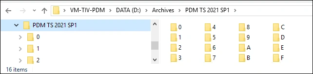

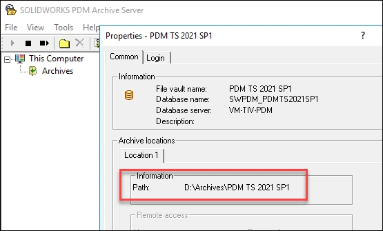

The archive server service manages the file vault archives. The file vault archives consist of an archive folder with the same name as the file vault name, and (normally) 16 subfolders named 0 (zero) through F. Each file archive is stored under one of the 16 subfolders depending on the archive folder ID.

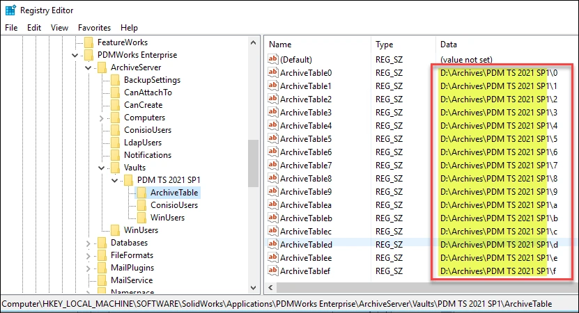

If you are unsure of the location of the vault archives on the archive server, you can use the archive server configuration tool. Expand the root folder in the left-hand tree, right-click the vault name and then click Properties. If the archives are split up or relocated, they may spread over multiple locations.
You can also view the ArchiveTable registry key for the location of the archives:
HKEY_LOCAL_MACHINE\\SOFTWARE\\SolidWorks\\Applications\\PDMWorks Enterprise\\ArchiveServer\\Vaults\\[VaultName]\\ArchiveTable
Incorrectly editing the registry can severely damage your operating system. The SOLIDWORKS Technical Support team strongly suggests that you back up the registry data before making any changes to the registry.

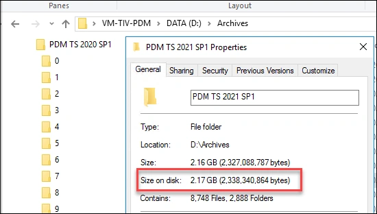

To find how much space the physical vault archives take up on disk, view the properties of the main archive folder of the vault.

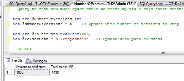

4) How Much Space Does Cold Storage Save?
The amount of disk space that cold storage frees up varies greatly depending on how many file versions you maintain in the file archives, and on what folders are included in the cold storage schemas.
To get a rough estimate of the potential space that cold storing a specific folder will free up, refer to the SQL report in SOLIDWORKS Knowledge Base QA article QA00000114280. The report shows the amount of space possible to free up if physically storing all versions in the archive folders, based on the file size registered in the database. Be aware that the actual size on disk could be less depending on reference pointers, or if files are compressed, etc.

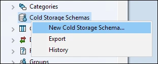

To configure the cold storage schemas, use the administration tool on a client computer.
Log in to the vault in the administration tool as a user that has administrative permission to update cold storage. Right-click the Cold Storage Schemas node and then select New Cold Storage Schema.

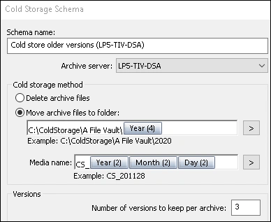

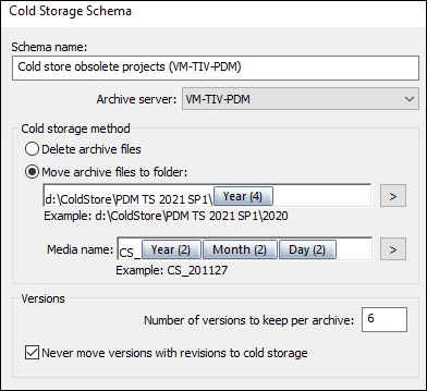

The Cold Storage Schema dialog box appears, from which you can configure how the cold storage operation works.
a) Assign a Name
Give the new schema a name that makes it easy to identify. If you are configuring cold storage in a multi-server replicated environment, it is a recommendation that you include the archive server name in the cold storage schema name because schemas are server-specific.

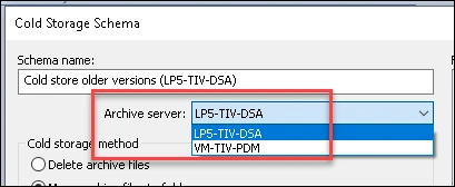

b) Select a Server
Select the archive server to which this cold storage schema applies. The schema is specific to the selected server. If the vault is replicated, the menu shows the name of all archive servers that are replicating the vault. Make sure to select the correct server.
If you are modifying an existing schema, always ensure to select the correct archive server before saving and closing the dialog box.
c) Cold Storage Method
This option controls what the cold storage operation does with the older file versions. Cold storage can either Delete the versions, which is irreversible, or Move the versions to a location outside the archives for cold storage. The recommendation is to use the Move option because you can recover a moved file if available.

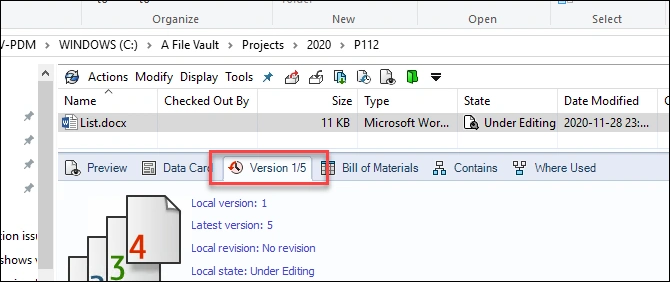

  1. A file archive has six versions of a file.
  2.
    the three oldest versions of this file.
  3. The physical versions 1, 2 and 3 are deleted from the file archive and are no longer available. This leaves versions 4, 5 and 6 still in the archive folder.

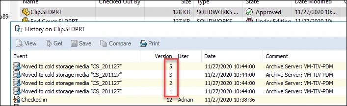

  2. You run a cold storage operation that moves the three oldest versions.
  3. Versions 1, 2 and 3 are moved from the file archive into the cold storage folder. Versions 4, 5 and 6 remain in the archive folder.

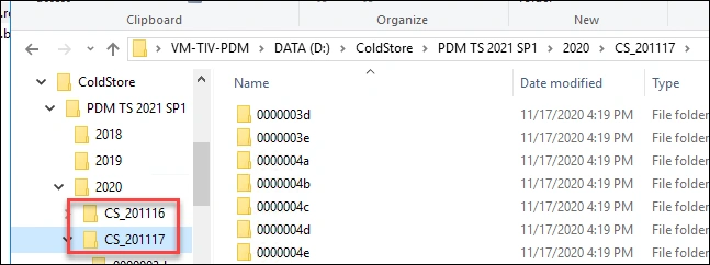

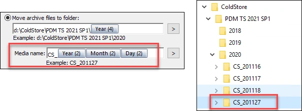

d) Output Path For Moved Files
When cold storage moves older file versions, the operation places them according to an output path you define in the schema by entering a folder path and a media name. The complete path can contain dynamic values such as the year or date that change depending on when the cold storage schema runs.
Considerations about the output path:
  • The complete output path (output folder + media name) must contain only characters
    that the Windows® operation system accepts as valid. A backslash (\\) indicates a
    subfolder
  • In the ideal case, the output path is a locally attached drive to the archive server where the cold storage schema runs.
  • If you want to output to a network share, use UNC formatted paths. Cold storage does not support network drive mappings because the archive server service cannot access them. See section 11 for more information about this.

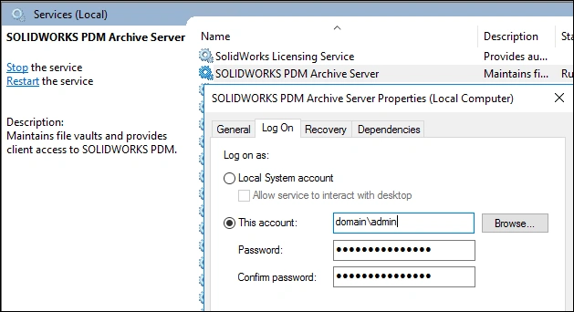

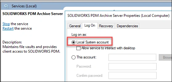

  • The archive server service must have read and write permission to the output path that is defined in the cold store schema. Both to create new folders and to create or copy new files. In the default installation, the archive server service under the System account, which normally has sufficient permissions to access local drives. If cold storing to a UNC network share, it is a good practice to change the logon account for the archive server service to use a domain account with access to the share. To run the service, the logon user must also have local administrative permissions.
  • It is extremely important to ensure that the hard disk drive or storage location for the output path has sufficient free space to store the cold stored versions. Confirm this before configuring the cold store schema because running out of disk space could lead to failure to move versions and in worse cases, to become lost.
Folder
The folder field defines the parent output path under which each cold store media folder is created later. The output path should contain the drive letter (or the UNC path if using a network share). You can add dynamic values by clicking
folders for the cold stored versions under the main folder.
Media name
The media name defines the subfolder to which the cold stored archives are moved. It should be a single folder name (without drive letter). You can add dynamic values by clicking
into the media folder, and then creates a folder with the archive ID and moves the cold stored versions into the folder.
e) Versions
The Versions group specifies the number of versions to cold store (delete or move). The specifications apply to all files under the specified vault folders that are part of the schema.
Number of versions to keep per archive
In this field, enter a positive version number one or higher.
The number specified is the number of versions to keep in each file archive, counting backwards from the latest version of each processed file.
The number of physical versions stored in the file archive folder, is irrelevant. There may be fewer physical versions. In cases where the physical differences between two versions are the same, the archive server stores a version pointer to the previous version. With a replicated archive folder, it is possible that only some of the total number of versions are replicated.
It is not possible to cold store the latest (topmost) version of a file.

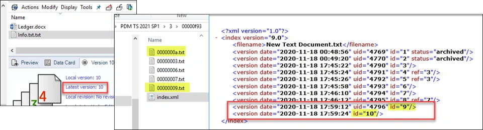

Consider the following example.

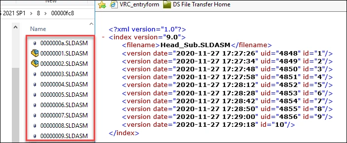

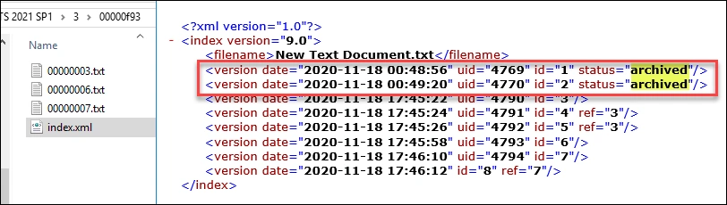

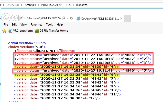

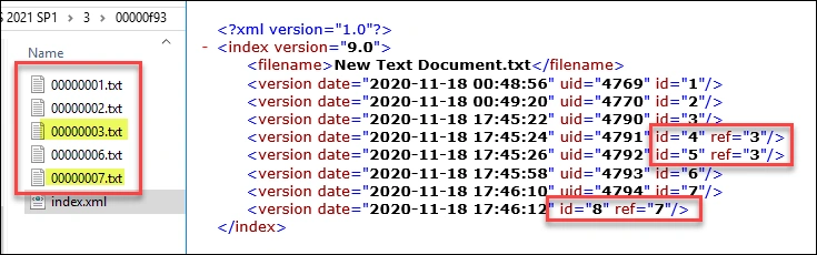

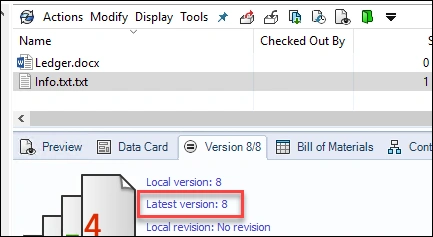

  1. This text file has eight versions in the file vault.
  2.
    , 5 and 8 are identical to the previous version and instead of storing the physical file as a file; the index.xml file contains a reference pointer to the previous matching version. In other words, version 8 has the same content as version 7 and therefore references version 7 (ref=”7”).
  3. The cold storage schema configuration keeps six versions per file.
  4. When the cold storage schema runs, the operation cold stores any version older than the six most recent versions. Versions 1 and 2 become cold stored (eight versions minus six to keep means that the two oldest versions are cold stored).
  5. Versions 1 and 2 are removed from the file archive folder, leaving three physical files.

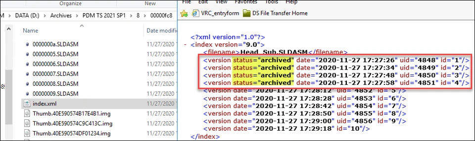

    The index.xml file shows status=”archived” for the cold stored versions.
  6. If you create two more versions for the file, the latest version now becomes ten. The
    version number for the physical file in the file archive uses a hexadecimal value (10
    Decimal = A Hexadecimal).
7. The next time the same cold storage schema runs (to keep six versions); versions 3
and 4 of this file are also cold stored. (ten versions minus six versions to keep, means
that the four oldest versions are now cold stored).
8. In the file archive, the index.xml shows four archived versions.
9. The cold store output location now contains the four moved versions.

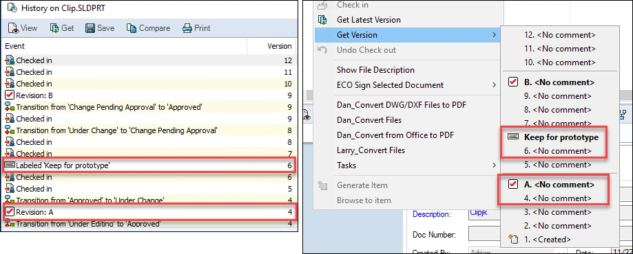

Never move versions with revisions to cold storage
When this option is active, the cold store process skips any version that has a SOLIDWORKS PDM revision or a label that links explicitly to the version.
Normally, you want to get those versions that have revisions. Therefore, it is best to activate this option always.
  1. A file has 12 versions in the vault.
  2. The cold storage schema configuration keeps the six most recent versions and the Never move versions with revisions to cold storage option is active.
  3.
    through 6 (12 versions minus six versions to keep means that the six oldest versions become cold stored). However, version 4 has a revision (A) and version 6 has a label (“Keep for prototype”).
  4.

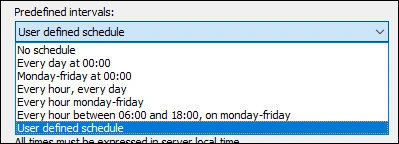

You can select from a list of predefined interval strings.
You can also specify a custom interval by selecting the User defined schedule option.
The interval string consists of three parts in the form: minute hour weekday. You can use an asterisk (*) character as a wildcard and a minus (-) character for a range.
  • Minute: Defines at what minute of the hour the schema runs. The acceptable values are 0 (on the hour) to 59.
  • Hour: Defines at what hour of the day the schema runs. The acceptable values are 0 (for midnight) to 23 (11pm).
  • Weekday: Defines on what day of the week the schema runs. The acceptable values are 1 (Monday) to 7 (Sunday).
Examples:
  • 0 18 6 The schema runs every Saturday (6) at 6 pm (18) on the hour (0)
  • 0 23 1-5 The schema runs every Monday (1) through Friday (5) at 11pm (23) on the hour
  • 30 20 * The schema runs every day (*) at 8.30pm

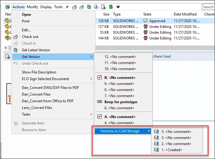

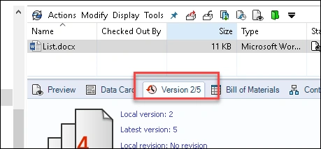

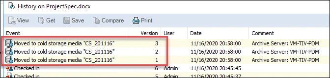

6) What Happens During the Cold Storage Process
A cold storage operation consists of the following four basic steps:

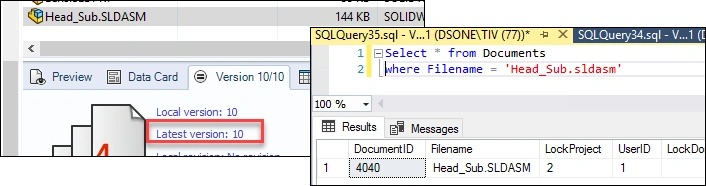

The following example shows the detail of what happens on the archive server and in the database when a file is cold stored.
  1. A cold storage schema specifies to keep the six most recent versions and to move older versions to a cold storage folder.
  2.

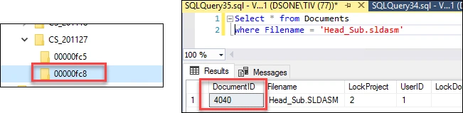

    value of 4040 in the database. The archive folder storing the versions is 00000FC8.
  3.

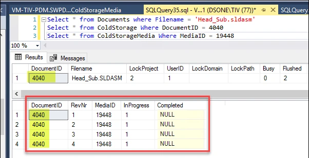

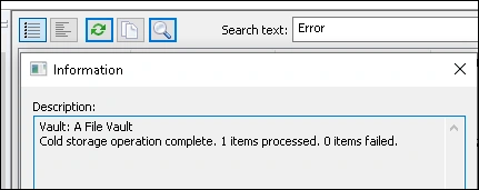

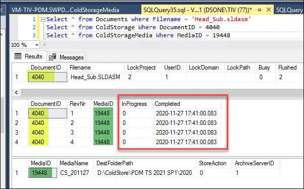

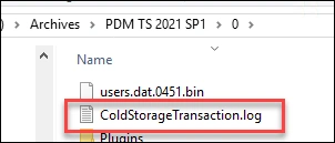

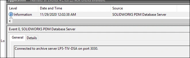

  4. The schema runs at the defined interval. The archive server contacts the SQL server and gets a list of files and their versions from the vault database to process.
  5. The DocumentID and version numbers of the files to process are added to the ColdStorage table. While in process on the archive server, the InProgress value is 1 (true) to indicate that the files are being cold stored.
6. The list of files (to process) is written to a temporary work log called with the name ColdStorageTransaction.log that exists in the ..\\0 folder in the vault archive. This file only exists while the cold storage process is running. When the process is complete, the file is deleted. If the archive server service restarts during a cold storage operation, the cold storage process resumes based on the current progress in the ColdStorageTransaction.log file.

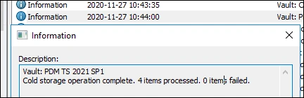

7. The archive server service then continues processing all entries in that log until complete.

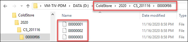

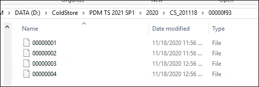

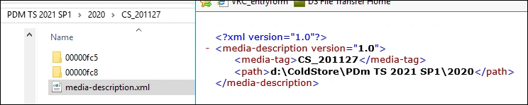

8. The process creates a media folder in the output path.
9. The process generates an XML file with the name media-description.xml within the
media folder. This file contains the name and path of the cold storage media. This
helps to identify the media folder at a later point when it has moved to remote media.
10. For each file archive that has versions moved by cold storage, the cold storage process
creates a folder with the archive ID of the file under the media folder. In this example,
the folder has the name 00000FC8 (matching the DocumentID 4040).
11. The file versions that are cold stored, in this case the four oldest versions (10 versions
minus six versions to keep means that the four oldest versions are cold stored) are
moved from the file archive folder to the archive folder with the same name in the
media folder. The moved versions do not have an extension. The name reflects only
the version number.
12. The index.xml file is updated in the original file archive folder with a
status=“archived” entry for the cold stored versions. This indicates that these
versions are no longer available in the file archive folder. Be aware that the archived
status also shows for cold stored versions that are deleted instead of moved.
13. After processing all entries in the ColdStorageTransaction.log file, the archive server
contacts the SQL server and updates the vault database with the result. The process then deletes the log file.
14. In the ColdStorage table of the vault database, for each successfully cold stored
version, the InProcess value displays 0 (false) and the Completed value displays the
time that the cold storage process completed. Note that timestamps in the database are always in UTC format. The MediaID value is a reference to the ColdStorageMedia table, which contains the media and server information. The StoreAction value of 0
means that the versions were moved. A value of 1 means that the versions were
deleted.

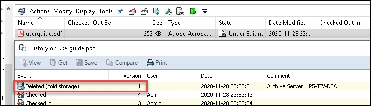

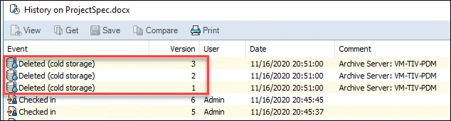

15. The archive server log adds an entry each time a cold storage schema runs and lists how many items (versions) were processed.
16. The file history of a processed file shows which versions are cold stored, the media
name, if the version was moved or deleted, and which archive server cold stored the
file.

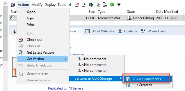

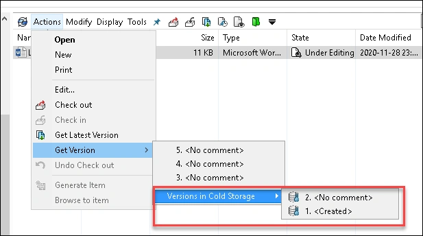

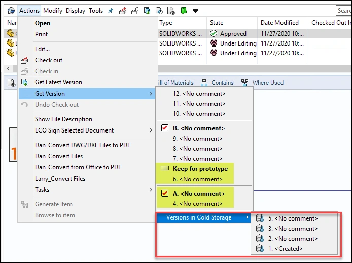

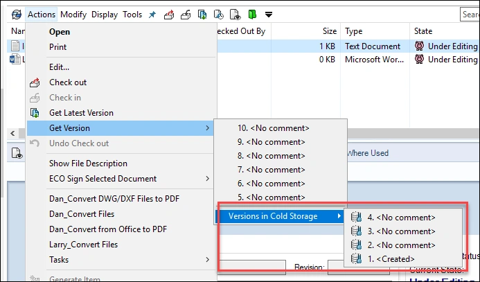

7) How Do I know If a File Version Is Cold Stored?
a) Individual Files
In the file vault, you can see which versions of a file are cold stored from the Get Version menu. All cold stored versions appear in the Versions in Cold Storage submenu.
The file history also shows an entry for each cold stored version with details about the server and media folder to which it is cold stored.

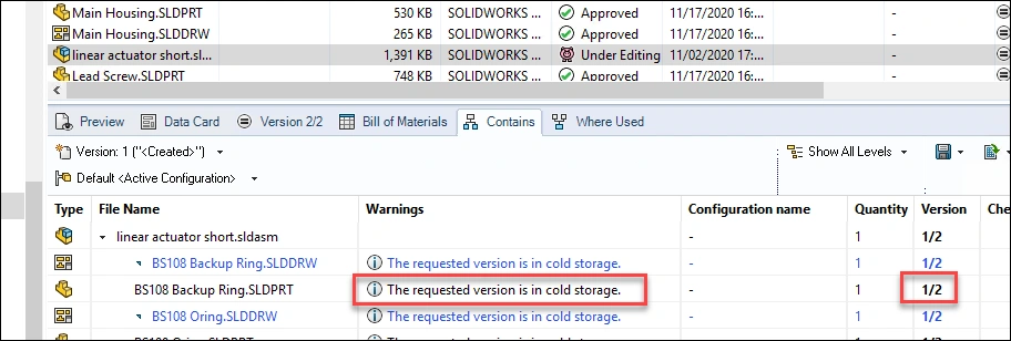

b) Files With References
If the attached version of a referenced file is cold stored, the Contains tab displays a warning that the version is in cold storage.
The Get version dialog box also shows a warning if the get operation tries to retrieve a cold stored version.
If cold storage deleted the referenced file version, it is not possible to cache that version and you have to get a more recent version instead. If cold storage moved the requested version, you must recover the version before it can be cached on the client computer.

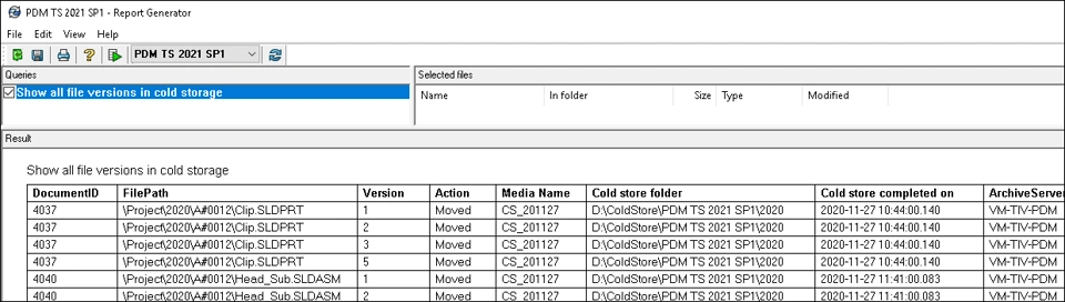

8) List All Files That Were Cold Stored
Refer to the SOLIDWORKS Knowledge Base article QA00000104971 for a report file that you can use to list file versions that are cold stored in a vault.

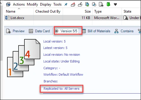

9) Cold Storage in a Replicated Environment
Cold storage schemas are specific to an archive server. In a replicated environment, you select which archive server to which the cold storage schema applies. You need to define one cold storage schema per server. To help identify which schema belongs to which server, it is a good practice to include the server name in the cold storage schema name.
For the servers that replicate the version, but do not cold store it, you can retrieve the version to the local vault view from a client computer that is attached to that server.
If a version is cold stored before replication to another server, it cannot be replicated. Scheduled replication excludes cold stored versions. On-demand replication opens the Get from cold storage dialog box from which you can restore the version on the remote server for subsequent replication.
  1. A file that has five versions is replicated between two servers.
2. A cold storage schema keeps three versions and moves older versions to cold storage on the second server.
3. The cold storage schema runs and cold stores versions 1 and 2 (five versions minus
three versions to keep means that the two oldest versions will be cold stored). The
history shows the archive server on which the version is cold stored.
4. The physical archive folder on the first server still has all five versions. The same
archive folder on the second server on which cold storage ran has versions 1 and 2
cold stored.
5. The Get version menu shows the two versions as cold stored because the list shows
the global cold storage information about the file versions and cannot differentiate the
server to which the client computer is attached.
6. However, a client computer with a local vault view attached to the first server where
the file version is not yet cold stored can still retrieve the version marked as cold
stored on the second server.
7. Caching the same version on a client computer with a local view attached to the
second server (where the version is cold stored) fails and instead displays the Get
From Cold Storage dialog box.

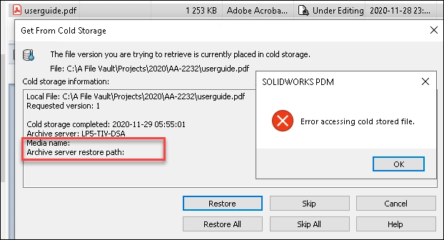

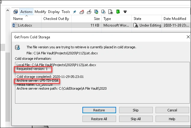

1. From the Get Version menu or the Get option in the file history, select the cold
stored version to restore
2. The Get From Cold Storage dialog box shows that the requested file version is cold
stored and displays details about the server and media folder name to which the
version is cold stored (moved).
3. On the archive server where the file is cold stored, an administrator needs to copy the media name folder back to the archive server restore path from the cold storage media (if it was moved to an external media).
4. In the Get From Cold Storage dialog box, click Restore. This action copies the cold
stored version back to the file archive folder.
5. The “archived” status is removed from the index.xml entry for that version.
6. The restored version is retrieved to the local cache on the client computer.
7. The file history shows an entry that the version was restored.

Use the manual method only if the built-in restore option does not work. Make sure that you back up the database before making any modifications in the database.
For instructions about how to manually restore a version in cold storage, see the SOLIDWORKS Knowledge Base article QA00000112306.

If you set up a cold storage schema but the schema does not start, verify that the
SOLIDWORKS PDM database server service (ConisioDbServer.exe) is running and
can connect to the archive server to which the schema applies. is running and can connect to the archive server to which the schema applies.
The database server service is responsible for announcing schema changes. However, if the service cannot communicate with the archive server, the change does not take effect.
The Windows application log shows an event if the service connects to each archive server on startup.
If the database server service succeeds with updating the archive server, a log entry in the archive server log shows Reloading cold storage schedules and includes a timestamp matching the time of the schema update.
Restarting the archive server service ensures that the latest cold storage schemas are loaded.

  • Make sure that the archive server service has access to the schema output path. If using a UNC network share, make sure that the archive server service runs under an administrative account with permission to read and write to the share.
