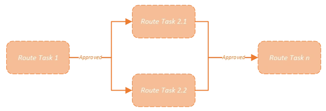

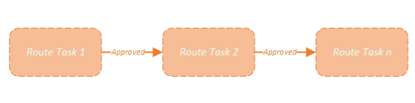

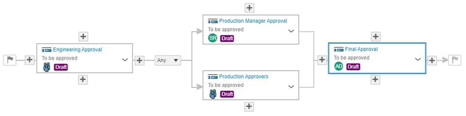

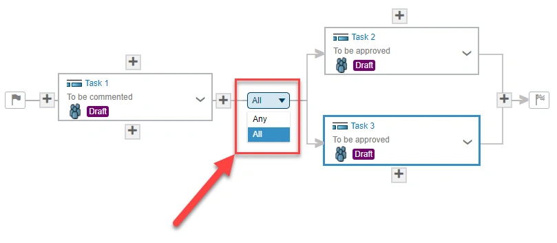

Tasks in a route can be either serial or in parallel.
In a serial route, the tasks run in a chronological order, meaning that Route Task 1 must complete before Route Task 2 can begin. The image above gives an example of approval tasks, though the same principle applies to tasks that specify Comment. Tasks that specify Notify Only send a notification to the people assigned to the task and then automatically complete the task and proceed to the next task in the route.
It is possible to set up parallel tasks in two ways so that either:
  • Both tasks must complete for the route to proceed, or
  • Only one of the tasks must complete for the route to proceed.
The user specifies this behavior when setting up the tasks for the route.

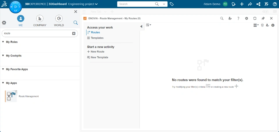

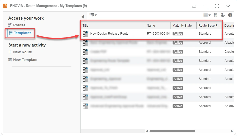

Use the Route Management widget to create route templates. As an example, this document sets up a basic route template for creating, reviewing and approving a new design. The new route template consists of three tasks: Design Work, Design Review, and Design Approval.

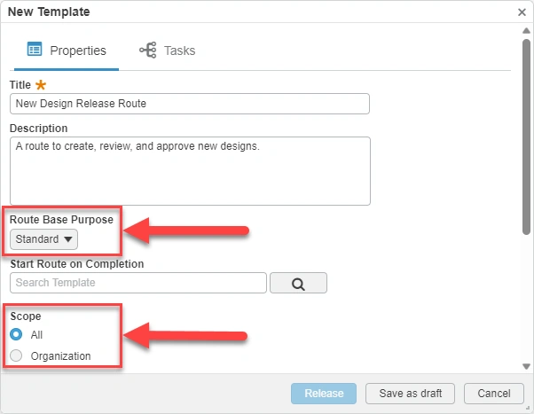

To create a route template, in the Start a new activity section, click New Template.
In the dialog box that appears, enter a title for the route template and add a description that explains the purpose of the route. Because the template will have three different tasks, of which the Expected Action option for two tasks specifies Comment and for one task specifies Approve, the Route Base Purpose option specifies Standard. A Standard route template can contain several different types of tasks (Approval, Comment or Notify Only).
If the task specifies Approval, then the route can only contain approval tasks. Likewise, Review routes can only contain review tasks.
Because this template will be the standard process for reviewing and approving a design, the Standard base purpose is most appropriate. Also, the Standard template covers everyone on your 3DExperience platform. To also enable external users to be part of the tasks within the route, the Scope specifies All.

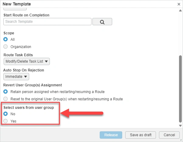

Scroll down in the New Template dialog box and ensure that the Select users from user group option specifies No, which allows any user from a specified group to take ownership of the task. If the option specifies Yes, then a specific user must be assigned before the route can be started.

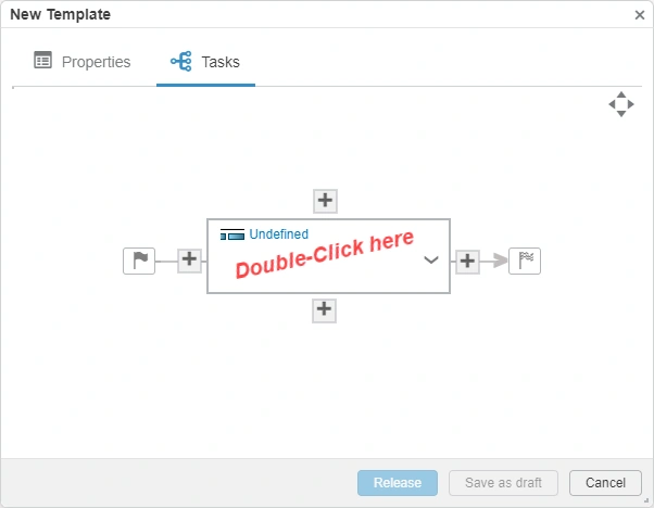

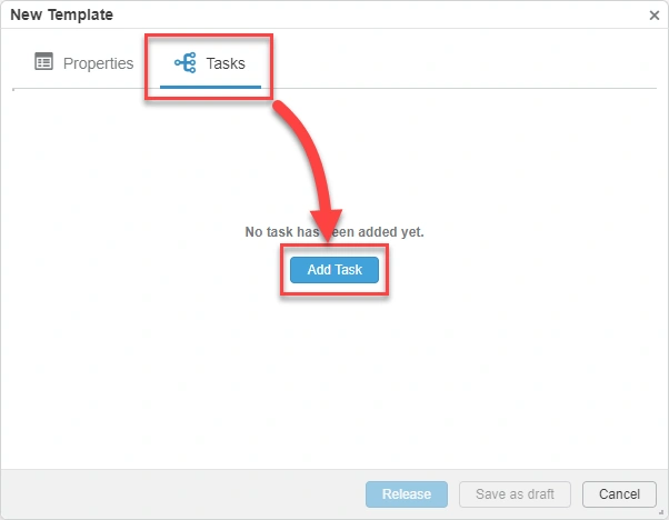

To add tasks to the route, scroll back to the top of the dialog box and click the Tasks tab. Then click Add Task.
This creates a task in the route. You must double-click the route to provide a definition.

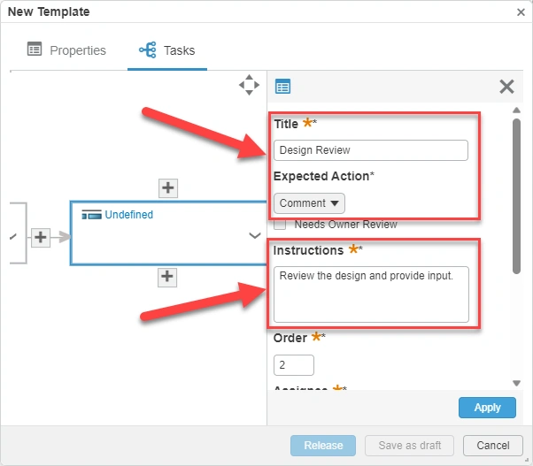

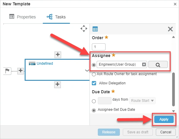

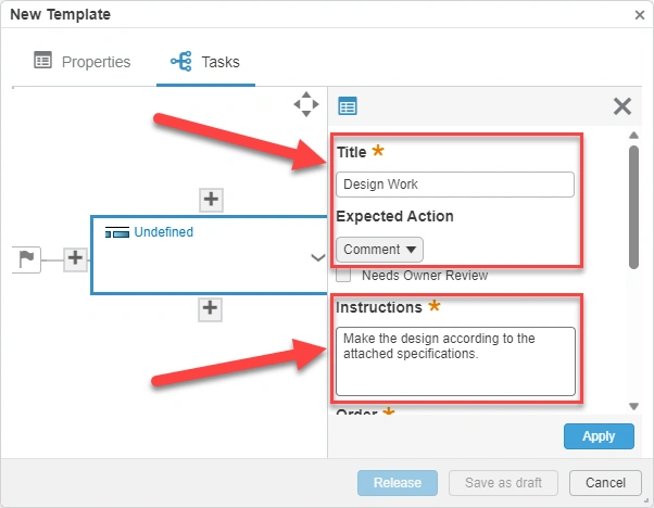

Add a title for the task, define the Expected Action option as Comment, and then add a description.

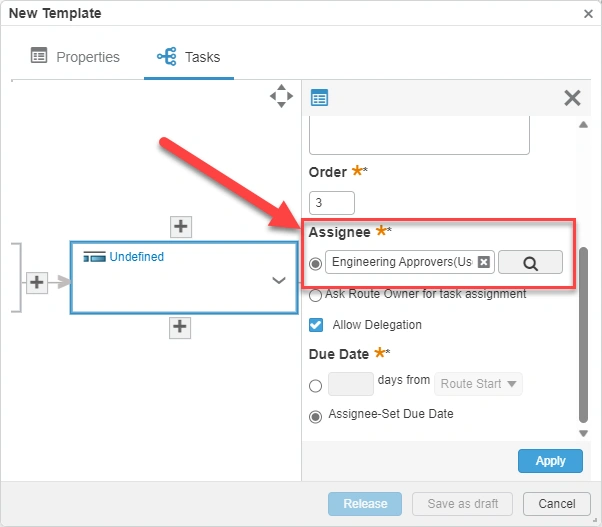

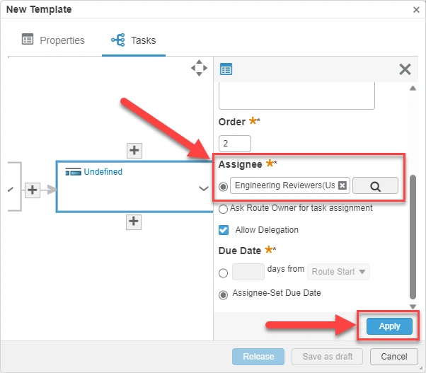

Scroll down and in the Assignee field, specify the user group that performs the design work. In this example, the user group is Engineers.
Be aware that for the Assignee, it is possible to select an individual instead of a user group.
Optionally, instead of preselecting an assignee, select the Ask Route Owner for task assignment option, which allows whoever creates a route from this template to select a specific person to complete the task.
To apply the information and finish setting up the task, click Apply.

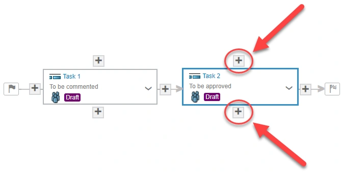

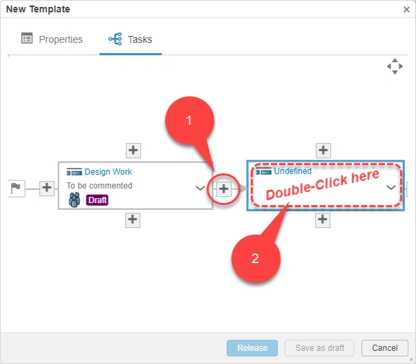

To add additional tasks, click the plus (+) icon at the right of the task just created to add another task after the first, then double-click the new task to open the properties pane.
In the properties pane, add a title and description, and ensure that the Expected Action option specifies Comment.
Scroll down the dialog box and define the assignee for the task, then click Apply. In this example, the assignee is the Engineering Reviewers user group.

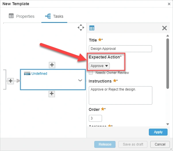

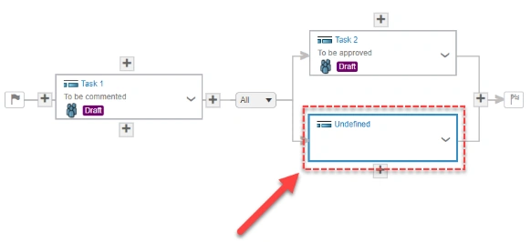

Once again, the click the + icon at the right of the Design Review task to create an additional task, access the task properties and enter a title and a description for the task.
The Expected Action option for this task is Approve because it is the final task in the route and the Assignee in this example is the Engineering Approvers user group.

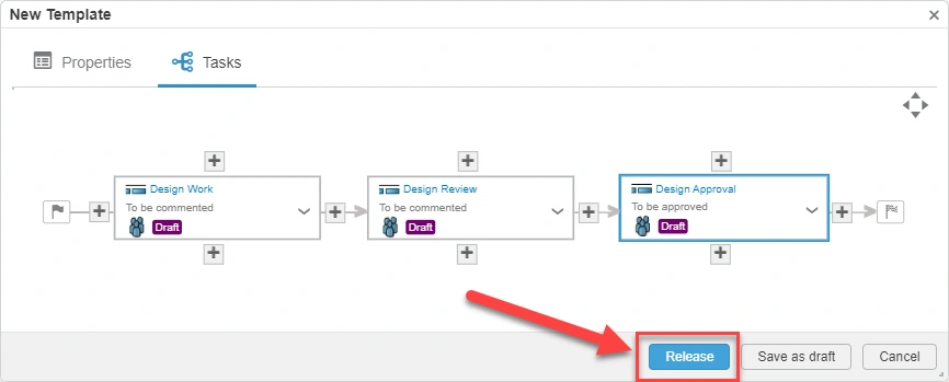

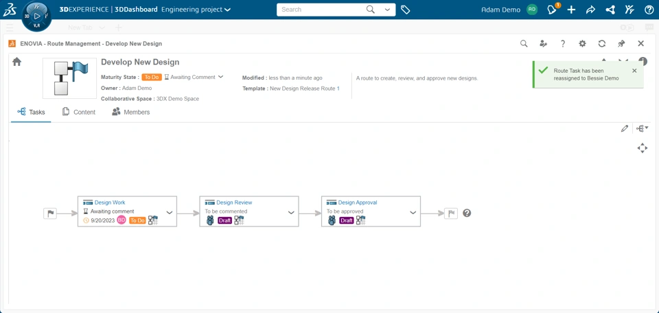

We have now created a route that consists of three serial tasks.
It is possible to create parallel tasks as described in section 3b. To do this, click the + icon above or below the task that should have two or more assignees. After setting up two or more parallel tasks, it is possible to select whether All or Any of the assignees of the task need to approve or comment for the route to progress.
The final step to make this route template available for use is to click Release to activate the route.

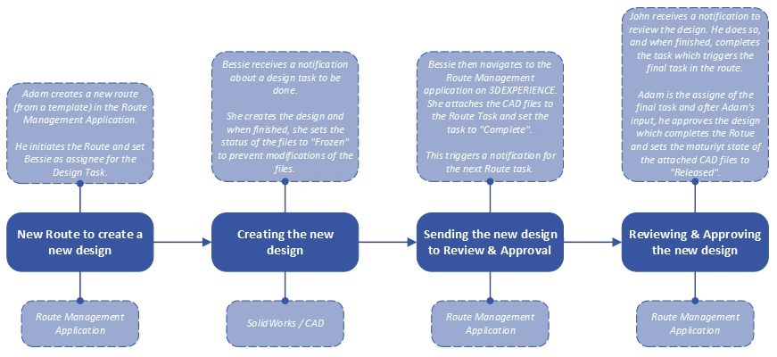

Use case A starts with Adam, the engineering manager, who creates a new route from a template with a task to create a new design. Adam assigns the task to Bessie (an external contractor invited to Adam’s tenet). Bessie then creates the design, attaches it to the route and completes the task. This in turn starts the downstream review and approval tasks.
John, a senior engineer, receives a notification from the system that the user group to which he belongs has a review task to complete. He takes ownership of the task and completes it, which moves the route to its final task.
As a member of the Engineering Approvers user group, Adam receives a notification that the user group has an approval task to complete. Adam takes ownership of the task and approves the design.
After completing the review and approval tasks, the design that Bessie created is promoted automatically to the Released maturity state.

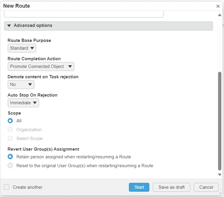

Adam then expands the Advanced Options section and defines the Route Completion Action as Promote Connected Object.

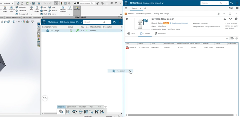

After defining the Route Completion Action as Promote Connected Object, the design that Bessie creates is promoted to the next maturity state automatically when the route is completed. Because the target maturity state is Released, Bessie must set the maturity state of the files to Frozen before setting the route task to Completed. This is appropriate because there should be no changes after completing the modifications.

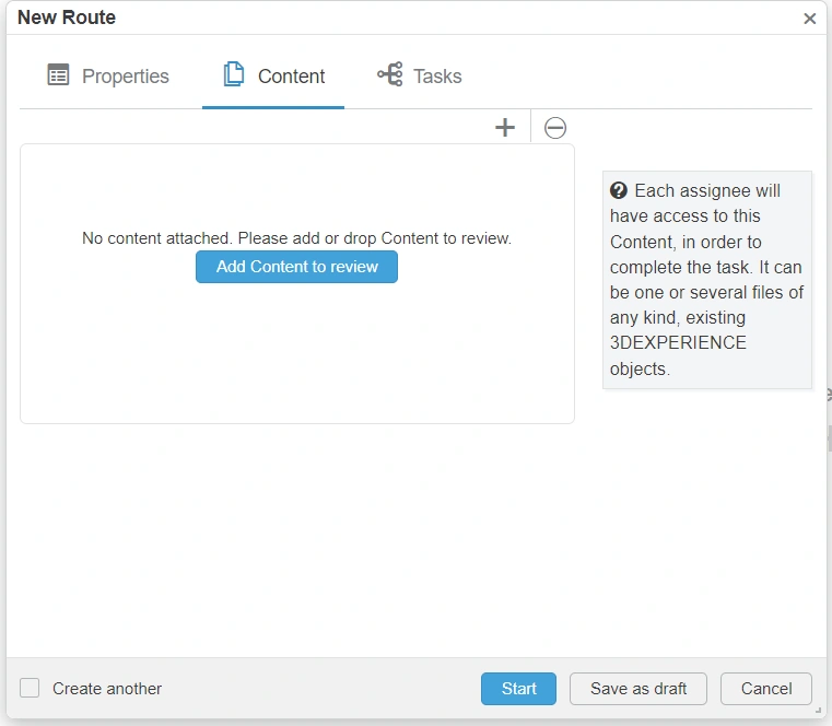

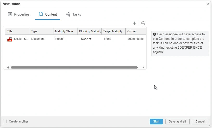

In the Content tab, Adam adds a document that describes the design task to perform.
When adding files to a route, it is possible to select whether or not to block the file from transitioning beyond a specific maturity state. Setting the Blocking Maturity to Released blocks the file from transitioning to the next maturity state after Released when the route is complete.
If the Blocking Maturity specifies None, there are no constraints to which maturity state the file can advance when the route it completed. The blocking maturity state of None appears by default if the user does not have permission to promote the connected object.

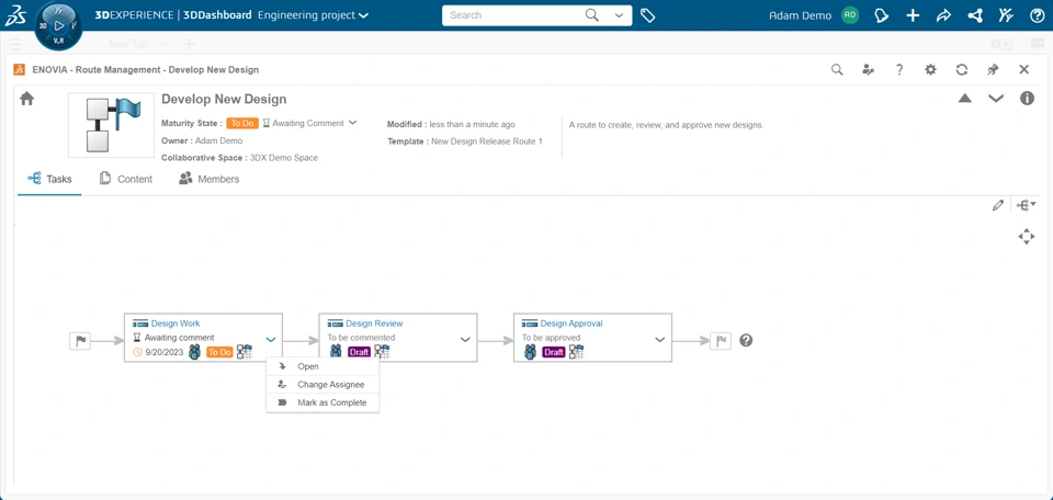

After starting the route, Adam goes into the task list of the route, right-clicks the first (Design Work) task and selects Change Assignee.
Next, Adam types Bessie in the “Search Assignee” field and adds her as an assignee for the task. As a reassignment comment, Adam types a message to Bessie and asks that she review the attached document for information about the design work. He then clicks OK to finish the reassignment of the task to Bessie.

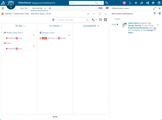

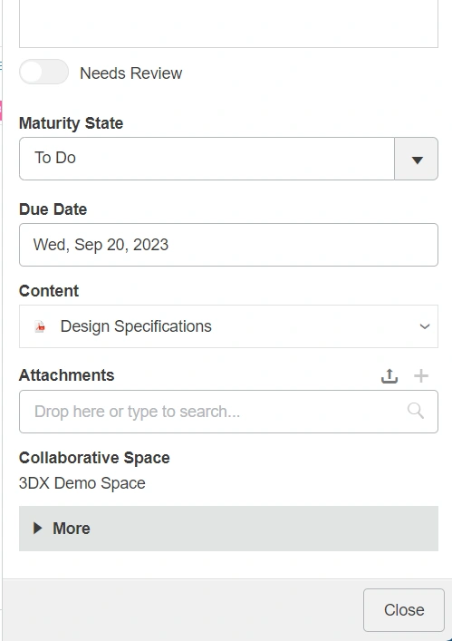

Tasks from a route appear in the Collaborative Tasks application with a unique icon (
After Adam assigns the task to Bessie, Bessie receives a notification along with a task in the Collaborative Tasks application with the title Design Work.
Selecting the task, Bessie sees information about the task and an attached document.

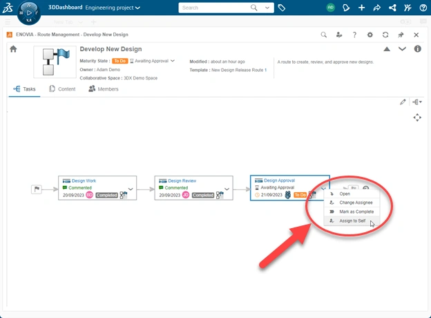

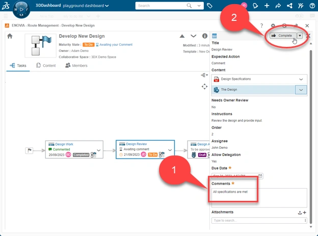

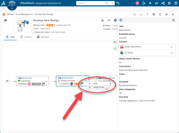

John next browses to the task and assigns the task to himself.
After reviewing Bessie’s design, John adds comments and then clicks Complete to finish the task.
After John completes the review task, the last task in the route begins and all members in the Engineering Approvers user group receive a notification about a task to perform.

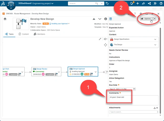

Adam, who is part of that group, sees the notification, goes into the route task list and assigns the task to himself.
He reviews the attached design from Bessie along and the comments that John made in the Design Review task, and then approves the work by adding a comment and clicking Approve.

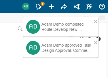

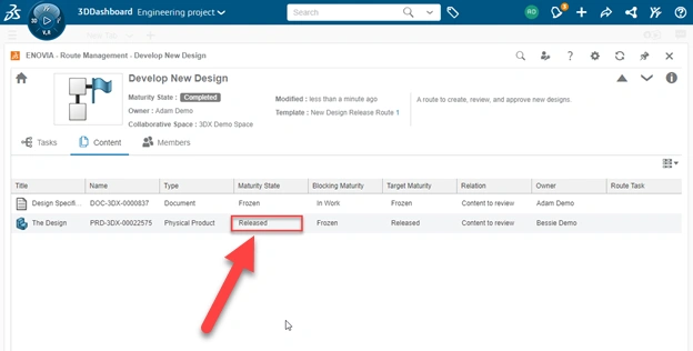

When Adam approves the task, the route is completed.
object was specified as the Route Completion Action during route setup, the CAD files from Bessie’s design are promoted to the Released maturity state automatically.

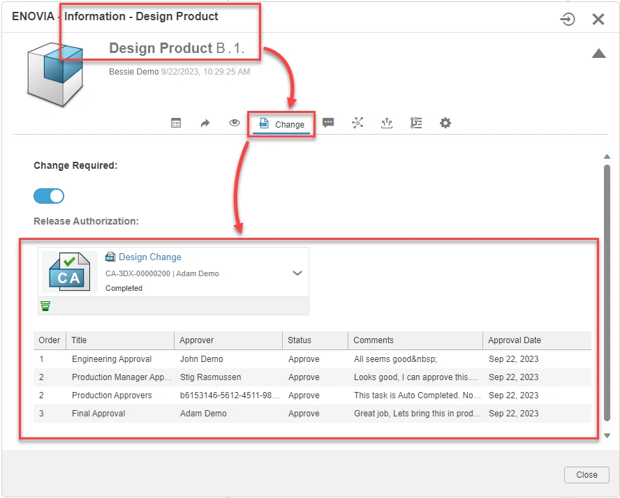

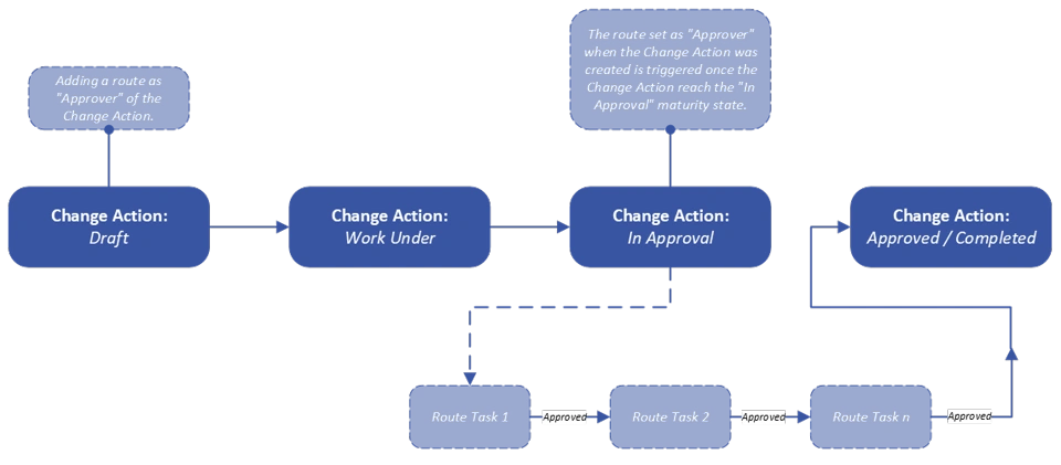

When using a route with a change action, as in Use Case B, then the route becomes one part of a bigger process instead of the entire process, as the next image illustrates. Because other guides cover how to work with change actions (for example the “Getting Started with a Formal Design Change Process Using Change Actions SolidPractices Guide), this SolidPractices guide focuses on the route itself and how to use it together with a change action.
A benefit of using a change action is that all files added or modified in the change process are automatically connected to the process. This differs from Use Case A in which the files had to be added manually. Further, the history of the files is available directly from the information pane of the file when managed through a change action. To get information about a file that was released through a route, you must review the route itself. Because of this, change actions are suitable for organizations that require a formal approval process where regulatory compliance and full traceability is a requirement.
In general, the change action provides more information. For example, it shows both the proposed and realized changes, whether the changes are connected to a bigger change process, dependencies or something else. For more information about this topic, review the SolidPractices guide: “Getting Started with a Formal Design Change Process Using Change Actions, which is available in the SOLIDWORKS News and Info community on the public 3DEXPERIENCE platform.

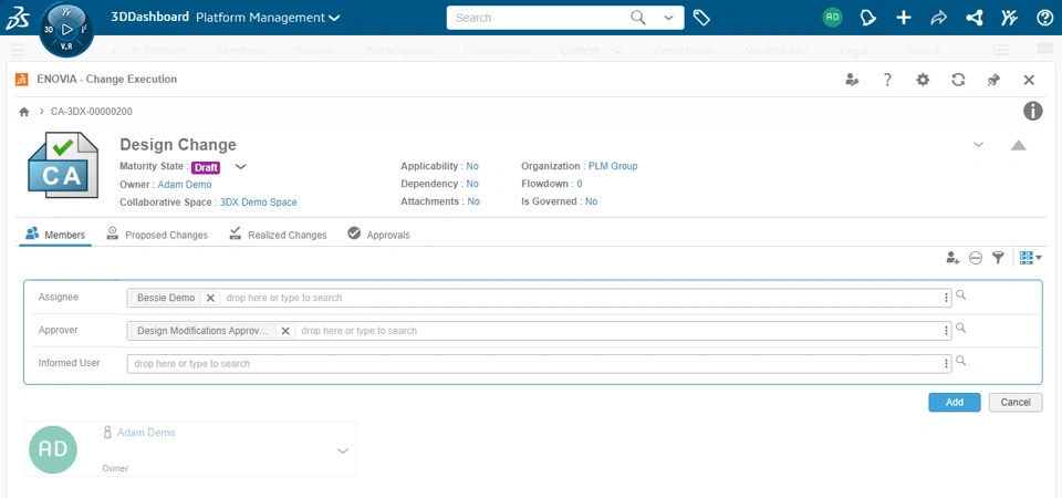

This use case describes how Adam, the manager, creates a change action with an assignment for Bessie to modify a design. To approve the design modifications, Adam adds a route as approver to validate the design in different stages. There is no need for production to validate a design if it does not pass the engineering review. Therefore, this case uses a route to ensure that the design is first approved by engineering, and then sent to production for approval to avoid giving them unnecessary tasks.
ii) The Use Case

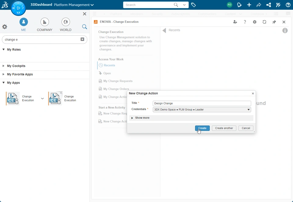

Adam clicks New Change Action to implement design changes to one of the company products.
route.

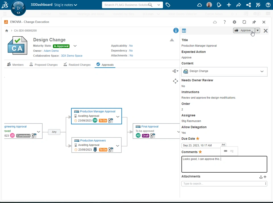

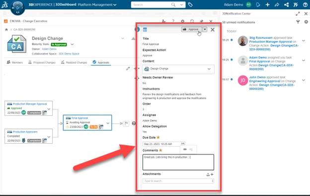

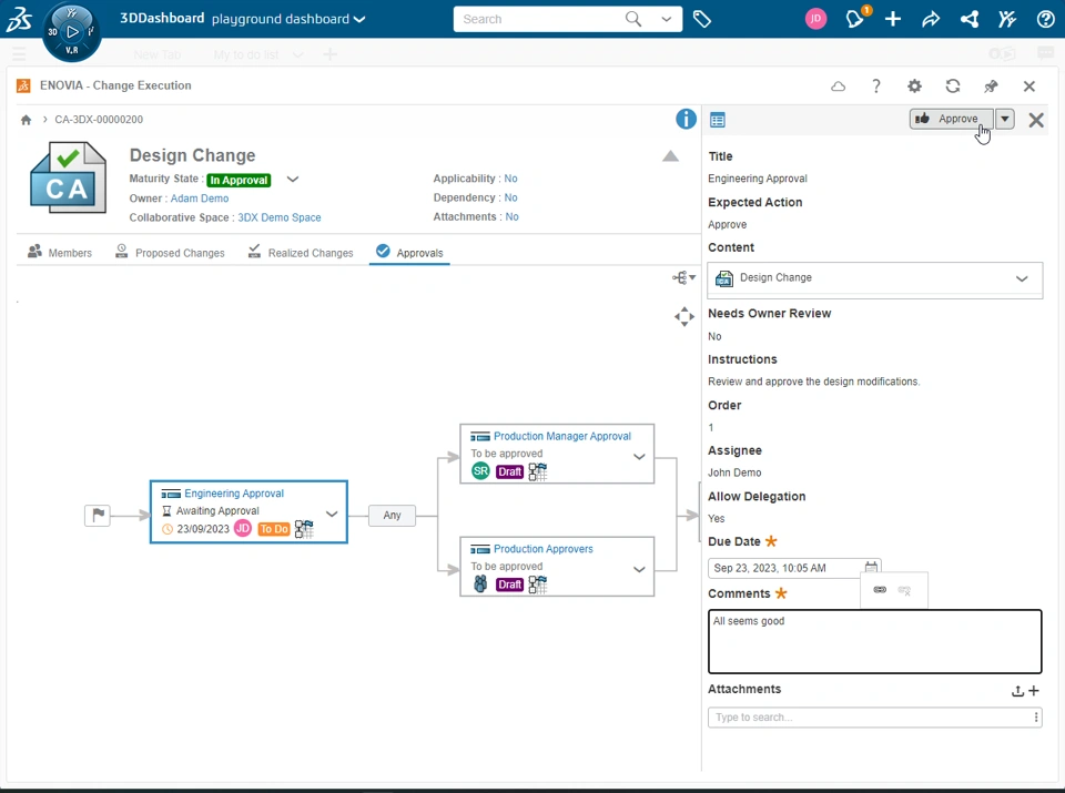

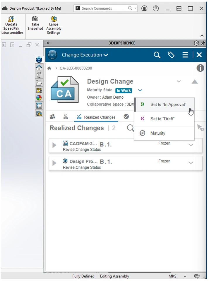

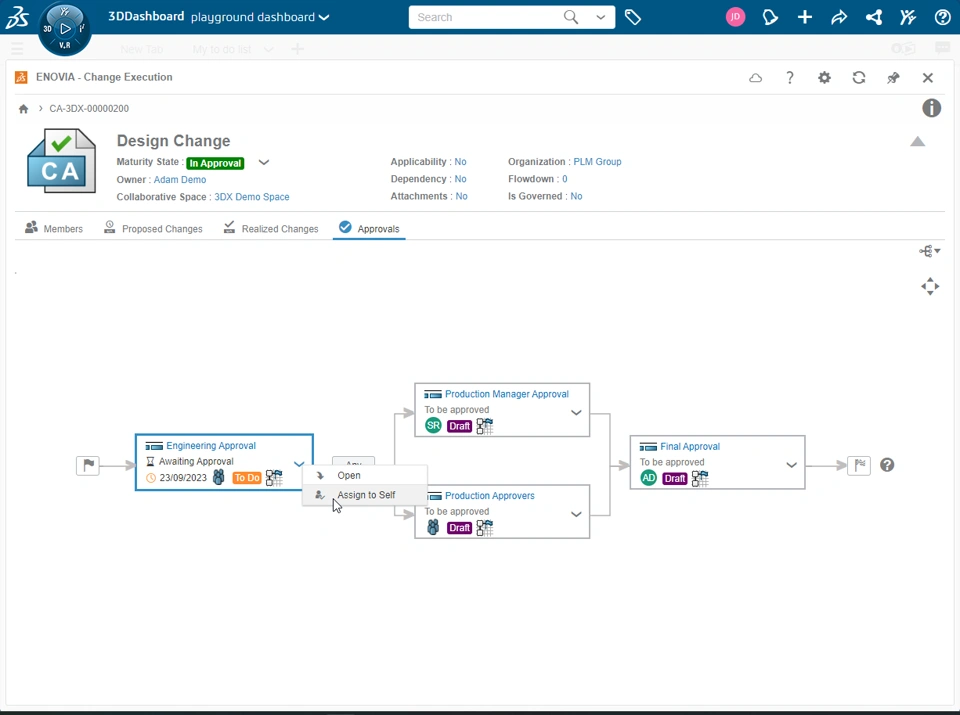

Be aware that any of the Production Manager approvers or Production Approvers can approve the design. Also be aware that for Engineering Approval and Production Approvers, the approvers are set to user groups, while the Production Manager Approval and Final Approval tasks are set to a specific user.

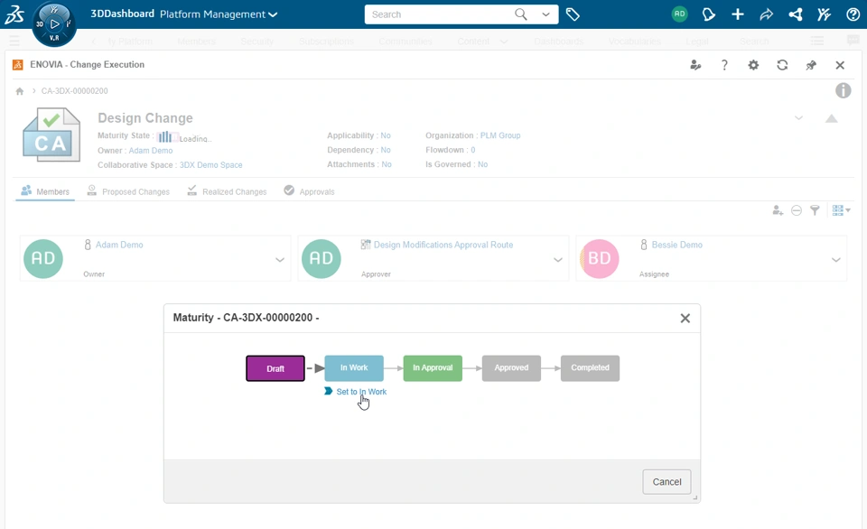

After setting up everything in the change action, Adam updates the maturity state to In Work to begin the work.

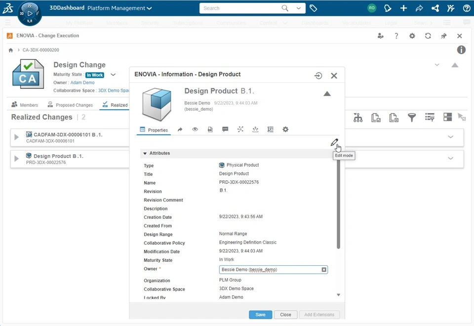

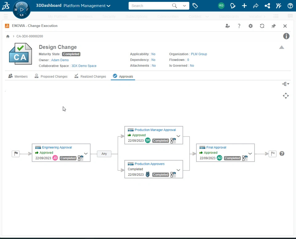

Adam changes the ownership of the new revised object to Bessie and unlock the file, so she can now work on it.

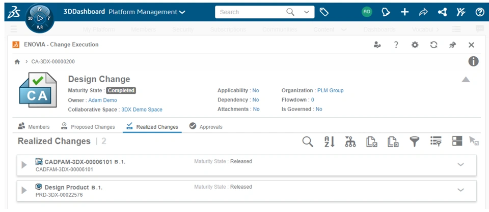

When all modifications are complete, Bessie sets the maturity state of the modified files to
and updates the change action to In Approval.
When the change action reaches the In Approval state, the route defined as Approver in the definition of the change action begins automatically and members of the Engineering Approval user group receive a notification.
John is a member of this group and after receiving the notification, assigns the task to himself and reviews the modifications by comparing them with the previous revision.
John sees that the modifications comply with the instructions and finds no other issues. Therefore, he approves the work, and the route continues with the next set of tasks in the task list.
The next set of tasks are two parallel tasks. The condition for these tasks is that any of them can be approved for the route to continue to the last Final Approval task. Because all members of the Production Approvers user group are away for training, Stig, the production manager, is aware of the situation, so he opens the task to review it. Stig finds no other issues with the modifications and approves the work, allowing the route to reach the final stage.
Adam is the assignee for the final task in the route. He receives the notification following Stig’s approval and accesses the task in the list to review it. Because none of the former reviewers found any issues, Adam approves the modifications.
After Adam approves the final task, the route is completed, which triggers the change action to become complete and the release the associated files (set to the maturity state Released).
To summarize, Use Case B uses a change action with a route for the approval process for design modifications. The procedure differs slightly compared to using a stand-alone route both in setting up the work in the change action, and in implementing the changes when working under change action.
The benefit for Bessie is that the system automatically attaches the files to the change action (the work order) so there is no need to remember this. Bessie can also conduct all the work comfortably from her familiar CAD tool. There is no need to switch between user interfaces.
From Adam’s point of view, he gets a good overview of the work that Bessie performed through the proposed changes section and assurance that all files affected by the changes are recorded in the work order.
