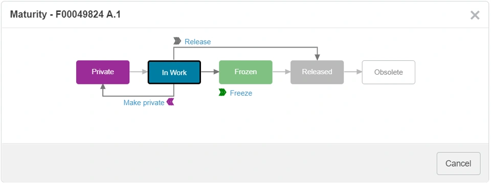

iii) Revisions relationship to the lifecycle
In the 3DEXPERIENCE platform, the revision process has different options. Depending on the setup, the lifecycle of an object and its primary and secondary revisions can vary.
  • Multiple revisions in the work
Depending on your configuration settings for your 3DEXPERIENCE platform, you have the ability to have multiple revisions that are in the In Work maturity state (state) of the lifecycle process. If it is possible to create a new revision from an In Work state, the option shown below is available. If it is possible to create a new revision only from a Frozen or Released state, then you do not have the option to create multiple revisions from the In Work state.
  • Best practices for lifecycles and revisions
When revising an object in the 3DEXPERIENCE platform, it is best to revise in a Released state. Having multiple revisions in an In Work state can lead to the overwriting of work. For example, Designer A is working on revision A for a part, and Designer B creates a new revision of the same part, now labeled with revision B. Designer B has the ability to make changes to the part and then release it; the same applies to Designer A. At this point, there could be multiple revisions that are released, but are different iterations of the same part. This can lead to confusion when other users attempt to use the part for a CAD assembly or production.
In addition, it is also best not to allow revision creation from a Frozen state. An object is typically in a Frozen state because it is under review. If there are modifications to that object during a Frozen state, the review becomes difficult for the approver because of the change in the state of the object. For the reviewer or approver to perform an accurate review of the proposed object, the object must remain in a Frozen state. If the approver rejects the changes to the object, they would move it back to an In Work state to allow further work, and then move it back to the Frozen state when the object is ready for review.
With regard to revisions, it is typical to create a new revision for an object that requires a major change. If a user opens an object that was modified and saved to the 3DEXPERIENCE platform, the Is Last Revision column displays a red X. This indicates that the user does not have the latest revision of the file open. In this case, the user can then right-click the object and select Reload from Server to load the latest revision. When making a change to an object, it is essential to save the object to the 3DEXPERIENCE platform even if not creating a new revision.

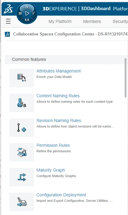

b) Revision Format
i) Revision naming rules options

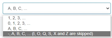

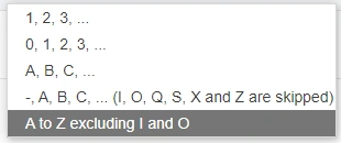

The 3DEXPERIENCE platform has two options, each with a second variant. The primary can either be numeric or alpha. If choosing a numeric option, you can either start at 1 or 0. If you choose an alpha option, you can have straight alpha letters such as A, B, C…, or you can begin with -, A, B, C… This scheme also skips I, O, Q, S, X, and Z.
Extended Revision Sequences offer flexibility to create a custom Revision Scheme tailored to your specific needs. A file is uploaded with defined rules that outline the custom sequence. Once uploaded, your custom revision scheme appears alongside any predefined schemes, making it easy to select and apply as needed. The following example adds an alpha option, excluding I and O.

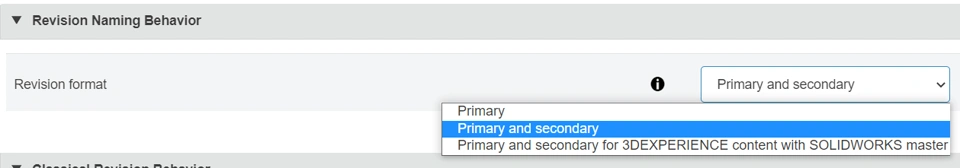

You can select the Revision format in the Lifecycle and Collaboration settings. There are three revision behaviors: Primary, Primary and secondary, and Primary and secondary for 3DEXPERIENCE content with SOLIDWORKS master.
  • Primary

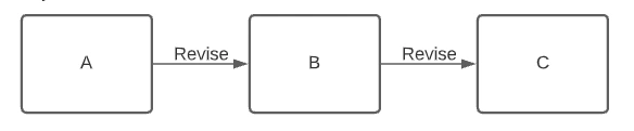

This revision format displays only the primary revision. For example, A, B and C.
The primary revision increments every time a revision is created, independently of the maturity state of the object.
This is the recommended revision scheme if you do not operate in an iterative cycle. If you release and modify this object, the next revision becomes B, then C, and so on. For example, your initial revision is A. If you modify that revision, the next revision is B, the next is C, etcetera.
  • Primary and secondary
This revision format displays a secondary revision after the primary revision in the format [Revision.#].
The primary revision increments every time a revision is created from content in a Released state. The secondary revision resets to 1. This identifies major changes.
The secondary revision increments every time a revision is created from non-released content (a state of either In Work or Frozen). It is a recommendation to allow the creation of new revisions from an In Work state if enabling secondary revisions using this revision scheme.
For example, new revisions of the In Work or Frozen maturity states have the names A.1, A.2, A.3, etc., until released. A revision of the released content has the name B.1 and follows the same revision naming rules.
The main reason to use the Primary and secondary revision scheme is for identifying design iterations.
  • Primary and secondary for 3DEXPERIENCE content with SOLIDWORKS Master
This revision format displays a secondary revision after the primary revision, before the minor revision [Revision _#.# ]. The behavior of this revision format is similar to the Primary and secondary formats. NOTE: This is a legacy scheme and not intended or recommended for use by new customers.

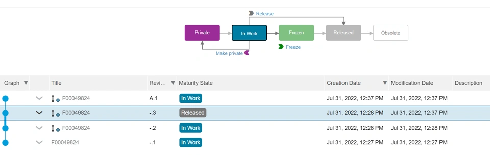

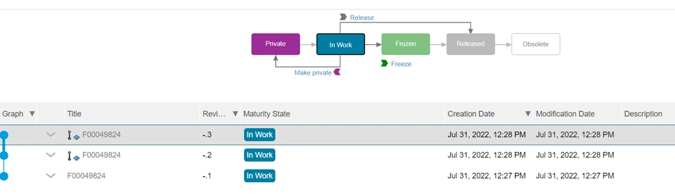

  • Rules regarding secondary revision resets

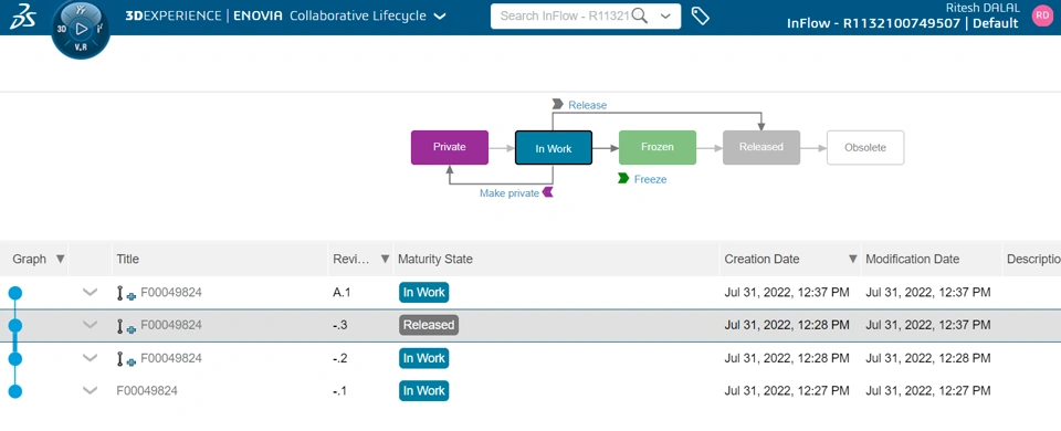

Secondary revisions reset under one condition within the 3DEXPERIENCE platform. For the secondary revision to reset, you must enable the Primary and secondary revisions option in the configuration settings of the platform. If you choose this option, an option to increment and reset secondary revisions becomes available.

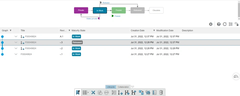

The reset of a secondary revision occurs when the object is in a Released state. If the object is in the In Work or Frozen state when creating a new revision, the secondary revision increments. If the object is in a Released state when creating a new revision, the secondary revision resets to 1.
The following image depicts an example of an object that is in the In Work state at the revision level -.1. Primary and secondary revisions are enabled in this environment. When a creating a new revision, notice how the secondary revision increments.
Notice that the primary revision remains at - and the secondary revisions increment as the object remains in a state of In Work.
After releasing the object and creating the next revision, the secondary revision resets to 1 and the primary revision changes to A as shown above.

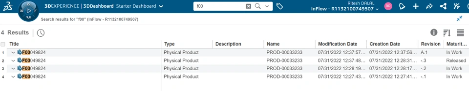

There are many ways to access revisions using a web browser, however, there are a few commonly used ways to retrieve this data. The first is to use the Search feature within the 3DEXPERIENCE platform. When performing a search using the web client, all revisions of an object appear in the search results.

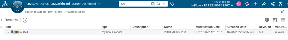

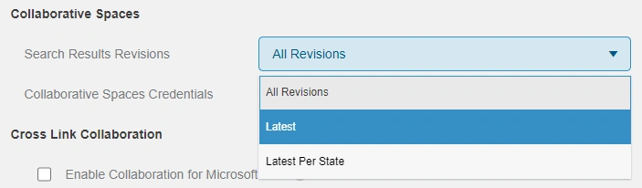

If you want the search results to display only the latest revisions, you can change the settings to allow for that.
Selecting the Latest option in the Search Options dialog box returns the limited results for revisions as shown in the following image.

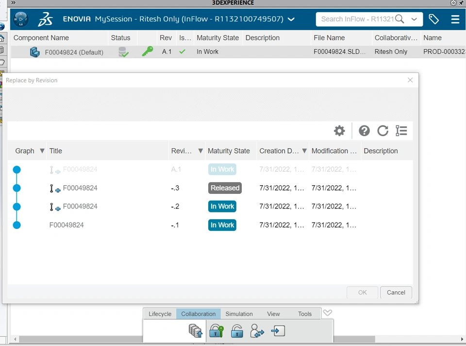

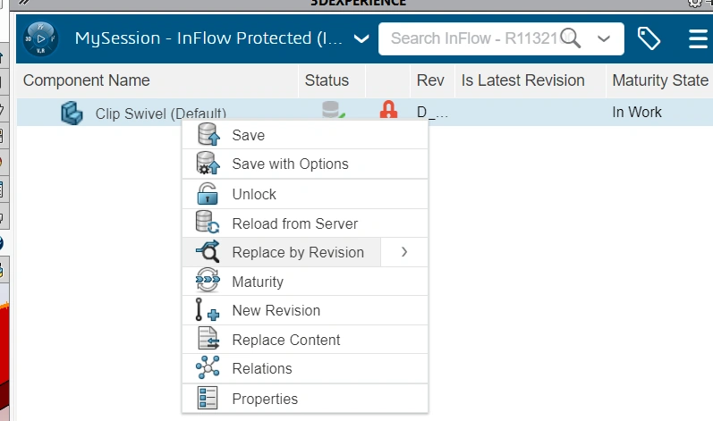

ii) SOLIDWORKS (showing one at a time and all at once)

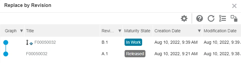

When in SOLIDWORKS, you can see all the revisions of the CAD object by clicking the Replace by Revision command.
As shown in the next image, all revisions for the object then appear in the Replace by Revision window, from which you can access them.
When in SOLIDWORKS, the Is Latest Revision column provides an indication of whether the object is the latest version or not. If a red X appears in the column, there is a newer revision of the object.

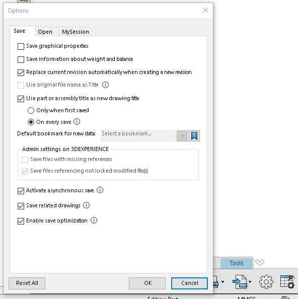

There is an option to automatically replace the current revision on save. To access this option, in the SOLIDWORKS Connector, go to Tools > Options as shown below.

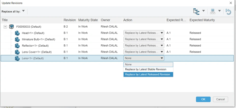

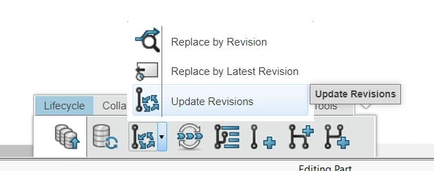

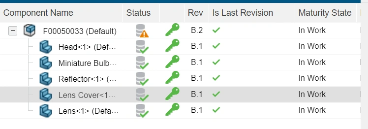

Another best practice relates to the Update Revisions feature in SOLIDWORKS.
When in an assembly that contains several children, it is a best practice to use this feature to update all the children in the assembly structure to the latest released revision.
In the following images, you can see that the main assembly is revision B.2 and all its components are B.1. Because B.1 is in the In Work state, the latest released revision is A.1. This is the latest released revision in the dialog box using this feature. When you select the Replace by Latest Released Revision option from the menu, all subcomponents revert to A.1 to keep all revisions in order.
After accomplishing the replacement, the assembly contains only the latest released components as shown below.
SOLIDWORKS will recognize if more current data exists on the Platform. This includes newer revisions or changes to an existing revision. When opening old revisions, a message may be displayed indicating a newer revision exists on 3DEXPERIENCE with the option to update the revisions.

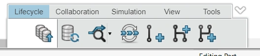

When using the SOLIDWORKS application, there is a lifecycle option to promote the maturity state of the CAD object.

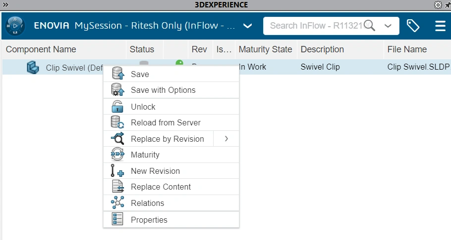

Another way to change the lifecycle of the object is to right-click the object from the task pane and then select Maturity. The same options then become available to move forward with the lifecycle of the object.

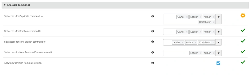

Lifecycle commands dictate what roles can use the Duplicate, Iteration, New Branch and New Revision commands. In addition, allowing a new revision from any revision is also an option in this section.
Collaboration commands dictate what roles can use the Share, Move, Change Owner, Lock and Unlock commands. Several options are available depending on the security settings that the user wants.

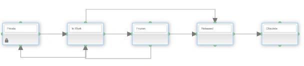

i) Maturity Graph

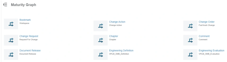

Each object has a specific maturity graph that is configurable. Specific to CAD objects, the maturity graph is for Engineering Definition.

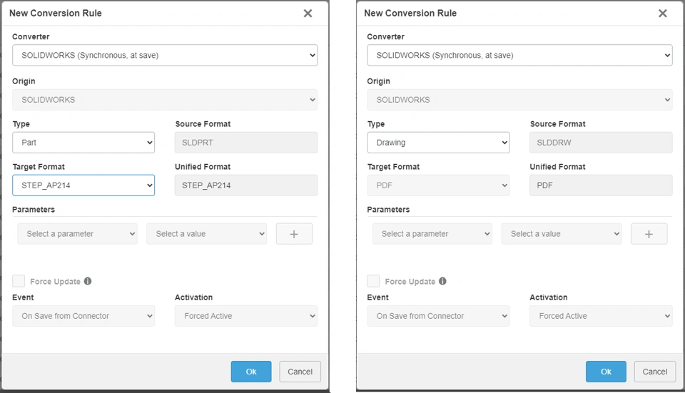

After creating derived outputs, you can access them by going to the properties of the object and then clicking the Derived Outputs icon. This displays all the derived outputs that exist for that specific object. From here, you can download any or all derived outputs for the object.

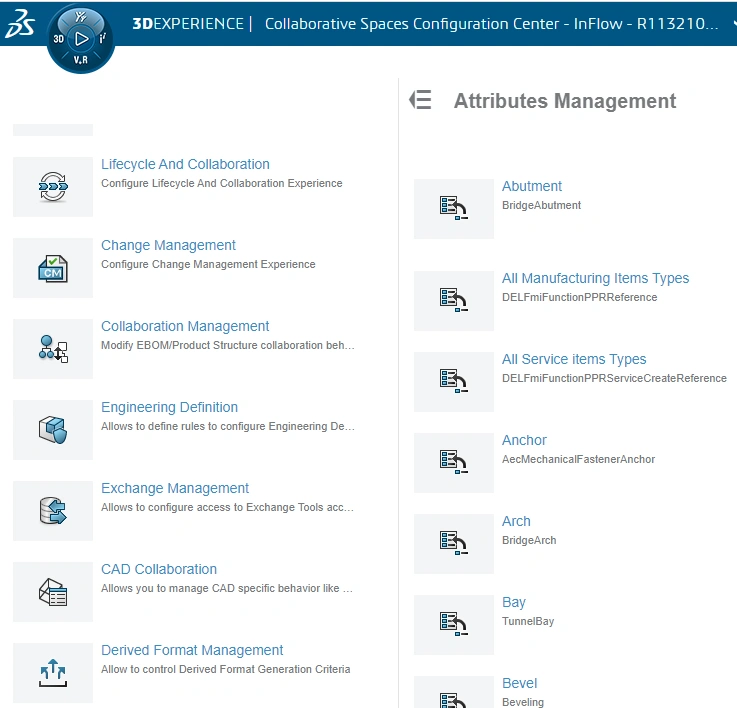

i) Configuration options
You can configure derived outputs from the Derived Format Management tool within the Collaborative Spaces Configuration Center widget.
From this section, you can set up new rules that allow for the creation of derived outputs. You have the option to create a derived output from a part or drawing to a CGR, PDF or STEP format file. A forced event creates a derived output after saving the part or drawing to the 3DEXPERIENCE platform. This is the most common configuration setting change, however, other options are also available within the Derived Output Management tool.

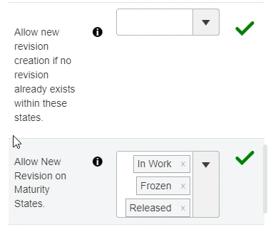

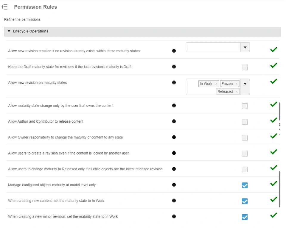

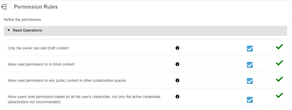

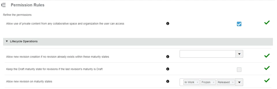

Two main roles available in a collaborative space are the Author role and the Leader role. The Author role allows users to create new content and change the maturity state of an object. The Leader role allows users to do all the things an Author can, plus release objects. Depending on the permission rules configuration, the rights for each role can vary.
The main area that affects revisions in the Permission Rules area is the Lifecycle Operations section. This section allows for configuration changes as they relate to the permission rules for a role related to revisions.
In addition to the revision permission rules, there are also permission rules that relate to collaborative spaces in the Read Operations section.
