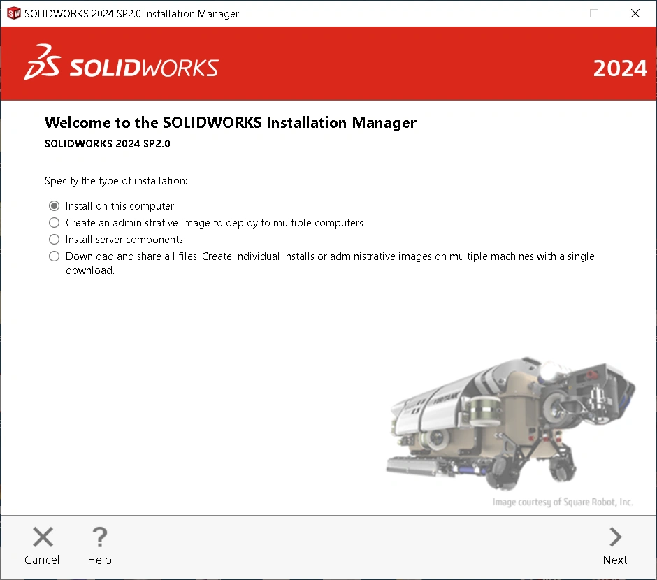

1. Begin the installation by double-clicking the SOLIDWORKS Installation Manager SolidWorksSetup.exe file.
2. Select Install on this computer, and then click Next.

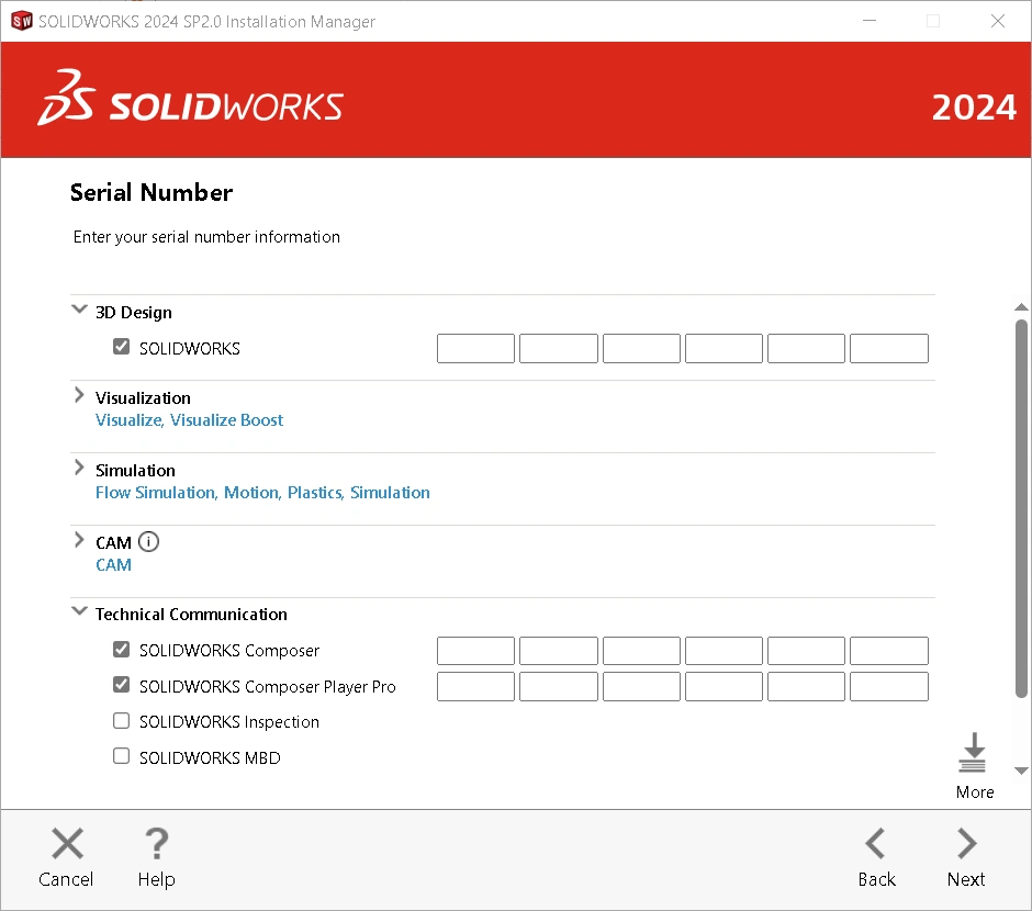

3. When prompted, enter the 24-digit serial number for SOLIDWORKS® Composer™. Standalone serial numbers begin with 9000. Network serial numbers begin with 9010. If you have a network serial number that begins with 0000, contact the SOLIDWORKS® Customer Center for a replacement serial number.
The SOLIDWORKS® Composer™ installation includes the free version of SOLIDWORKS® Composer™Player. You should only enter a serial number for SOLIDWORKS® Composer™Player Pro if you have a separate license for that product.

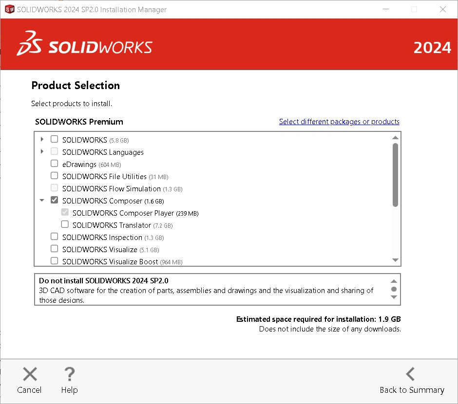

4. On the Product Selection page, specify the products that you want to install.
The SOLIDWORKS Composer Player product appears under SOLIDWORKS Composer because the Installation Manager automatically installs the application along with SOLIDWORKS® Composer™.
If the intention is to import SOLIDWORKS® files directly into SOLIDWORKS® Composer™, then the same computer requires an installation of either the SOLIDWORKS® or SOLIDWORKS® Translator software. You can install SOLIDWORKS® Translator only if SOLIDWORKS® is not already installed on the same computer as SOLIDWORKS® Composer™.
In previous versions of SOLIDWORKS® Composer™, there was an option to install the CATIA™ V5 Importer. This option was removed in SOLIDWORKS® Composer™ 2015 SP2 because the software is meant for SOLIDWORKS® customers. Customers who want to import CATIA data should use the CATIA™ Composer instead.
In addition, there is no longer a prompt to select the default SOLIDWORKS® Composer™ language during installation. You can now specify the language in the SOLIDWORKS® Composer™ Application Preferences after completing the installation. Effective with the release of SOLIDWORKS® Composer™ 2017 SP4, the following languages are available: English, French, German, Chinese (Simplified and Traditional), Japanese, Korean, and Italian.

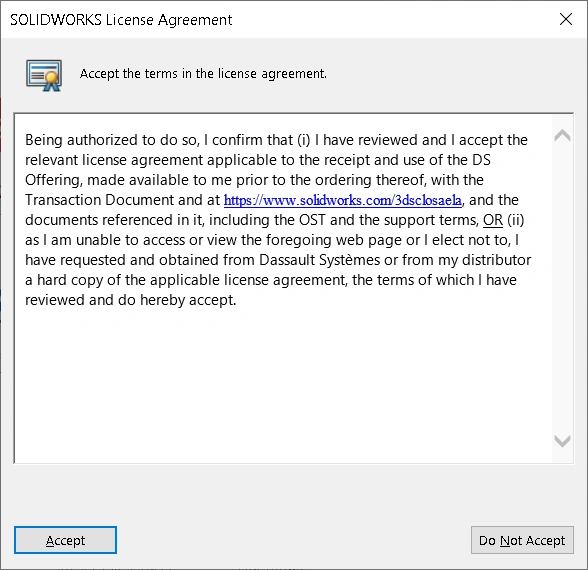

5. After selecting the products to install, select the check box to accept the terms of the SOLIDWORKS License Agreement, and then click Install Now.

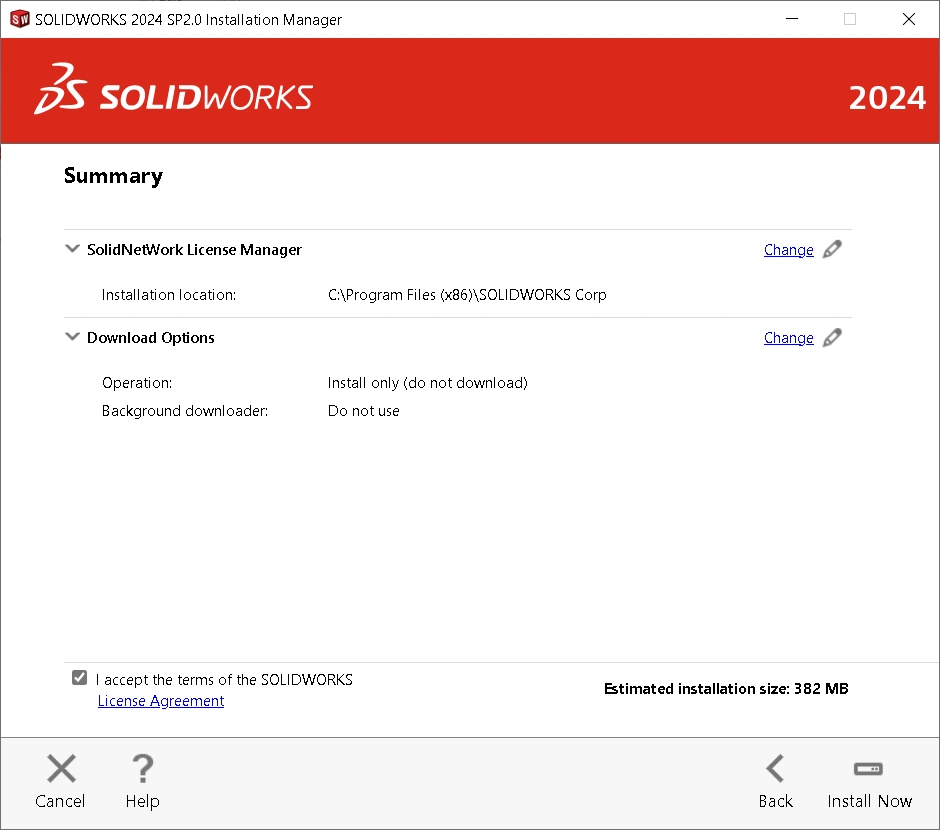

  1. Run the SOLIDWORKS Installation Manager.
  2. On the Welcome page, select the Install Server Components option and then select the Install SolidNetWork License Manager option. You should perform this action on the computer that serves as the license server.
3. When prompted, enter the SOLIDWORKS Composer network serial number, and then click Next.
4. Accept the SOLIDWORKS License Agreement and then click Install Now.

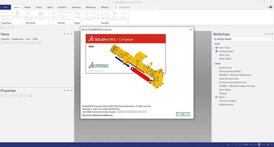

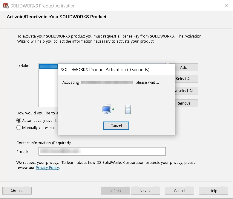

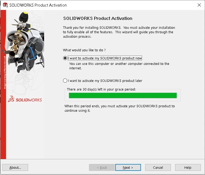

You can activate a standalone license the first time you open the SOLIDWORKS® Composer™ application. After completing the SOLIDWORKS® Composer™ installation, double-click the SOLIDWORKS Composer icon on the desktop or run the program from the Windows® Start menu. The SOLIDWORKS License Agreement will appear followed by the SOLIDWORKS Product Activation wizard.

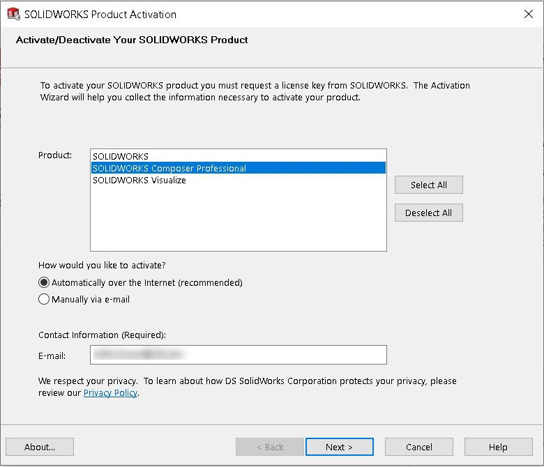

In the SOLIDWORKS Product Activation wizard, select I want to activate my SolidWorks product now, and then click Next.
The product list should include SOLIDWORKS Composer. Select the product and then click Next.
After the activation completes successfully, SOLIDWORKS® Composer™ opens automatically. From within the SOLIDWORKS® Composer™ user interface (UI), click the Help (blue question mark) icon, and then click About to confirm the serial number and software version.

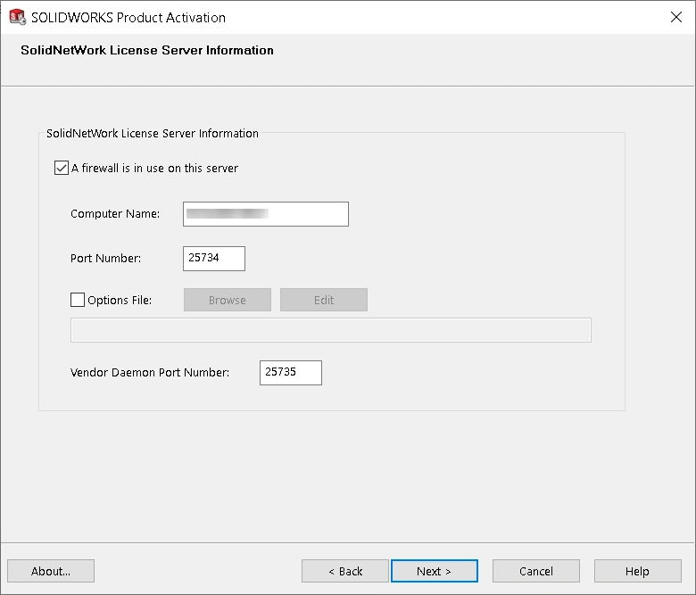

The network version of SOLIDWORKS® Composer™ requires a license server with activated licenses. After installing the SOLIDWORKS Composer SNL Manager on the server, run the SNL Manager from the Windows Start menu > SOLIDWORKS Tools [version] >SolidNetWork License Manager Server [version] A message appears that prompts you to activate the network licenses. Click Yes.
If the server uses a firewall, activate the A firewall is in use on this server option. This limits the port assignment for the license server to 25734 and 25735, unless other port numbers are specified.
Click Next
After successful activation of the network licenses, switch to the License Usage tab and use the Product menu to verify how many licenses of each type of license are available. For more information about using the SNL Manager, review the topic “Administering Licenses Using a SolidNetWork License Manager” in the SOLIDWORKS Installation and Administration Guide.

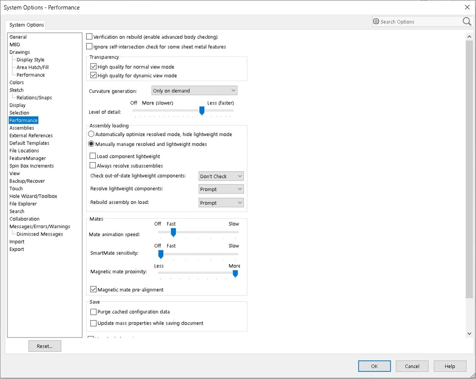

a) SOLIDWORKS® Options
If SOLIDWORKS® is installed on the same computer as SOLIDWORKS® Composer™, then you should deactivate the following SOLIDWORKS® settings before importing SOLIDWORKS® files into SOLIDWORKS® Composer™. This allows the model to load and translate completely, including custom properties or meta-properties.
  • System Options > Performance > Load component lightweight
  • System Options > Assemblies > Use Lightweight mode
  • System Options > Assemblies > Use Large Design Review mode
For SOLIDWORKS® Translator, there is no user interface available to deactivate these options. However, you can accomplish this by applying the registry files attached to the Question and Answer article QA00000111642.

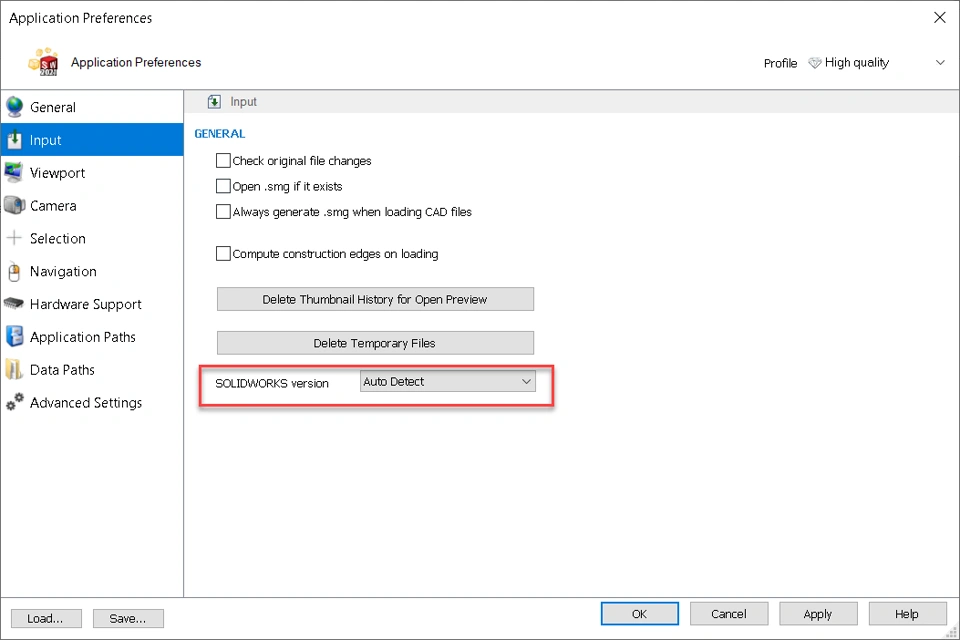

b) SOLIDWORKS® Composer™ Options

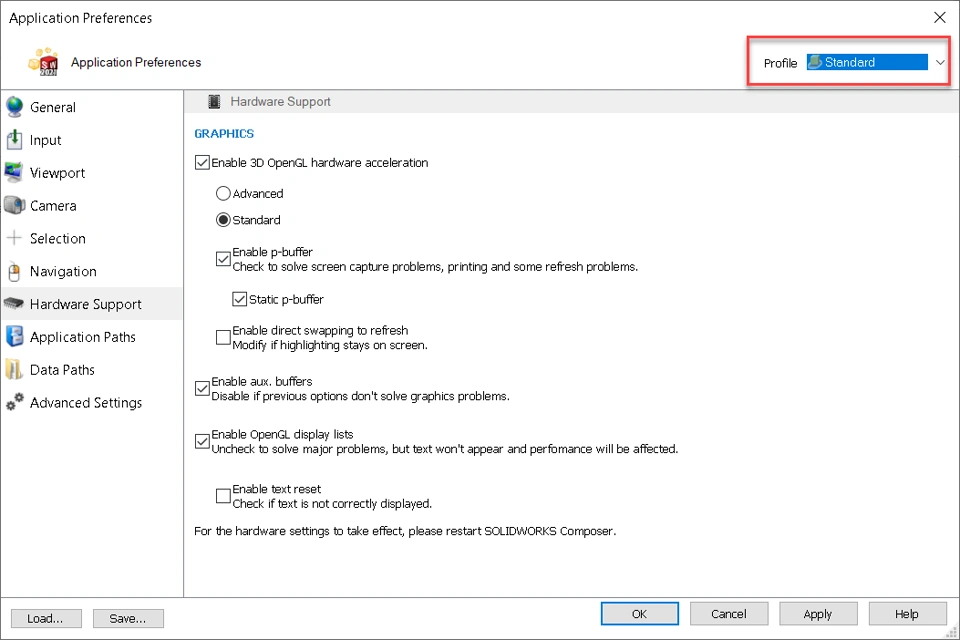

After configuring the SOLIDWORKS® (or SOLIDWORKS® Translator) options, the next step is to set the options in SOLIDWORKS® Composer™.
If SOLIDWORKS® Translator is installed, go to File > Preferences > Input > and set the SOLIDWORKS version to Auto Detect.
If SOLIDWORKS® is installed, set this option to the appropriate SOLIDWORKS version. Only the installed versions of SOLIDWORKS® should be available in the list.
Next, set the Default Document Properties (File > Properties > Default Document Properties). SOLIDWORKS® Composer™ applies these properties to all files that you import later.
Under Default Document Properties > Input, set the Import profile to SOLIDWORKS (default). If importing SOLIDWORKS® models that contain surfaces necessary for the SMG file, select the SOLIDWORKS with Surface Parts option instead.
These profiles include the recommended settings for importing and updating models from SOLIDWORKS®. In particular, the Merge file into one actor per part option allows importation of parts by file name rather than body name. This ensures that the parts can still update even if their body names change. For a more detailed explanation of the import options, see the SOLIDWORKS® Question and Answer article QA00000122226 SolidPractices: Importing SOLIDWORKS Data and Understanding the SOLIDWORKS Composer Update Functionality.
Whatever options are used to import the files, the same options should be used when updating the files as well.

a) Installation
If a SOLIDWORKS® Composer™ installation fails, then collect the installation logs that the SOLIDWORKS Installation Manager creates. Browse to the following directory and create a compressed file the contents:
C:\\Users\\[username]\\AppData\\Roaming\\SolidWorks\\Installation Logs\\[20xx SPx.x]
In this directory, browse to the Other Logs subfolder and open the latest sldIMLog file in a text editor such as Notepad. Search for the text return value 3. This often leads to an error code or message, which is useful to find more information in the SOLIDWORKS® QA. If further assistance is necessary, submit the installation logs to SOLIDWORKS® Technical Support.

3. The installed version of SOLIDWORKS® or SOLIDWORKS® Translator is older than the version of SOLIDWORKS® files that you want to import. For example, you cannot use SOLIDWORKS® Translator 2018 to import SOLIDWORKS® 2019 files. Instead, you must install either SOLIDWORKS® Translator 2019 or SOLIDWORKS® 2019. To resolve this issue:
a. Make sure that the SOLIDWORKS version is set appropriately in Application Preferences > Input.
b. If the Auto Detect option is active and it is not possible to switch to a different version, this means that SOLIDWORKS Translator is installed alongside SOLIDWORKS, and should be uninstalled.

d) Graphics
If the user experiences graphics-related problems while working on models in SOLIDWORKS® Composer™, especially if they are using a graphics card that does not support 3D OpenGL hardware acceleration, then try adjusting some of the graphics settings to see if that improves the graphics behavior. In the Application Preferences, try setting the Profile (in the upper right corner of the window) to Standard or Safe. It may be necessary to close and then restart the application for the changes to take effect.
If the problem persists, try deactivating the Enable 3D OpenGL hardware acceleration option in Application Preferences > Hardware Support to determine if the problem is graphics-related. Deactivating this option, as well as the Application Preferences > Advanced Settings > HardwareSupport.Advanced option can cause other graphics settings to become inactive. To make the inactive settings available again, reactivate the Enable 3D OpenGL hardware acceleration or HardwareSupport.Advanced options. Other settings that may help avoid graphics-related issues include, but are not limited to Disable Aux.Buffers, HardwareSupport.HighlightEffect and HardwareSupport.SilhouetteShader. For more information about each setting, click Help in the lower-right corner of the Application Preferences dialog box. It is a recommendation to try combinations of these options to determine which options work best for the user.

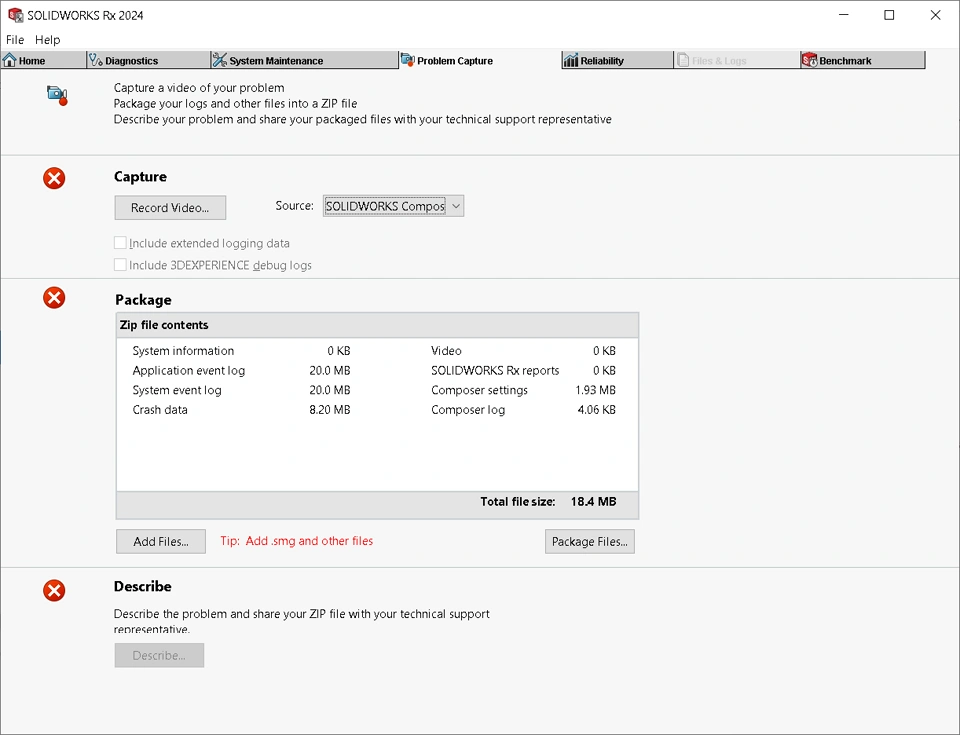

e) SOLIDWORKS RX:
Starting from version 2020, the Installation Manager installs SOLIDWORKS Rx with SOLIDWORKS® Composer™.
You can open SOLIDWORKS Rx from the SOLIDWORKS Composer Help menu or from the Windows Start menu >SOLIDWORKS Tools [version]> SOLIDWORKS Rx [version].
The Problem Capture tab in SOLIDWORKS Rx collects files, videos, and settings for SOLIDWORKS® Composer™. In the Capture section, choose SOLIDWORKS Composer to capture the SOLIDWORKS Composer screen. The capture includes the logs and settings.
