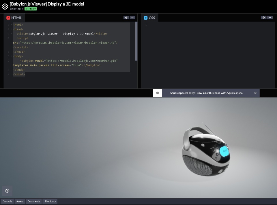

Here is an example of less than 10 lines of code of only two steps.
  1. Call for a viewer;
  2. Feed the viewer with a glb model.
 That's it! https://codepen.io/BabylonJS/pen/QxzBPd/
 Babylon.js Viewer - Display a 3D model
You can easily copy and paste these lines to your webpages to showcase your own models.
