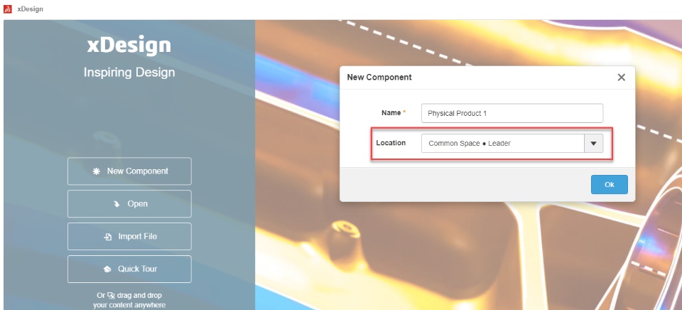

How do I choose which Collaborative Space to save my content within my application such as xDesign?
When you launch the xDesign Dashboard Application and you choose the 'New Component' or 'Import File' button, you see a dialog where you choose which collaborative space you would like to save the content you create.
New Component
'Location' is your [Collaborative Space] and [Role] you would like to use when you create and save content.

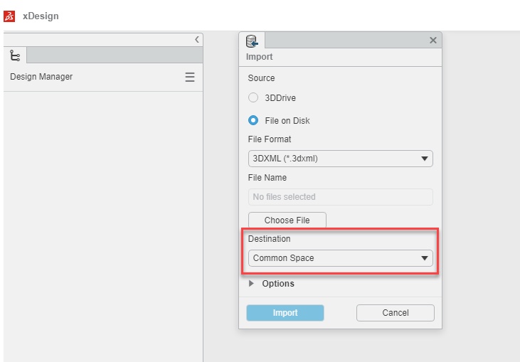

Import File
'Destination' is the [Collaborative Space] where you would like to save the imported file.
