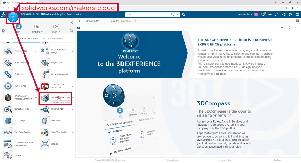

1. Log into the MAKERS Cloud.
MAKERS Cloud: <strong><a data-type="external" href="https://eu1-makers-ifwe.3dexperience.3ds.com/" desc="https://eu1-makers-ifwe.3dexperience.3ds.com" url="https://eu1-makers-ifwe.3dexperience.3ds.com" target="_blank" rel="nofollow">https://eu1-makers-ifwe.3dexperience.3ds.com</a></strong> (Bookmark it!)
2. In the upper left corner, click the Compass.
3. Click the Shop Floor Machining app. It is one of the apps in NC Shop Floor Programmer. If you don't find the Shop Floor Machining app, see Missing NC Shop Floor Programmer.

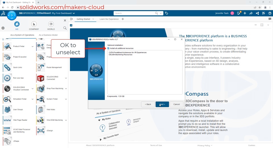

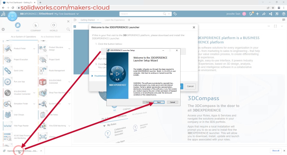

4. Download and install the 3DEXPERIENCE Launcher if prompted.
5. Follow the prompts to complete the installation of NC Shop Floor Programmer. This will install Shop Floor Machining and other apps.
Tip: Opt out of installing 'CATIA Predefined Ambiences for VR Experiences' and 'DELMIA Machining Resources'. They're not specific to NC Shop Floor Programmer.
