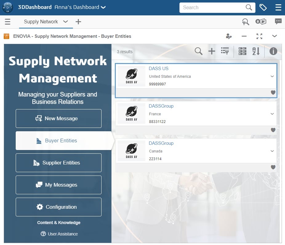

Manage your company’s Buyer Entities
Why
Improve Supply Network definition by introducing multiple Buyer entities and relationships between the Buyers and their Suppliers
How
Previously, Supply Network Management consisted of one host company that includes a network of suppliers.
Now, Supply Network Management consists of multiple buyer entities and the relationships that they have with their suppliers.

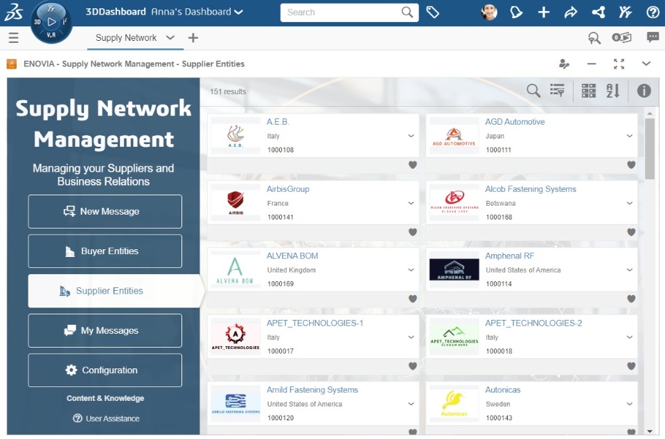

The ‘Supply Network Management’ Home Page has been updated with new sections:

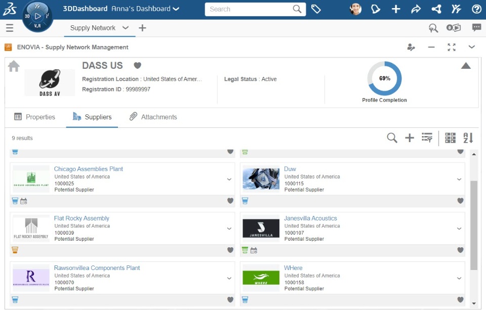

  • Buyer Entities, in which you can
    • List, create and manage all your Buyer entities
    • Create supplier entities under selected buyer
  • Supplier Entities, replaces My Network section, in which you can list, and manage all your supplier entities.

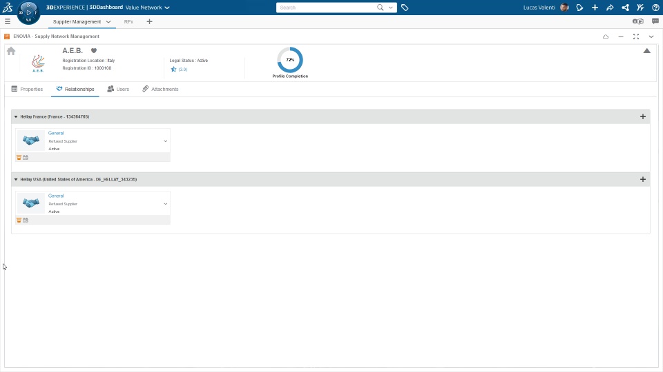

Group Relationships by Buyer Entities in Supplier’s Relationships Tab
Why
Improve Suppliers Relationships view by listing all buyers associated with the selected supplier.
How
All Relationships (General and Specialization) between the Supplier entity and Buyer entities are now listed in the Supplier’s Relationships tab, organized by Buyer entities.
You can create a new Specialization Relationship, in the Relationships tab.
