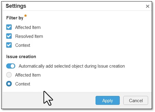

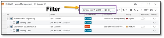

⚡Issue Management: New Setting to create Issue with Affected Item or Context
Why
Enhance productivity during the Issue creation
How
A new setting “Issue creation” is available for you to automatically add a selected object (from the Filter) to the new issue.
The setting determines if this selected object is added to the new issue as:
-Affected Item
Or
-Context

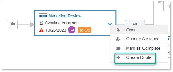

Sub Route creation for assignees to delegate their tasks
Why
Improve the delegation of your tasks to others through sub routes defined from your task
How
Once the route is promoted, you as a task assignee, have now the ability to create a sub route from the task itself
You can use the sub route to delegate your tasks to others in the organization
Note:
•Tasks cannot be completed if the tasks in the associated sub route are not completed.
•In the Grid view, a new column named “Sub Route Approval Status” is displayed to provide sub-route status.
•In the Graph view, a new tile is added that displays the status of the associated sub-route.
