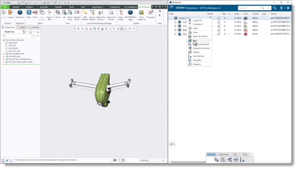

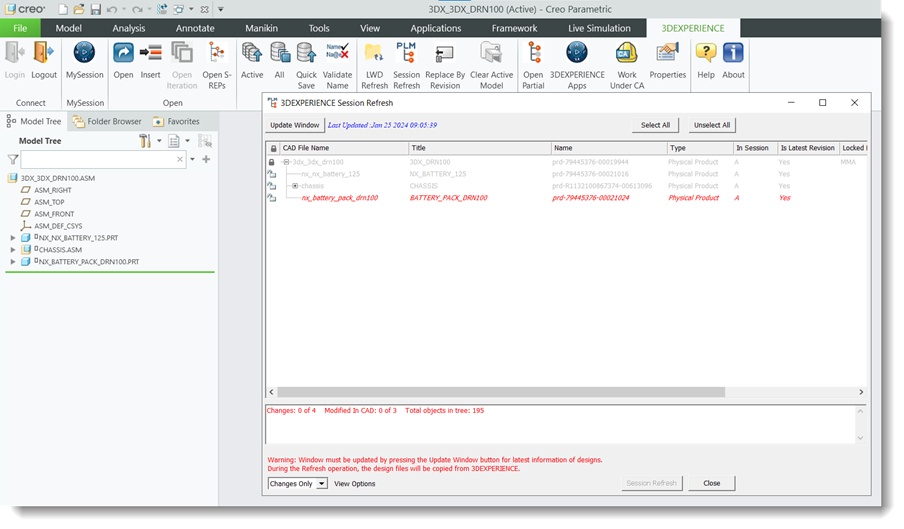

Update Latest Design in a MultiCAD Structure
Why
Refresh non-native designs in the CAD session to enhance MultiCAD development processes
How
Perform a “Session Refresh” on MultiCAD structures containing non-native parts, the modified non-native parts will be visible in red
The user selects the highlighted parts and performs “Session Refresh” to update them to the latest revision

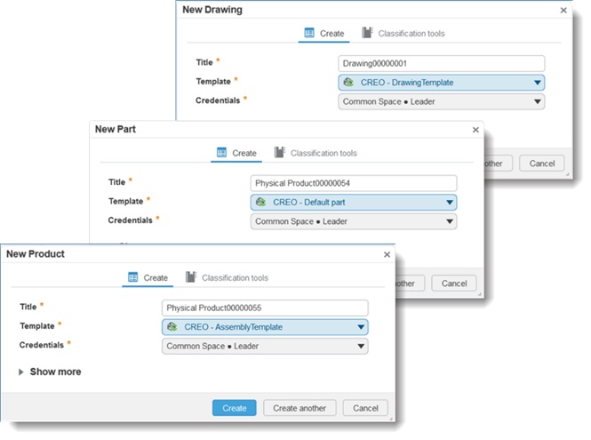

Creo Parametric Template Support
Why
Create new designs based on pre-defined part, assembly and drawing templates to streamline the process and improve standardization of design efforts
How
You can now initiate new CAD designs with pre-defined Creo Parametric design templates for parts, assembly and drawings
NOTE:  This function will not allow the user to create Physical Product
 objects of the following types:
  • Creo Parametric Part Family Tables
  • Assembly Family tables

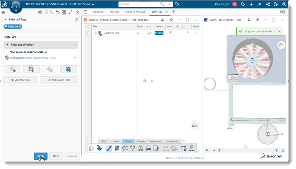

Open MultiCAD designs with Filters
Why
Open filtered MultiCAD product structure into a Creo Parametric CAD session providing the designer with the correct design context
How
Filtered MultiCAD designs can be opened into a CAD design session adhering to the filtered status of both native and non-native components within the structure

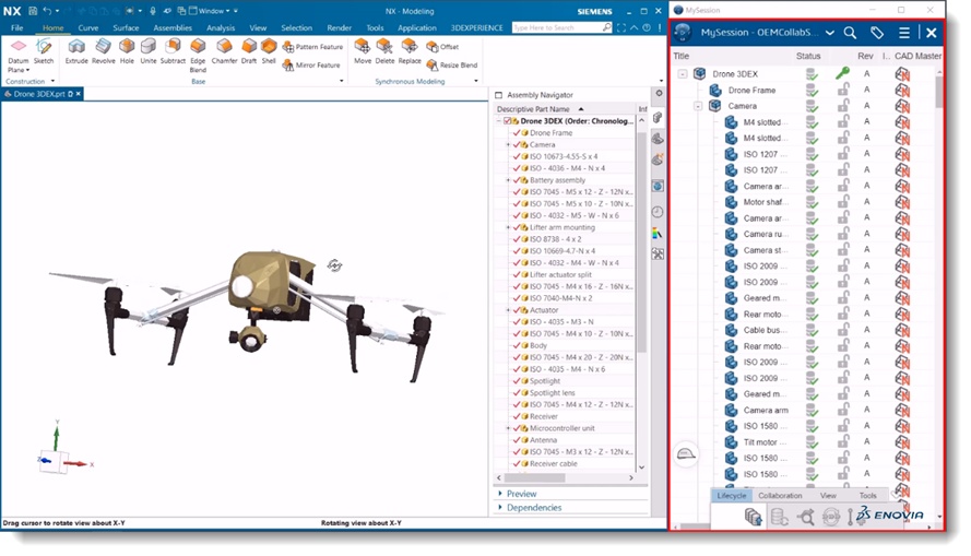

MySession Performance Enhancement
Why
The MySession window opens independently of the CAD session providing additional time to design while MySession is loading
How
When opening a new design into session, you no longer have to wait for the MySession window to load before you can begin working with the CAD capabilities of the CAD system
A great deal of time is saved when loading large assemblies that require a lot of time to load the MySession window

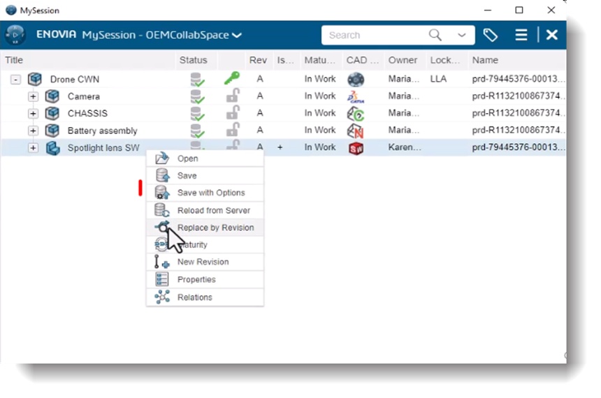

Update Revision Data on MultiCAD Structure
Why
Replace existing non-native component revisions with other revisions to keep your design up to date in a MultiCAD product structure
How
You can now update the revisions of non-native components in the NX CAD structure
Users do not have to clear the current working directory because the system is now aware of the status of non-native parts in the cache
They can download required parts at any time so they do not have to download the entire structure each time for a change as was the case in the prior release.
