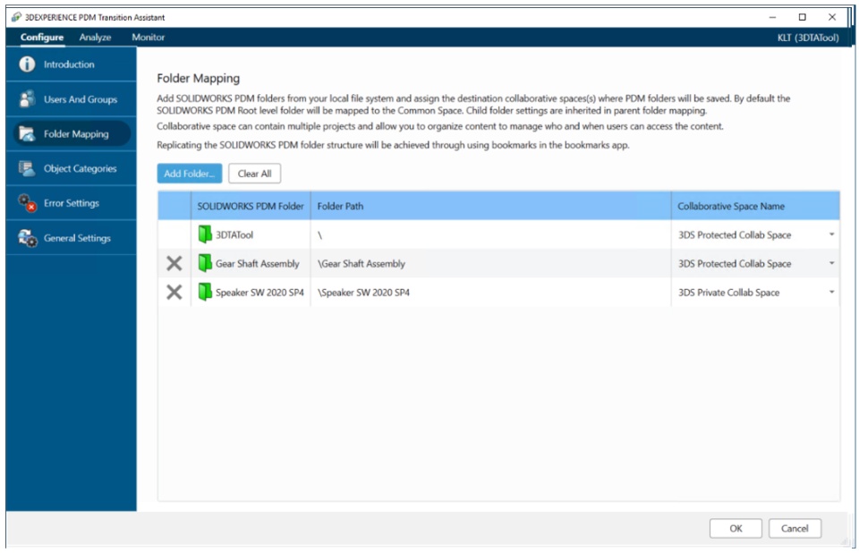

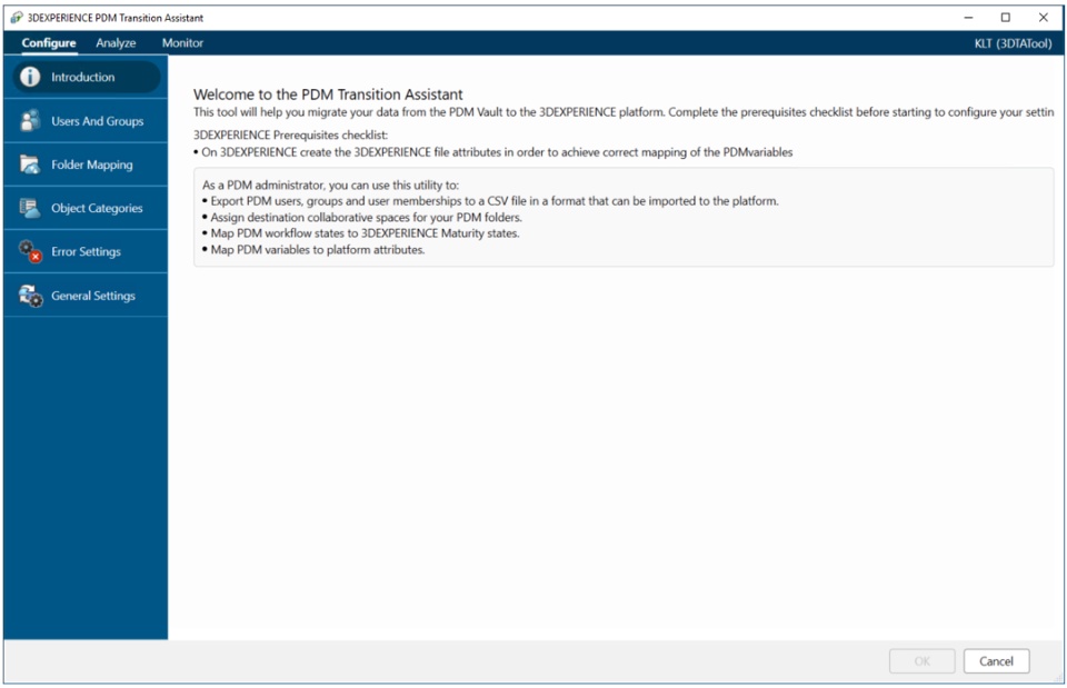

  • This role provides administrative tools and migration environment to:
  • Configure - Export and import users and groups, Provide Mapping between PDM folders and 3D Spaces. Provide mapping of attributes, workflows, maturity states and revisions from PDM to the platform

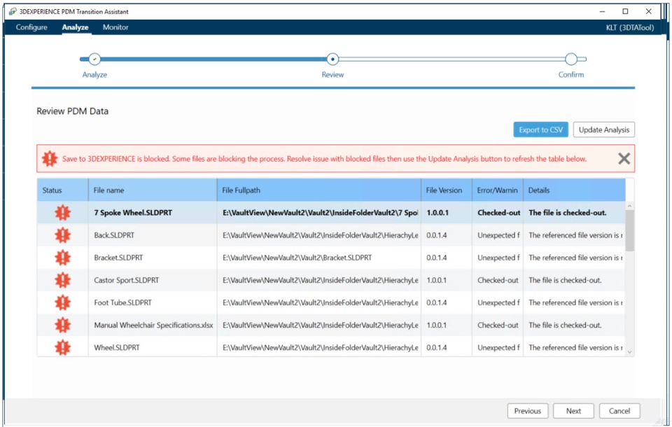

  • Analyze – Create and export file packages, analyze, and correct errors and confirm export validity within a sandbox environment
  • Monitor – Continuously monitor progress of import and export cycles to maintain data integrity once analysis validates the migration process
