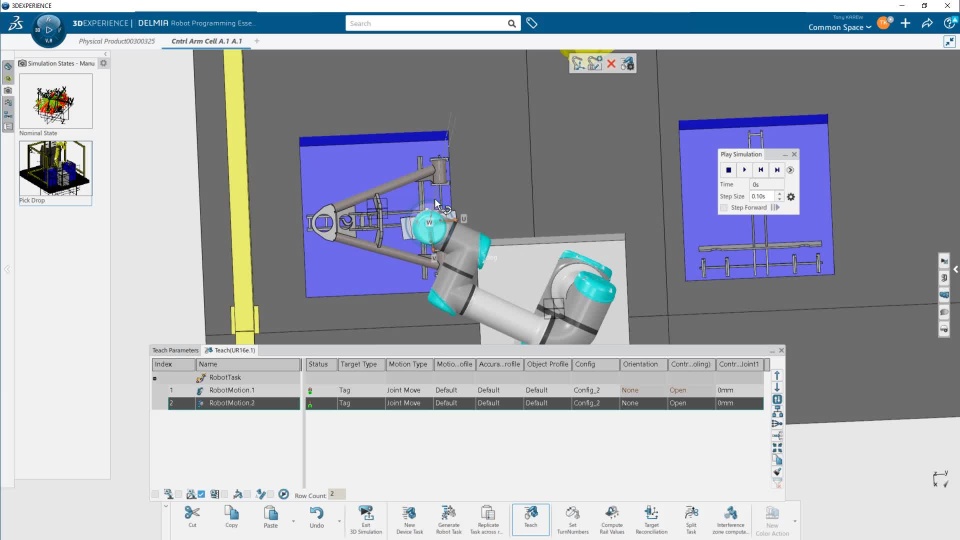

Lesson 3A - Teaching a Material Handling Robot
This video will show you how to Use Set Tool to mount the end of arm tooling. Also how to create a Robot Task, and how to program the gripper as an Aux Axis. You will also operate the Teach interface and use Grab and Release commands.​​​​​​​
